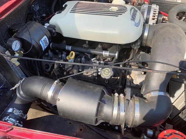

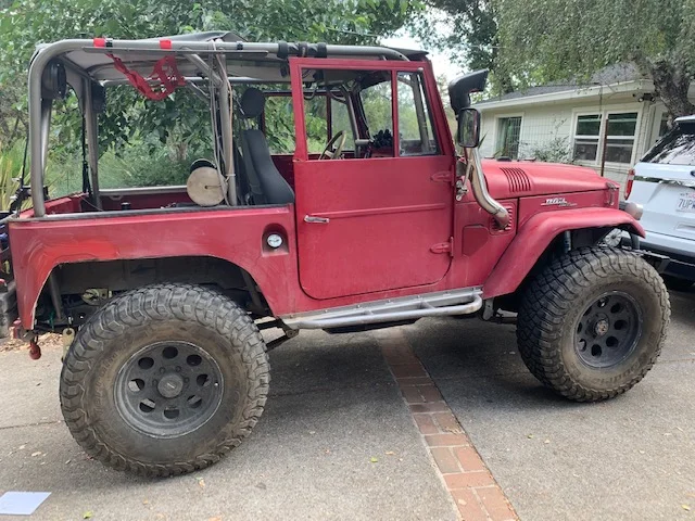

here's what I ended up with. Seemed to work fine. I think it's the K&N. Ended up getting a custom snorkel pipe built out of SS exhaust pipe.
lets see the snokel pipe
I took it to an exhaust shop to have it bent and welded, figuring they'd do nice welds. They did crappy welds. But ... it works.
