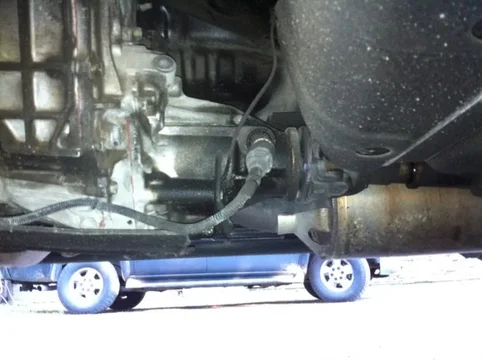

Going to get looking at things tomorrow....But a stupid question in the mean time. I looked and am assuming the '93 does not have a speedo cable....Right? I looked and can not find anything like a cable coming from the t-case.....
This is too funny. Just took one of my nephews into town for work, and now my speedo cable is acting up!
Your 93 will definitely have the cable running into the side of the transfer case at the back. It does not look like a nut, it is a ribbed collar that you are looking for. If you need, I will take some pics for you. Looks like I will be spending some time under there today...
A pic would be great. I have the day off today and am going to take a better look for it!
Hey Socal. This pic is taken from the drivers side of my '94. Middle of the truck. The big black thing you see is the gas tank. In the middle of the pic you can see the round metal collar with the black speedo cable coming out of the transfer case, and the rear drive shaft coming out behind that.
It is exactly the same on my '90 rhd HDJ81...
Hope this helps.
Doug

So Woods....I honestly do not have that cable. Where your cable goes into the t-case i have the VSS connected to wires. I have read that the piece the the VSS screws into has plastic gears which may go bad....My next task is to open that up and take a look. Does anyone know if by opening up that area will i also bo draining the t-case oil?
SoCal, you are right.
On my 90 HDJ it comes out in the same spot and is an actual flexible metal cable with a small sensor between it and the T-Case.
On the '94 it looks like a small gear box with the VSS going into it.
I would bet that you can take off the VSS and unscrew the adaptor that goes into the T-Case without any worry, but, I have already lead you astray once...
FWIW, on the HDJ I just unscrew it, pull out the speedo cable, lube it up and push it back in, being careful to seat it back into the speedo by giving it a little turn. I just did it today. When I take it out on the HDJ there is no loss of fluid.
