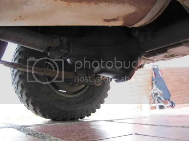

So, How can I easily tell if I've got a DANA 60 ?
(sorry guys, it's my first LC and on this small island there is just not a big 4x4 culture going on.....) :whoops:
Rear Brake Shoe
Oh, It doesn't have a heater and it came with this dizzy... see pic's. Carb is non USA?!
Hi, then is not a made in Venezuela Land Cruiser.

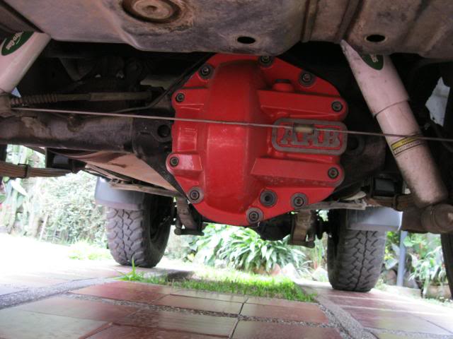

Here are some pics of my FZJ70 rear DANA 60 axle, compare...
This is not the original diff cover!
About 3F non-USA carb, pretty sure that is not USA version since 3F is inyected in USA, from the photos is about the same that have FJ62 and FJ70 here.

The photos provided clearly show a non-Toyota axle.
The K082 part only refers to the ratio and ring and pinion diameter.
~John

Just took a good look and it's for sure not a DANA 60. My axle housing is nice and round. See Pic
Name that model...
yeah, I thought so.
So I've seen that Plant A11 is Japan. Then we can safely presume it was not build in Venuzuela with Toyota parts.
