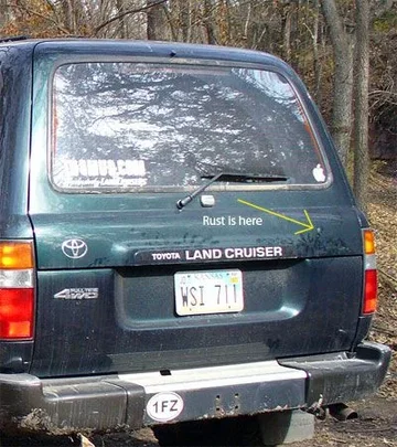

Help on fixing hatch surface rust

I've got a spot on my tailgate I want to fix but I don't trust my skills to make it a _decent_ fix. I tried fixing some rust around a nutsert on the roof and ended up with noticeable ridges where I sprayed the primer, paint, and clear in successive layers. I don't think I trust myself to get the tailgate done right (or just decent).
Can someone lend me a guiding hand, perhaps at the wrenching weekend?
I don't really care how nice it is, I just want the rust gone and have it painted over. Doesn't matter if body filler is used to fill in the spot where the rust was (its surface rust, not a hole, I know better than to fill a hold with bondo).
I already have Toyota 6M1 green paint in a spray can so I can match the paint. Also have some spray can clear, but I need to get some black primer since the grey primer lightened the basecoat too much.
Thanks!

that list looks pretty comeplete...when you repaired the finish last time did you rub/buff the patch once the paint had cured?....sometimes those imperfections can be rubbed out and blended in...just curious
My main problem was the paint/primer gathering at the edges of the masking tape so I was left with ridges. I did try to feather the primer but it didn't work very well, I also tried buffing the paint once done but that couldn't take out the ridge. I gave up after that since I am going to have the area the roof rack occupied covered with line-x once I get around to it.
Is the rust like what is shown in this picture? If it is, you need to read this thread https://forum.ih8mud.com/showthread.php?t=17823&highlight=tailgate+rust

I'm not really expecting great results, just something a bit better than what I did before.

Would I really need to remove the back window? I don't think the rust goes that far up.

There isn't any rust around the window right now, its just that little spot at the end of the yellow arrow.
I have dial up, your picture hadn't downloaded and I read right past it. Thats a peice of cake to fix. Block sand it, wire wheel it, prime it a few times and paint it.
CC
