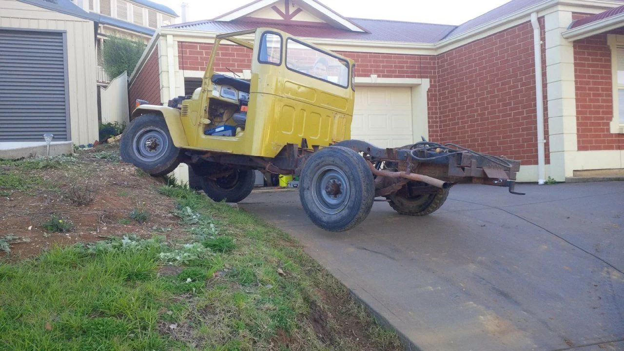

I need some collective help here guys as to the best way to paint my cruiser. I have a HJ47 ute that has minimal rust but the paint is the original and is in the most part, just in need of a good paint job. so far I have been busy taking my panels back to bare metal to get them ready for priming.

I'll try to post up some more pictures sometime, this one's the only one I've got at the moment (not really relevant).
