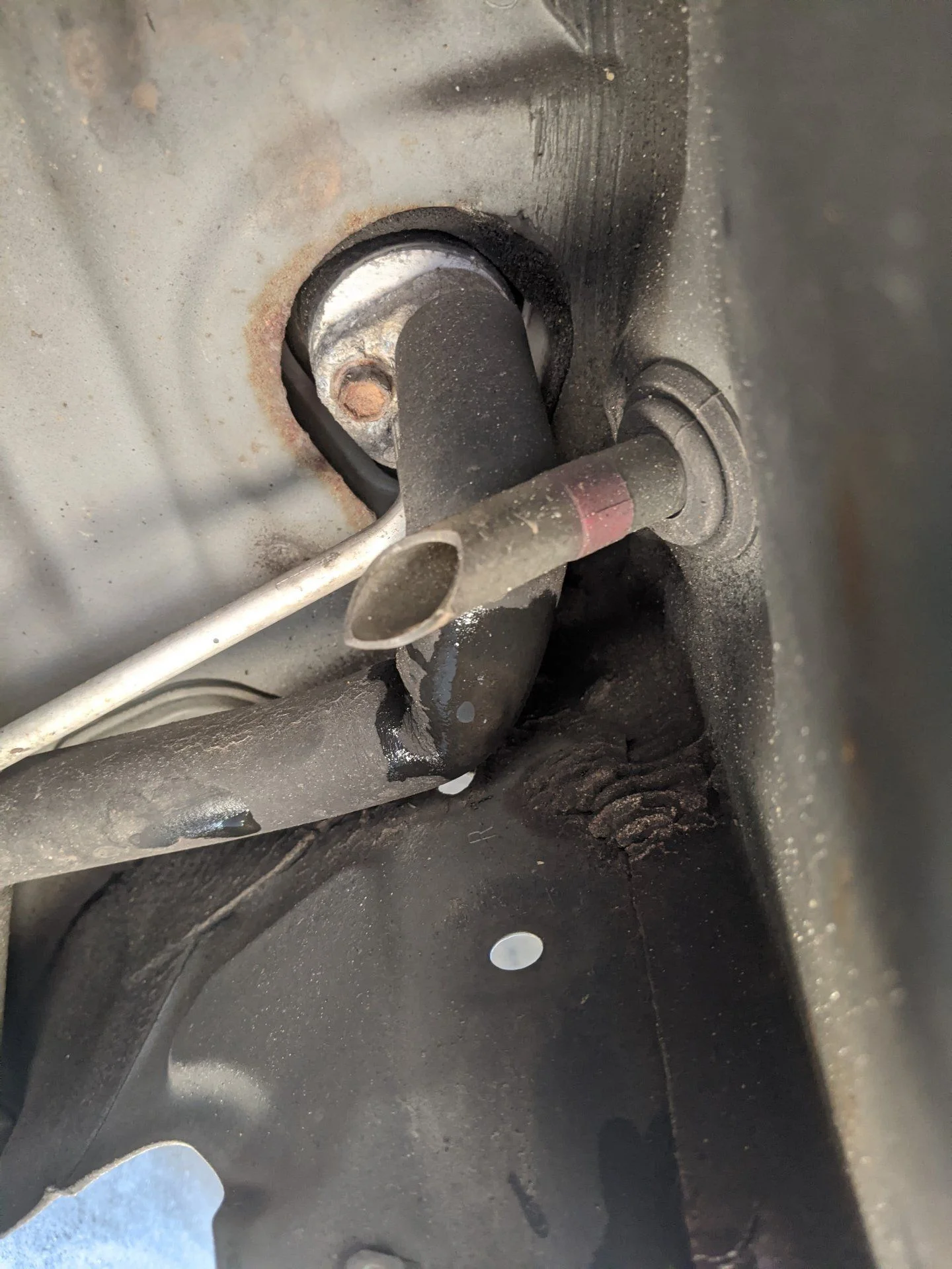

Can anyone help me identify where this drip is coming from? Just got home from a trip and noticed a small puddle, coming from this foam-covered (pipe?) behind the rear passenger tire.
Thank you!
no problem. run the rear ac to verify. preferably on a humid day. You should see water coming out at the lower rubber floppy pipe, what you are seeing is the low side line going into the rear evaporator. that line is insulated because it transfers very cold refrigerant to the rear evaporator. it will sweat like a cold beer on a hot day. most of the water should be coming out of that rubber drain for the evaporator box. If it doesn't then clear that drain out.
