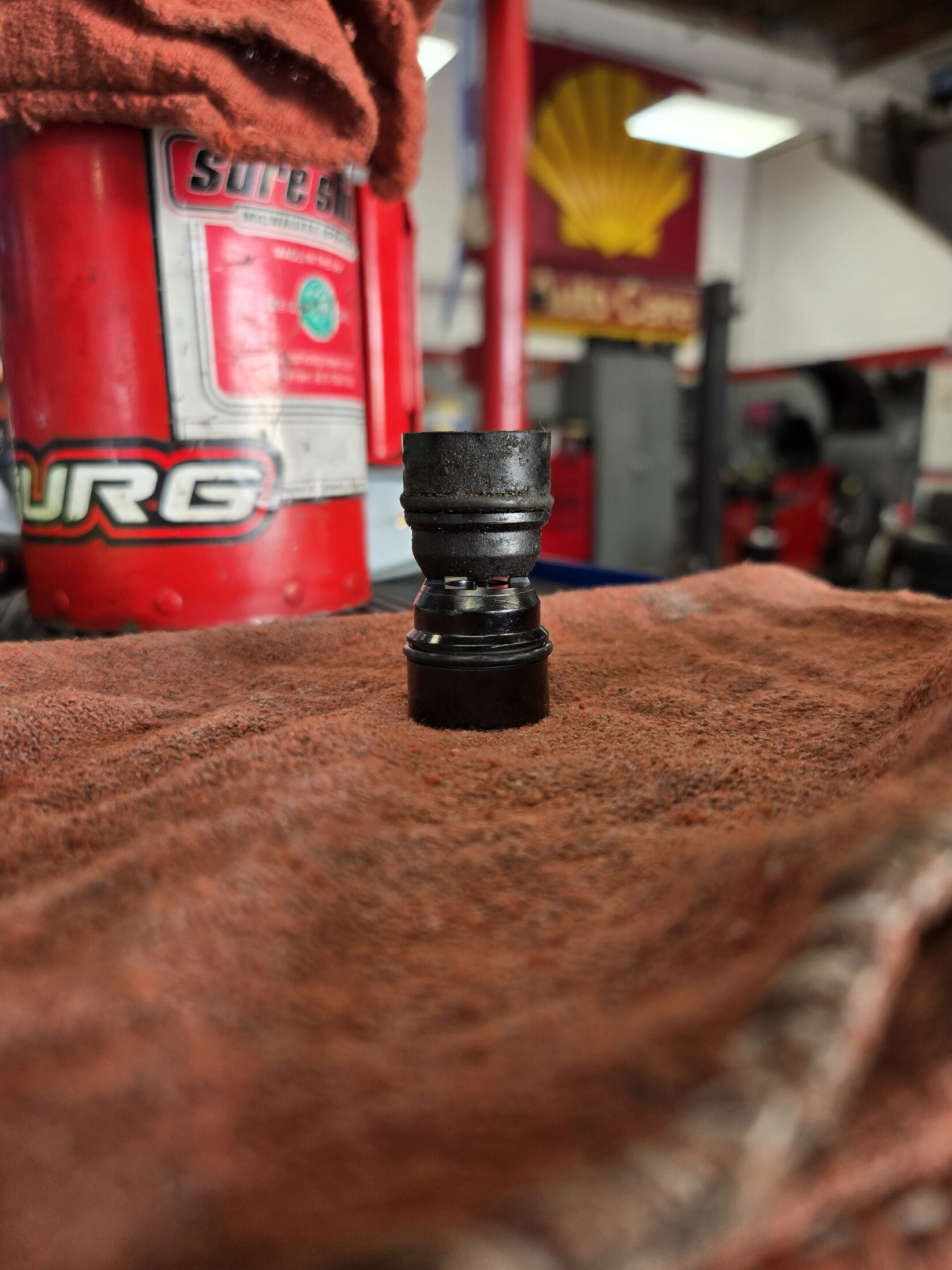

After 409k miles, I am finally going through and servicing my fuel system. However, two of the plastic injector cups have cracks in them. I can't find replacements anywhere! Does anyone have a lead?
22RE cups look suspiciously similar. Are these interchangeable?
Thanks Voorland, but I am not looking for the seals. I am looking for the hard plastic cups that the injectors nest into. Here's the 22RE equivalent of what I am talking about: 22RT-E Fuel Injector Cup Set of 2 Cups & 2 O-Rings OEM Toyota P/N: 90561-10004 / 90301-19006 - https://www.lceperformance.com/22RT-E-Fuel-Injector-Cup-Set-of-2-Cups-2-O-Rings-p/1065022.htm

Just to update this thread since I couldn't find a clear answer anywhere. The injector cups for the 3FE are still available from Toyota dealers. The part number is 90561-10004.
They do not come with o rings, you need to buy those separately.
