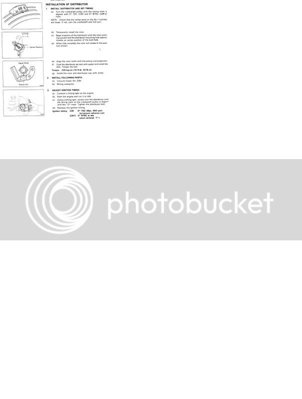

I THINK that you install the distributor with the rotor pointing at cylinder one and about halfway through the adjustment lobe is a good place to start. The dot on the lower sprocket should be in line with the keyway on the crank, which should be on the bottom of the crank. Then the dot on the upper sprocket should be on the top or just to the left (ie 11 oclock or just not quite 12 oclock). Line up the bright or differently colored chain links with the dots. That should get you started. If it's like mine and you have a different year head than block then you might have to mix and match parts as I had to use an 89-95 upper sprocket, and an older chain, guides, lower sprocket, etc. Im telling you all this out of memory so if it's wrong someone will chime in but I'm pretty sure that I've got it all right.
I don't have time to futz with this pic, so you may have to save it and resize it
hope it helps
