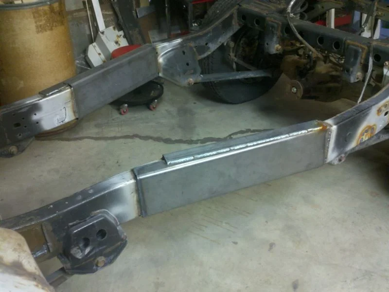

my goal was to shorten the frame by about 10 inches in the middle. obviously i dont want to cut the frame where the suspension attaches, so i had to cut the frame where it tapered. this, obviously, makes for some dimensional challenges. i was able to figure out a spot where i could cut the frame and the shortened pieces would intersect close enough that i could temporarily weld the frame back together.
i tried to come up with a way of filling the gap to give me some strength in the frame. nothing made a whole lot of sense, and i didnt want it to look goofy. i decided the right thing to do was to just trim down the frame and box in what i had with a new piece of steel. you can see them above, more images coming.
what i did was have a pair of 3/16" channels bent up to box in the frame the same way toyota did it with the original 1/8" frame. i figured out an angle that would cover up the sections that had to be cut and then i drew up a cut line to trim the frame again.

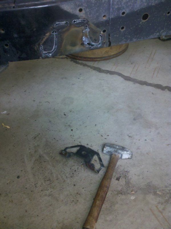

when it was all said and done, i shortened the frame about 10.5". not bad for the first time frame cuts.
my advice to those who do this, just be sure you measure more times than you think you need. i measured lengthwise on each side and then to set points across the frame. it took about an hour of measuring and adjusting to get it right. and when i say right, i was able to match it exactly.
I gotta be honest, when I saw those first pics I was really having trouble grasping how you were going to make that work. But, it turned out great. Good job.
I agree good job! I still haven't got around to cutting my 80 frame so always interested in seeing what others are doing.
Any reason you didn't fish plate it?
thanks gents!
i didnt fish plate mostly because i had never heard of that before... :-D
after banging on it trying to figure out a way to do it, i just figured i might as well copy what toyota did on the frame originally. if you look at the stock frame, it is two c-channels that are just welded together along the top and bottom seam/overlap. so, on the capped channel, i welded along the top/bottom edges to attach to the original frame steel, and then the cover piece is welded on all edges to both the original frame and the new steel. the vertical welds are not on the same plane, so that should help keep things strong. and since the new frame sections are 3/16", 50% thicker than the original frame steel, they should be plenty strong enough. i think i paid ~$80 for the for 8' of bent channels, which seemed like stupid-cheap to just fix the problem, and it KINDA looks like it is supposed to be that way...
in my short 'what is fish plating' search, it looks like something you would do to thicken/reinforce/stiffen an existing frame. should i be scabbing what i already have? it seems like that would be overkill considering what i added, and that i will be building a truck that came off of a frame that wasnt nearly this stout.... whats the story on fish plating?
Fish plating is usually done to prevent a vertical shear, since your frame was welded top to bottom it provides a "seam" which can weaken and eventually fail.
I would throw some simple diamond fish plates on there to add some strength to the frame. Even if it might not be necessary it adds some peace of mind.
ah, i see. well, that would be an easy thing to add. i will put it on the short list. i am working on the body mounts now, so i will need to plate it before i burn in any new mounts on the back side of the frame.
thanks for the suggestions, i'd feel real dumb busting my frame if it can be prevented with an evening on the welder and $5 worth of scrap steel!
Yup, I would fish plate it. But I like how you did the cut and joined it back together, have not seen it done exactly like this yet. IMHO the rear link mount right behind where you made your cut is the best place to cut and shorten it. However, you have to remove the link bracket (obviously) and not so sure there is room to remove a full 10.5" in that location.
