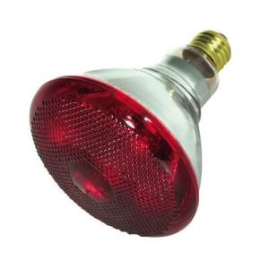

Well if you want to know about my redneck setup I have two brooder lamp assemblies hanging from chains to adjust the height (and heat) but usually only need one.

So to answer the original question, yes the lamps are inside the booth and on when painting and yes I wear a respirator. I adjust the heat on the parts by using a cheap magnetic thermometer and changing the height of the lamps with the chain. As you are in an uninsulated and unheated area I would build your booth and try it out with one lamp to start as you can vary lamp wattage and colour as well to get more or less heat as needed. Depending on your garage construction putting up a couple sheets of plywood and a couple of cheap bathroom exhaust fans ducted outside with dryer ducting is likely not going to be a expensive or time consuming project.
Just in case you do not know what I mean by "brooder lamp":
