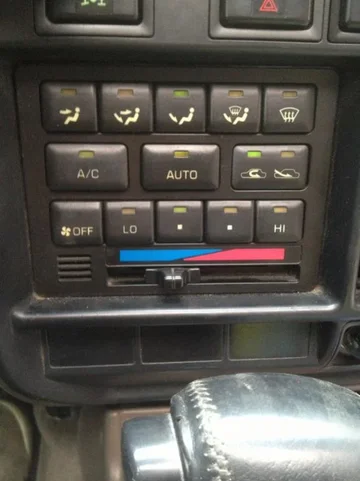

Can anyone help with my heater problem?
Push the fan control buttons and nothing happens.
Push the AUTO button and the fan comes on full and now won't shut off.
I cannot toggle the auto button to off now it is stuck on.
I cannot toggle the vent/cabin button, stuck on vent.
Please help, winter is comming in northern ontario and this needs to work:frown:
New climate control module?

Clean your control module
Is the control module a part of the circuit or is it the dash part with all the buttons? How would I clean this part, just remove and spay with contact cleaner? Any schematics would really help.
If your controls look like this then there's an actual control module it's under driver side dash above gas pedal has 2 connectors on it 2 bolts hold it down take this out pull case open and slide circuit board out. you will notice corrosion on board. take a tooth brush and circuit broad cleaner ( I bought mine $14 at radio shack) spray, lightly scrub all areas of board even all contacts do this till u have all or most corrosion off spray down let dry then install should work it fixed mine I had nothing before I cleaned mine.
Is on the right side of the car, a green module? Mine is clean, but I have the same problem, what else can i try?
