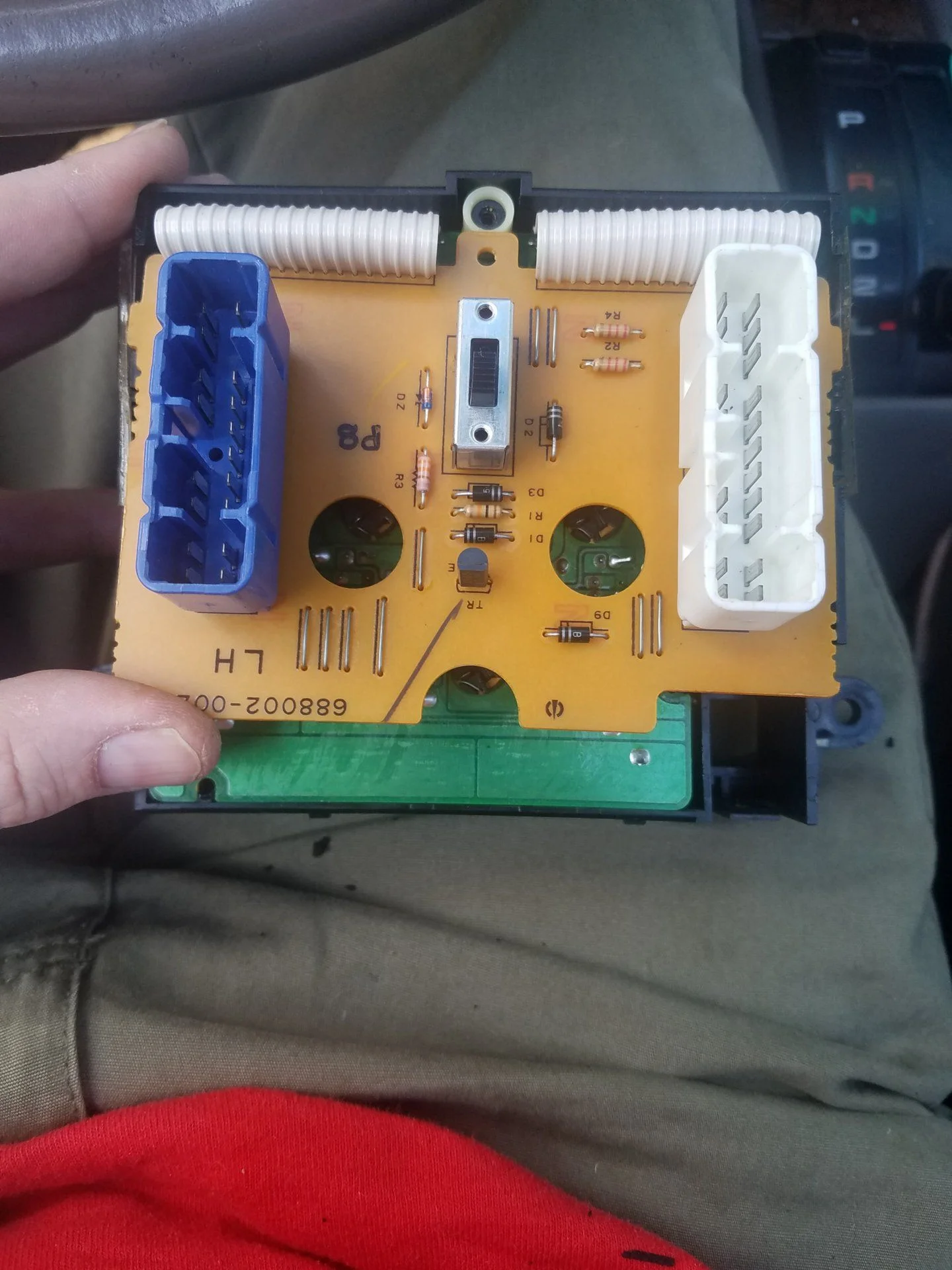

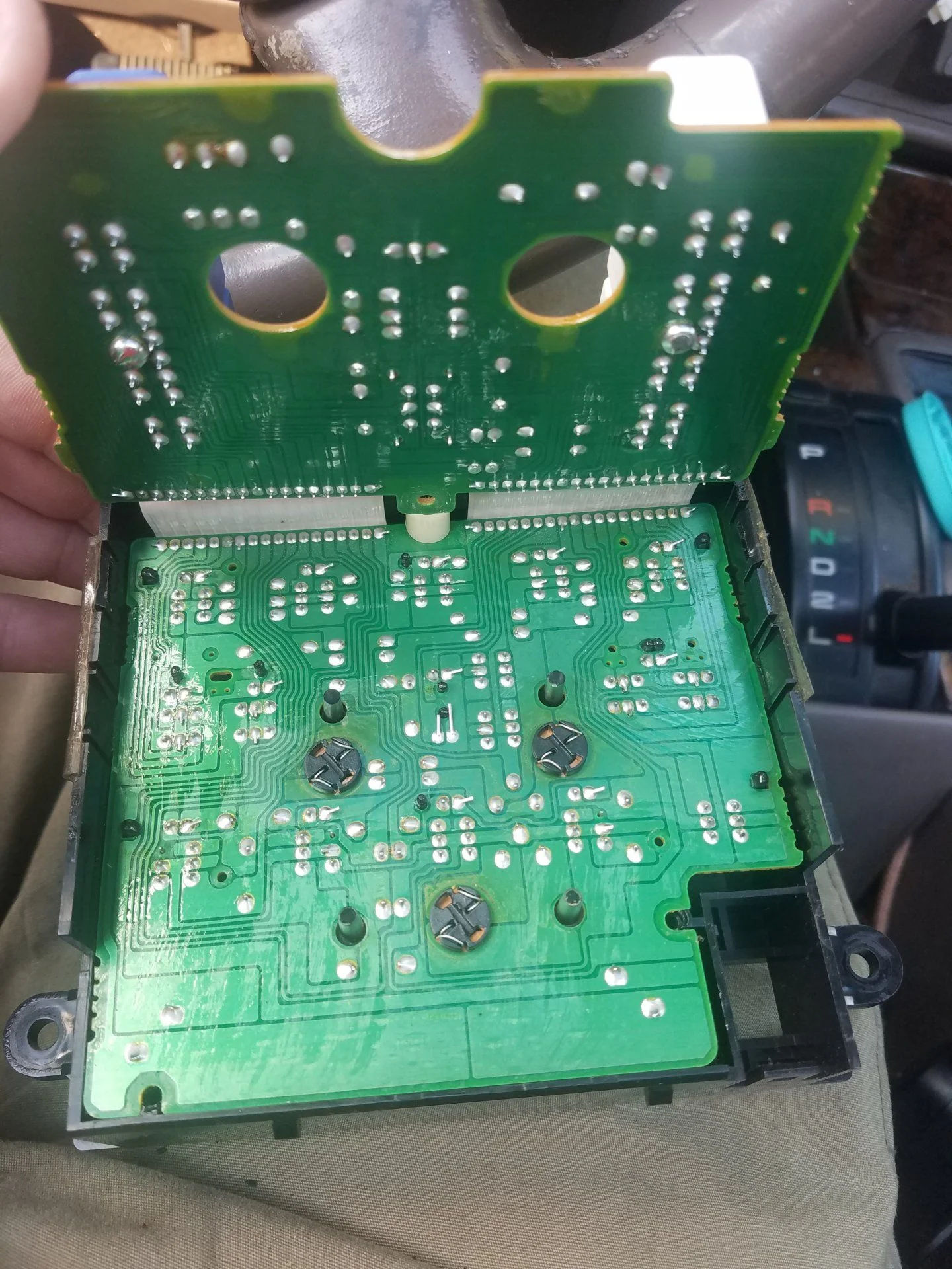

I have been chasing my heater gremlin for the last few months. I have replaced the valve under the hood, left the control detached with the valve wide open and still no heat front or back. It feels like it is only turned up about 1/5th of the way when I move it all the way to the right/hot. Today I took the entire thing apart and sprayed it all down with electrical contact cleaner. I ran out of time so I haven't put it back together but I have some concerns with the control cable and whatever is going on behind the radio because I cannot pull the cable out or push it in even with pliars. Attached are some pics of my progress. If someone could tell me where I should go from here with getting the cable loose and the mixer working I would be greatly appreciative.

I think it may be the blend door actuator. But I know for sure the cable is frozen in the sheeth. Would that be connected to the blend door? And if it is disconnected from the valve in the front under the hood, would it also not work the blend door?
Also, does the rear heater only blow hot air regardless of where the position of the slider is? Because that was the case for me when I first got the vehicle. It only blew hot air no matter where I had the temp control slider. I can't seem to find any pics that show where the blend door is or how to deal with it.
I have also heard there is a Air conditioning controller somewhere to the left of the fuse box or possibly to the left of the stereo, I am not sure as the diagram I have seen isn't clear. And this controller or whatever it is, may be the culprit. I am chasing them all..... One at a time..
