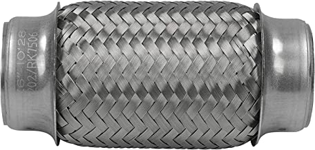

Does anyone have experience with "Flex pipe". I have never used these before, but the previous owner has one on here. The engine is non-turbo. View attachment 3182313
All my diesels have had a flex joint. Just look at how much the engine shakes and moves when shutting down and starting, also moves quite a bit when under load with the torque. I temporarily run without one once and it transferred all the movement along the length of the exhaust causing it to hit the chassis and make unwanted noises. My current petrol doesn't use one as the engine hardly moves in comparison
Thanks for the info. So are these just direct welded to the tubing? If so, can I mig weld them or does it have to be TIG.
No dumb questions.
I have been thinking of those flex joints for the new build. My running troopy has a two bolt union bracket welded to the extractors then the rest of the 2 1/2 inch pipe is bolted to that which hangs off the ome rubber mounts.
The bracket goes on real tight super snug before welded. I am guessing tig, if I did it for a living, it is the go.
My local exhaust guy did it all fairly cheap for me. I think the extractors were 100 secondhand, then 300 for the exhaust guy. He has the pipes and benders, hoist etc, I think he enjoyed doing something different to off the shelf run of the mill stuff.
I added another bracket from the gear box to engine mount arm close to the exhaust union for extra support after the muff man.
You can also get ready to go stainless exhausts which fit the 2h, not sure about the 'b', prob not. But exhaust guy said stainless is a waste of money, and his pipe shall last my life.
One thing I wonder is whether without a muff is better. Exhaust guy said the loudness would drive me nuts on the freeway so went with a muff. The stainless kits do not have mufflers.
It has been good for 100k km and I can pull it all apart if I feel like painting under the carriage, which I have done. Pretty happy, think it contributes to 12km/l milage.
