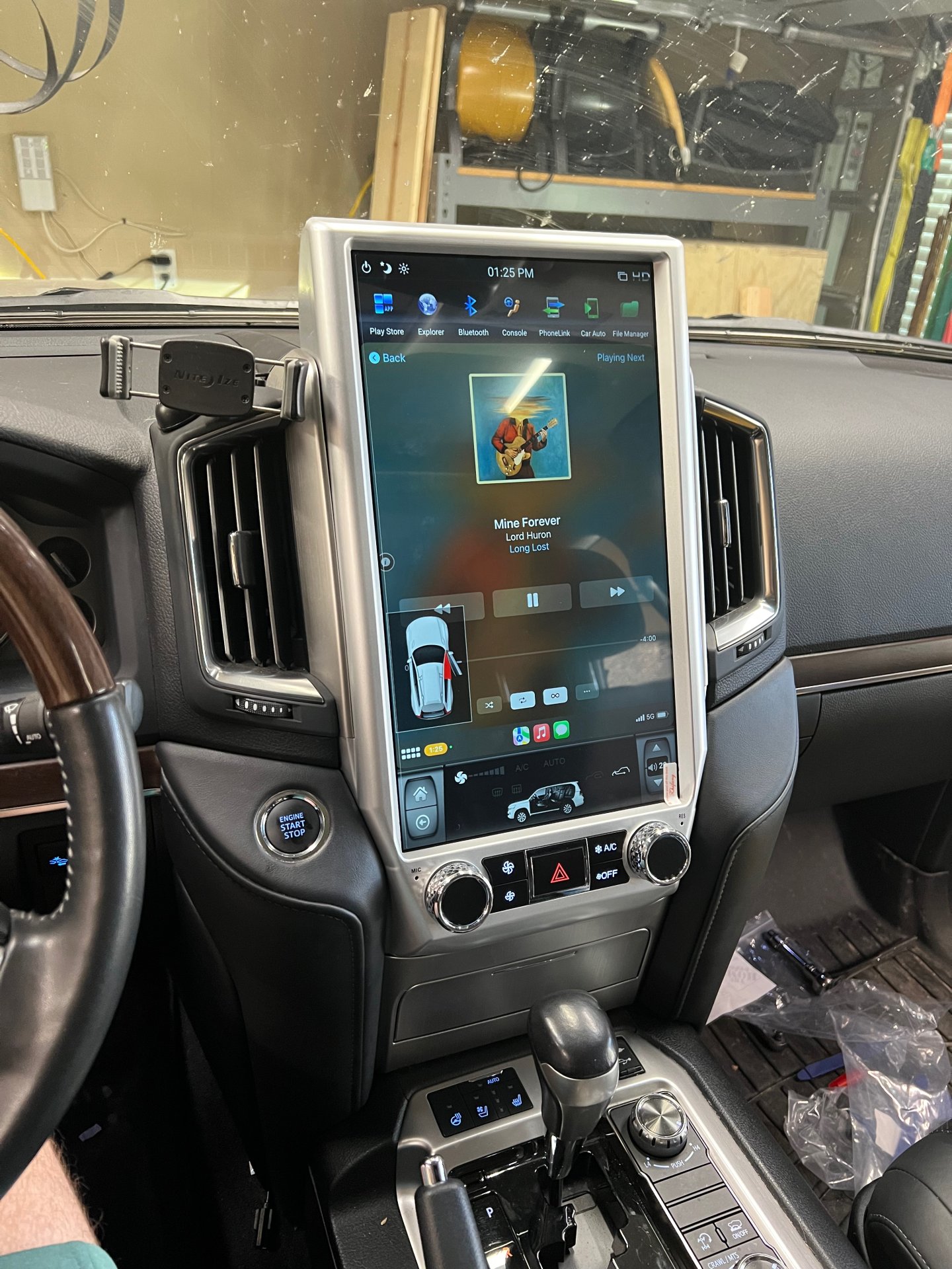

I did a fair bit of research on the tesla-style android HU and decided I wanted carplay more than factory XM capability. You can always use the XM app too. I have a 2017 LC and haven't found many people who have done the install. Only did the install yesterday and I'm in the process of doing a firmware upgrade. I'll do a write-up on my experience when it's all said and done and I've put in some drive time. Here's a picture of the unit installed...
What phone mount is that?
I'm looking forward to the write up, especially about how the HVAC controls and cameras work compared to the factory system. And yes, the Android SiriusXM app works well as does the SiriusXM CarPlay app, though there are times when the factory SiriusXM via satellite is advantageous (poor cell signal).
I did a fair bit of research on the tesla-style android HU and decided I wanted carplay more than factory XM capability. You can always use the XM app too. I have a 2017 LC and haven't found many people who have done the install. Only did the install yesterday and I'm in the process of doing a firmware upgrade. I'll do a write-up on my experience when it's all said and done and I've put in some drive time. Here's a picture of the unit installed...WOW!! That is killer! How much did u spend? Also do you mind sharing where you bought the screen? I don’t really care about any of the factory
Wow!! That is killer!! How much did you spend? Where did you buy it from? Are you using Apple CarPlay? Did you need to add a CarPlay adapter? Thank you!
chefbige09 - I'll include it all when I have time to sit down and do a proper write up. Quick and dirty answers: $780 total w/shipping, ZhiFang Electronics on Alibaba, yes and it works great, no adapter needed.

So overall I'm 90% happy I did the switch. I use Carplay everyday and the large screen makes navigating all the menus so much easier. Love using maps with such a big display. The AC controls take a minute to get used to and the rear temp shows up as something wonky like 145...no idea what that's about but adjusting up and down works.
I did the Sergey upgrade and it made the unit more reliable. I've also started dabbling in some streaming apps so I can play Peppa Pig for my 2 yo on the rear screens lol. The equalizer is way better on the unit and you can adjust more than just high-mid-low like the stock. I swapped out the stock sub for an aftermarket one and whoa...the side mirrors now shake!
The radio reception was crap so I got a powered antenna adapter off of amazon and installed that to boost the signal which now works. It reminds me just how bad radio stations are in the DFW!
I have gotten a few "that's not stock" comments as they gaze at the size of the screen!
The other 10%: Sometimes Zlink (the wireless interface for carplay app) just reboots or looses the bluetooth connection. It'll either reconnect after a minute or I have to open my phone's bluetooth settings and reconnect to the unit. Sometimes it just spends minutes on the connecting screen so I reboot the whole unit. It's annoying but luckily the uptime is way more than the disconnections. It also makes some horrible thumping noises when rebooting.
It uses the stock 360 cameras ok but with the screen resolution better than the stock unit it really shows how low-rez the cameras are on the car. I put some time into looking for HD cameras and then rethought the whole process since it seemed pretty intense and you couldn't go back to stock easily if something quit working. Figured I'd just deal with what I have which isn't terrible.
I had high hopes I would use the SiriusXM app and listen to satellite radio that way but the interface is clunky and annoying while driving. Also, if you're in bad cell reception areas it cuts out. I do miss just touching a button and XM is there easy to navigate and change channels quickly.
It's a good unit and there are things I wish it did better but can't have everything, right?

SiriusXM via CarPlay is reasonably easy to use. SiriusXM via the native Android app is kind of clunky as it isn’t designed for use while driving. Both are susceptible to your cell reception, which definitely results in more dropouts than the satellite version of SiriusXM that comes with the stock head unit. Some of these Android head units have started to include satellite SiriusXM capability, but the ones that work with our Land Cruisers do not.
So you lose your disc capability right? I'm looking to replace ours as the volume and DVD module the buttons all stopped working. It plays the DVD but I can't eject or adjust volume except for steering wheel.
Correct, no more DVD player BUT now you have a way to play videos from your phone or usb drive. I’ve streamed shows to the back screens for the kids. Only problem is that it plays up front too so you can’t split the sound out.
