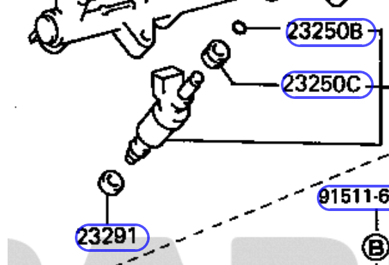

I would also recommend, for the sake of economy, since you have the fuel rail off, replacing the three O-rings on each injector, after you clean them. The procedure is in the service manual. You do not need to send them off to have them "professionally cleaned" unless you know you have a fuel delivery problem. If you don't think you do, you don't.
23250B: 90301-07001 (O-ring)
23250C: 90480-13005 (grommet)
23291: 23291-14010 (insulator)
You need (6) of the above.
You also need (4) of the gaskets (crush washers) 90430-12026 for the fuel lines.
