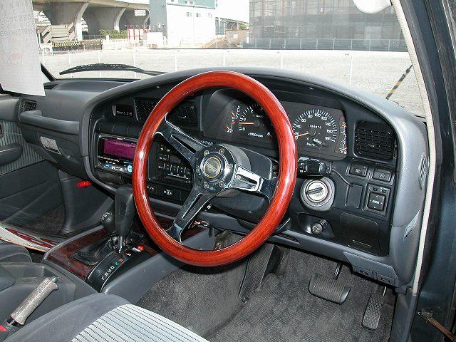

Every story is better with pictures, so here's one for looking:

Hi Dan,
My 1990 HDJ81 came with a A442F 4 speed hydraulic transmission (I don't know when/if the HDJ81s got the electronic A442F or A343F).
My understanding is that (unmodified) the A442F will only attempt lockup while opeating in 4th gear; while in a lower gear becuase of kick down or gear selection the TC does not lock. This was used to explain the overheating and resultant damage that happened to mine while towing. I mistakenly thought I was doing it a favour by shifting into 3rd and keeping the speed around 80 km/h.
Lack of the 3rd gear lockup is a reason for replacing valve bodies with an extreme upgrade from Wholesale Automatic Transmissions
-Steve

That makes sense. THe GM 700R4 works like that too IIRC. You guys don't have an OD button, just an extra gear position right?
