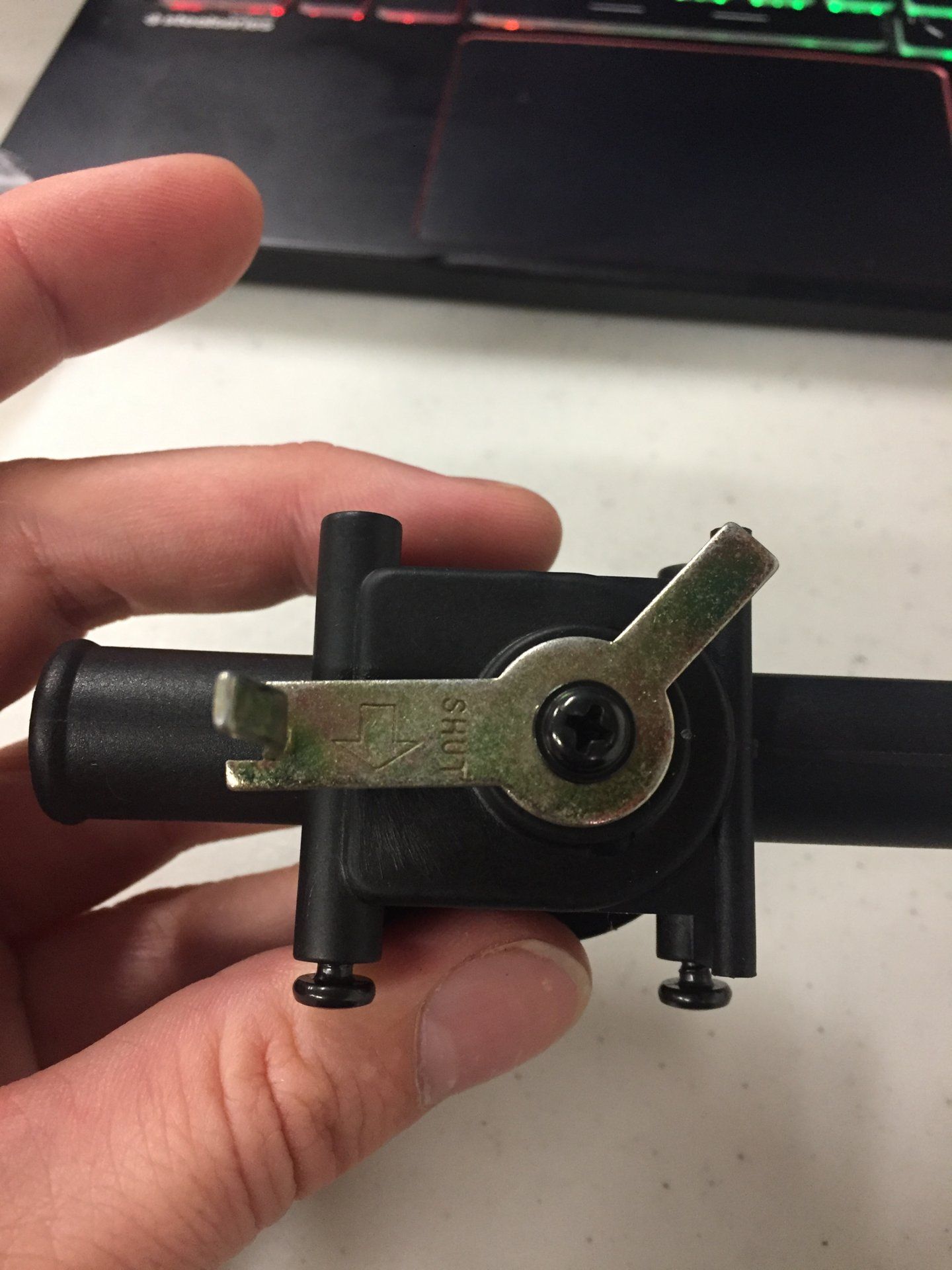

So from all the pictures I could dig up on the other Yota valves, they all seem to shut in the opposite direction. After some more key word searching I have discovered that the Ford Expedition(98-2002) may be the next target for valve replacement AND the valve only costs $9US.
So, I ordered one to have shipped to my father's winter hang out in Arizona and when he comes home, in March, I'll test it out. If anyone else wants to give it a try you can order it from Pitstop Auto or from Walmart(Sold and shipped by Pit Stop Auto) with free shipping.
Description is as follows: New HVAC Heater Control Valve 1790015 - F75Z18495AA Expedition. You can see that the valve arm shuts on the pull down not when pushed up on all the other valves I've looked at.
Minor update:
My Father received the part and sent me pictures. The valve looks pretty much identical to the factory one and operates in exactly the same direction/orientation. This could be just as easy as removing the screw and swapping the valve control arm then mounting the valve on the existing bracket. I'll post more details once I get it in hand.
OH! I Forgot to mention...This part only cost $9US. Cheap easy fix if anyone ever has a valve issue.
The valve is made/supplied by UAC and the order is fulfilled by Walmart/Pit Stop Auto. You can actually go the UAC website and look up the valve using a 2000 Ford Expedition Eddie Bauer Edition.

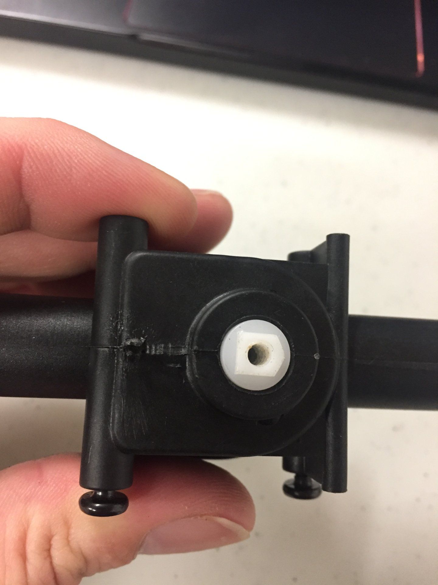

Sorry I forgot about this post! So I got the valve that my father brought back. It functions the same as the OEM. To use you’d have to remove the new arm via the one screw and put one from your old valve on. As long as the key shape fits the old arm it would be a direct replacement. Here are some pics:
