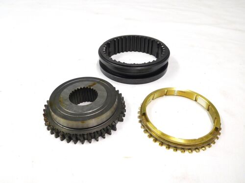

When you replaced the 5th gear assembly did you upgrade the hub to the later re-designed HZJ75 stuff? I dont have photos, but I recently had the old VS new on my bench and they are different, cured my 5th gear problem.

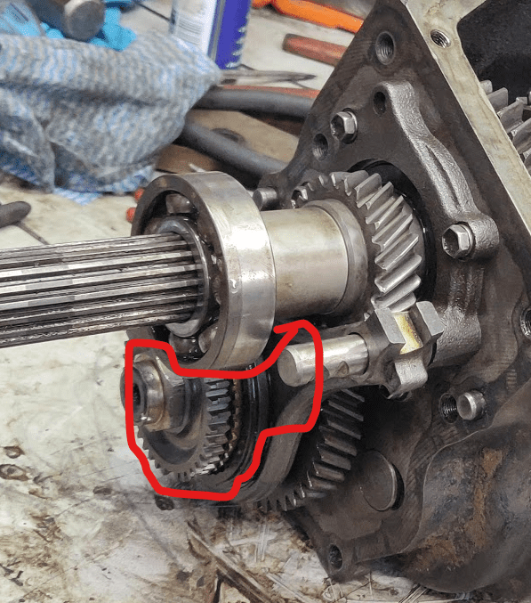

What's the matter with the poor performance of the H55F?
What is the difference?
I think this is the upgraded part 33336-60010 . Only the upgraded part is available now from what I can see. I remember someone saying back in the early 90s the 5sp problem had been fixed.
It seems to appear in the parts diagram in 1990 but can be fitted to older gearboxes. It was probably introduced with the 1HZ.
The seller tells me that it will not fit earlier gearboxes.
Ok. THe parts epc I was using kept offering that number when I put the old number in which I thought suggested this was an upgraded part that could be retro fitted to 84-90 gearboxes.
Terrain Tamer are suggesting it fits the old and newer H55F 82-84 , 84-90 and 90- .
When I put the old number 33318-60010 into TT parts page nothing comes up.
