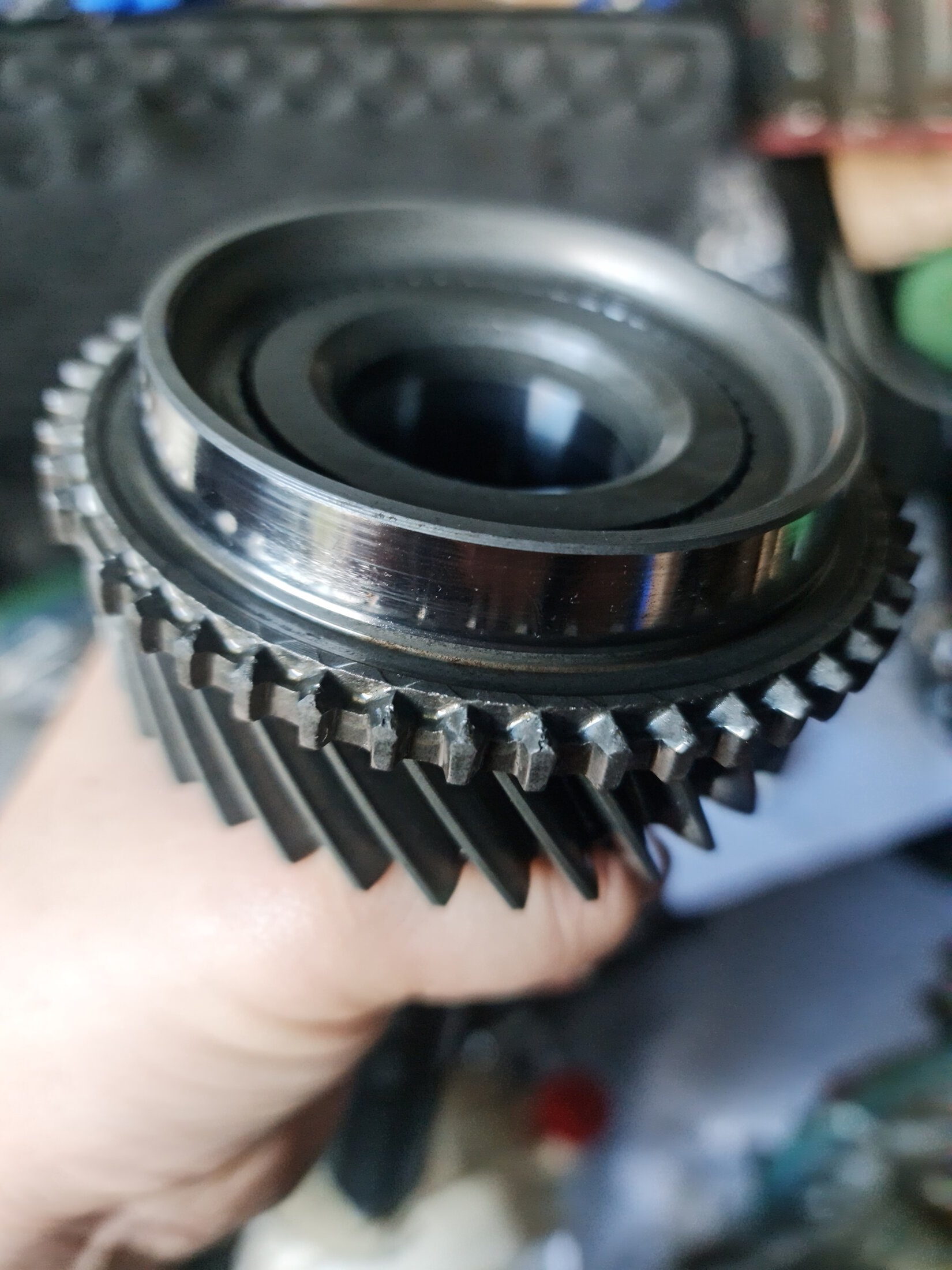

Third gear is much simpler, or much harder, depending on how you look at it. Here's the H151 third on the left with triple synchros, and the H150 version on the right with a single synchro:
Again, it's the same gear, just a different synchro hub pressed on. As you can see, there's almost no clearance here again. We could probably pry the hubs off with a screwdriver and get the three jaw puller in there, like we did for the H150 first gear, but it'd be harder, as we'd have to be careful not to put any pressure against the edges of the gear teeth. On the other hand, there's no need really, as the gears have the same ratio. After close inspection, I opted to just swap over the gear assembly entirely. Yes, the counter shaft has already "worn in" with the original gear, but honestly the gears are basically immaculate with barely any wear and virtually identical wear patterns, and if I was to replace a gear with a new one the counter gear would have to deal with that anyway. I decided it was better to avoid potential damage to the gears and just swap them rather than trying to pry this hub off the gear.

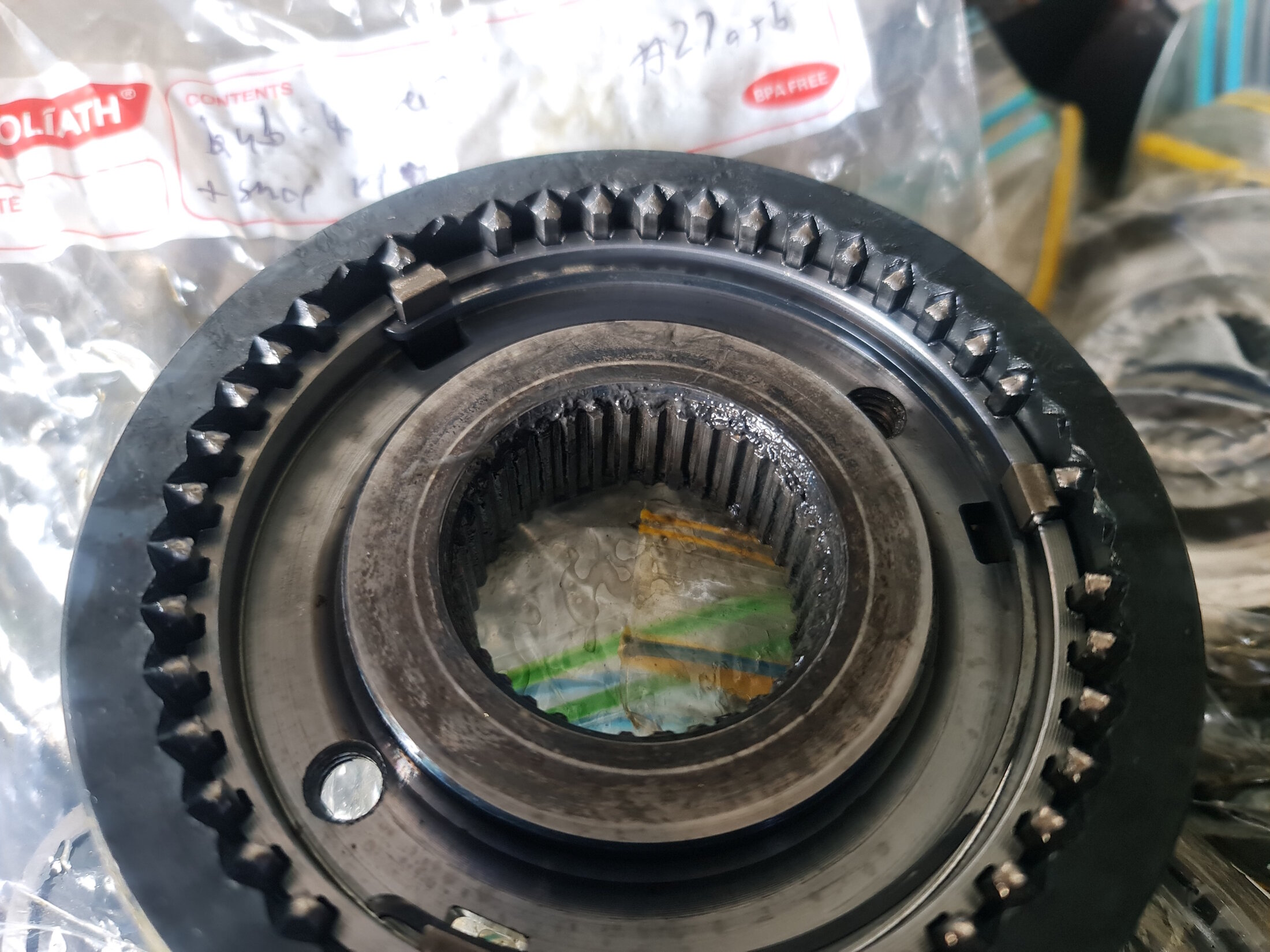

Now it's time to rebuild those hubs. I've left the fourth hub, which deals with reverse, for later. For now I'm doing hubs 1, 2, and 3, which fit onto the output shaft prior to fitment into the intermediate plate. The critical info is right here in the FSM:
Every one of these hubs and hub sleeves is directional. There will be a bevel on an edge of each sleeve to show orientation. The shifting keys on one of the hubs are also directional. Be aware - they changed design of the sleeves slightly over the years, they may be an angle as shown in the pictures, or a "step" instead. You can compare the "teeth" of the sleeve to doublecheck. Hubs 1 and 2 only have angle-cut teeth on one side, and hub 3 doesn't have teeth on one side at all. Be slow, careful, and methodical here. I took pictures before disassembly of each one so I could triple-check everything with the original setup. You don't want to get this part wrong. Also make sure you offset the shifting keys as shown in 1b. One of the "blown" boxes I picked up for cheap had lost all three shifting keys after a rebuild. From what I could see, the key springs had been "aligned" rather than offset as shown. This results in less force on the "middle" key, which resulted in it coming out, after which the other two managed to do the same eventually and there was a hub with no keys to lock it into the blocker rings, which meant the sleeve ate the blocker teeth from the synchro rings. Don't make the same mistake. Quadruple check your build here, take your time.
Quick word about hub No.1. I recommended replacing it above. Here's why:
All the other hubs were immaculate, this one was not. See the noticeable wear on the teeth? When your synchros go bad, and you're jamming the gear in, the hub sleeve crash locks with the teeth on the synchro hub attached to the gear, and that force carries back through the sleeve and works like a jackhammer on the hub. Every 80 ever built had a worn out 2nd gear synchro a decade ago. You'll want to replace this hub. It'll give you smoother shifting and better engagement.
Now for the actual hub rebuild. This requires three hands as it is, so I didn't really get any in-progress pictures, but first you gently pry the springs off the back and front with a screwdriver, and lift out the keys. Remember one of the hubs has directional keys (not this one shown below), so take note of the original orientation to help sanity-check during reassembly.
All we're keeping here is the hub (actually for this one shown, not even that), but strip it down, and clean it off. Give it a good spray and a wipe, and in particular clean up the inside teeth that engage with the output shaft. Reassemble using new keys, springs, and sleeves. I won't show each hub, they're all the same thing more or less, but in the end they should look something like this:
Here's a quick snap showing the directional keys for hub No.3, which is a single-sided hub used to engage fifth gear. The single-sided reverse hub also uses these directional keys (it's actually an identical hub).
And here's a picture showing why we replace the shifting keys:

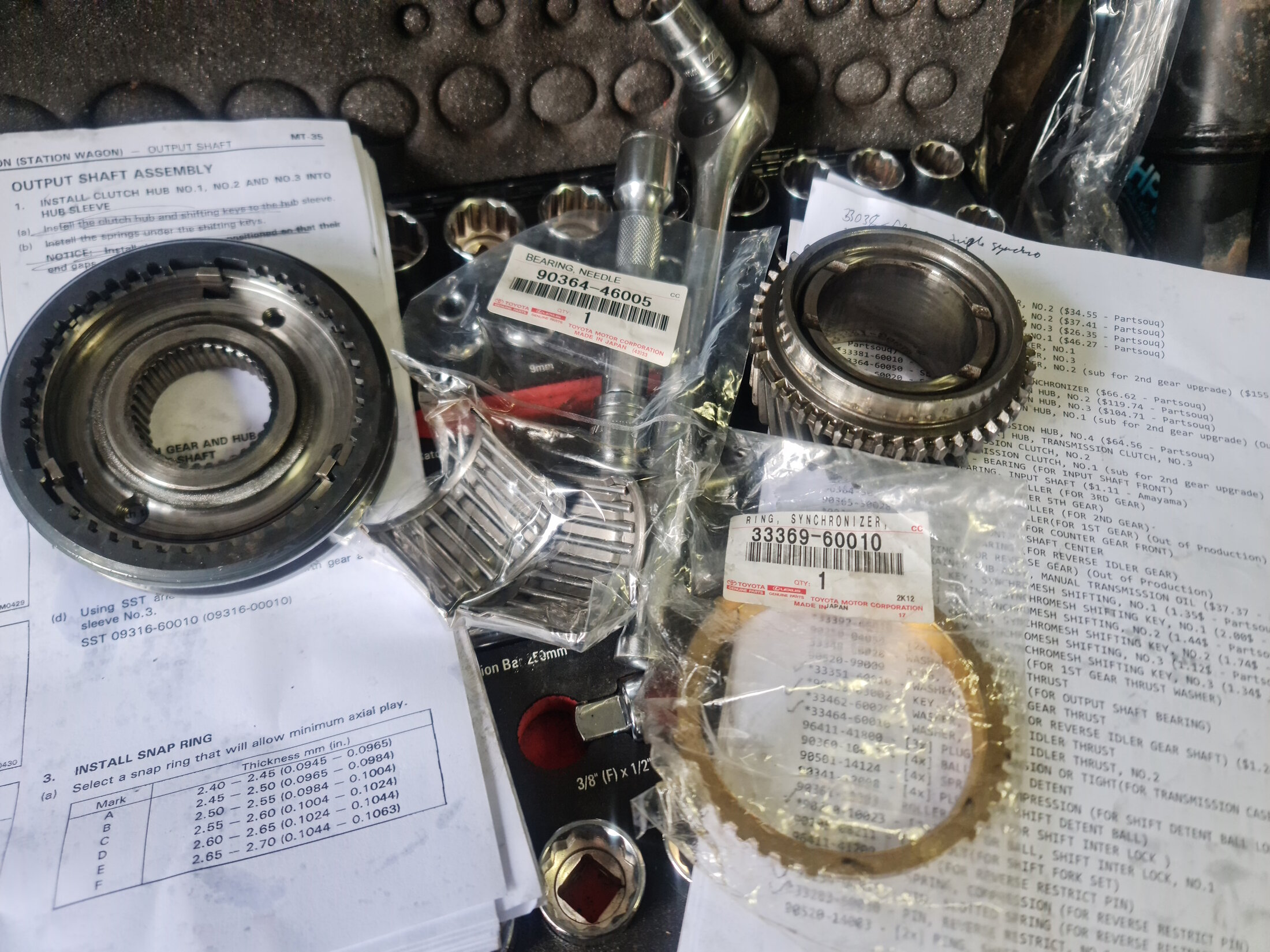

Step 2 - Install fifth gear and hub sleeve No.3 assembly on output shaft
It's now time to start putting the output shaft back together. Before you've done this, I assume you've sourced new needle roller bearings and synchros, and you've inspected the gears themselves for wear and damage. What you want to be looking at with the gears isn't so much the teeth that mesh with the counter gear (although please do inspect those), but the teeth on the synchro hub that engages with the hub sleeve. If these are chipped or badly worn, you need to consider replacing them. I had a few in that camp, and I'll talk about how I handled that below when we get to it.
We also need to clean everything up nicely, which won't be listed in the FSM. I recommend a good blast of the inside of the gear with some parts cleaner and a clean wipe too. It's not just the gears either, make sure you get a brass brush and clean up the engagement teeth that lock into the hubs on the output shaft if you haven't already. They'll be pretty grimy. You should have already done the hubs themselves during the rebuild you did on them.
Now get your parts all laid out. We're starting with fifth gear.
2a - As per the FSM we need to apply gear oil to the needle roller bearing. This will provide lubrication for the bearings and journals on first start before the oil pump pushes gear oil around everywhere. Get on a pair of clean gloves each time, you don't want to contaminate the bearings with dirt or material that'll score the bearings and the journals. This gear uses that split bearing cage so it comes in two halves.
2b/c - Slide the gear, synchro, and roller bearing onto the output shaft. Note what it says about aligning with the shifter keys. This is harder for some gears than others depending on the side you're pressing, and this is one of the hard ones. The synchros have cutouts for the shifter keys to fit into. If you don't have the keys aligned with the synchro ring when you press it, you'll damage your expensive rings. Pay close attention to the alignment in the next step.

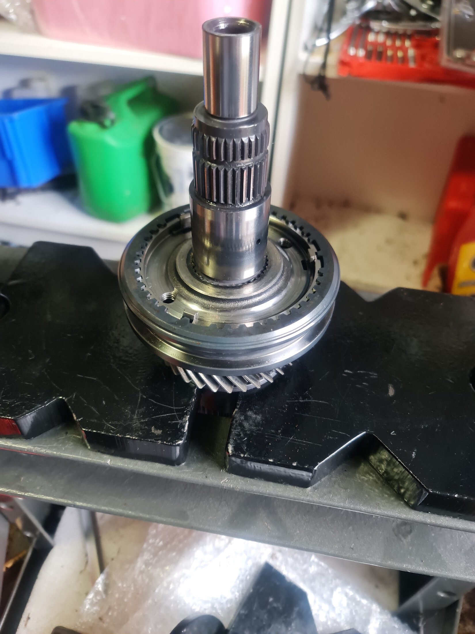

2d - It's now over to the press. The FSM doesn't call for this, but I recommend using a good multi-purpose grease on the splines of the output shaft and the hub, where you're going to be pressing the parts together. It looks to me like it was greased in the factory, and I just consider it good practice to assist in smooth driving of the parts without damage.
Remember your hubs are directional! Check the orientation of the bevel on the hub with the pictures you've hopefully taken, and the orientation guide in the FSM.
In order to press this hub, the gear is going to be on the bottom, the hub on the top. This is where you need to be careful about the alignment of those keys. Check it a dozen times as you press the two closer together. You want to make sure the synchro ring doesn't get caught up. FSM calls for a fancy long press tool. You can make do with whatever, some pipe, or a couple of spare arbor plates like I did here.

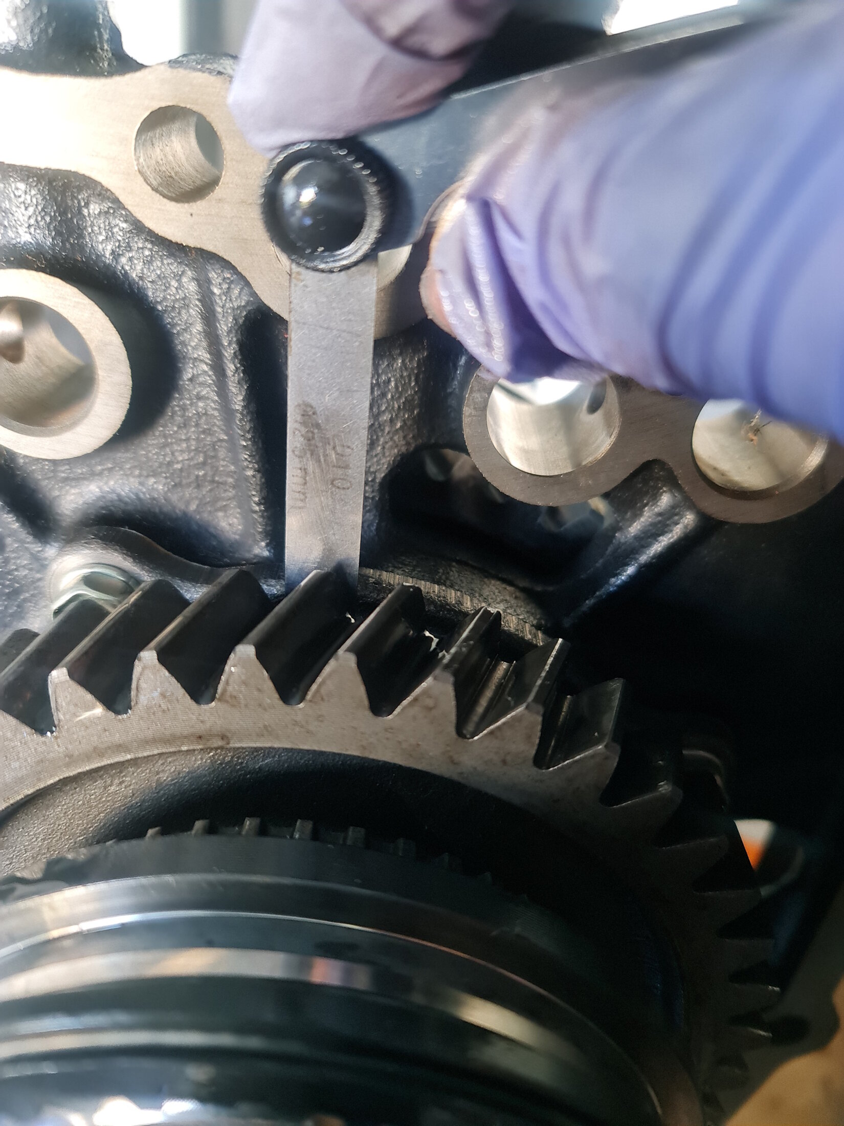

Step 4 - Measure fifth gear thrust clearance.
I'm honestly not sure how this could go wrong if you've got the correct bearings installed, but as per the FSM we're going to measure thrust clearance as we go. Get a set of feeler gauges and check the clearance. I got 0.18mm-0.20mm here, which is well within the standard range.

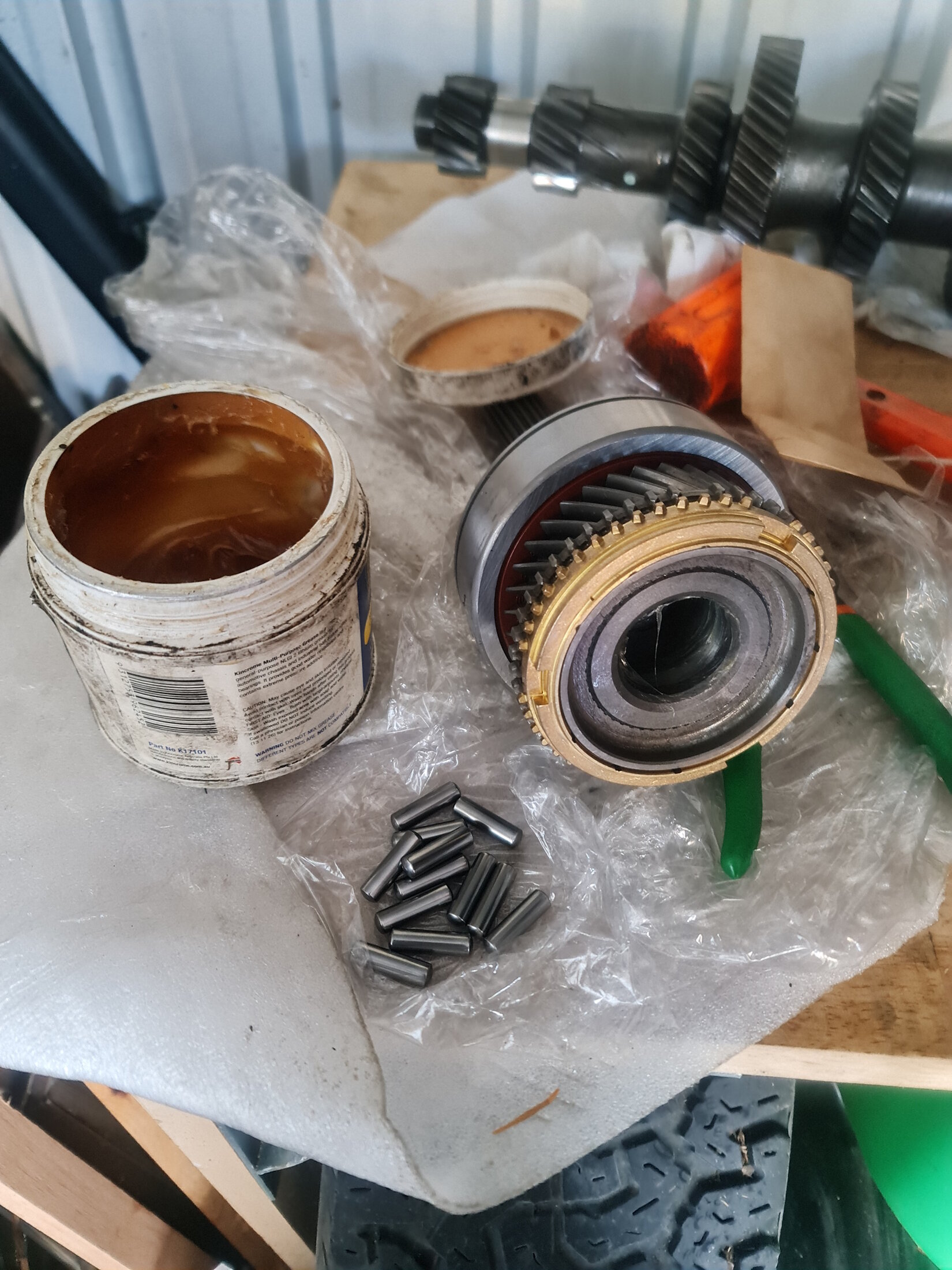

It's now time to turn our attention to the input shaft. We haven't disassembled this yet, but it's time to now. Details in the FSM at MT-18, but it's really just two pages talking about inspection and removal/reinstall of the bearing. We'll go through the steps I did here. First, here's the input shaft from this box, with its 12 roller bearings still magically suspended in place:
Note the 21 splines on this input shaft, it's the one designed to mate with the 275mm flywheel found on the 1HZ engine, and the 1HD-T as well in Europe, as opposed to the 14 spline version that goes with the 300mm flywheel on the 1FZ-FE and 1HD-T outside of Europe. This is also the post 1992-08 version for the deeper bearing. Toyota used a shallower, weaker bearing on the H150 boxes before that, and the input shaft has a flange to contact the shallower bearing.

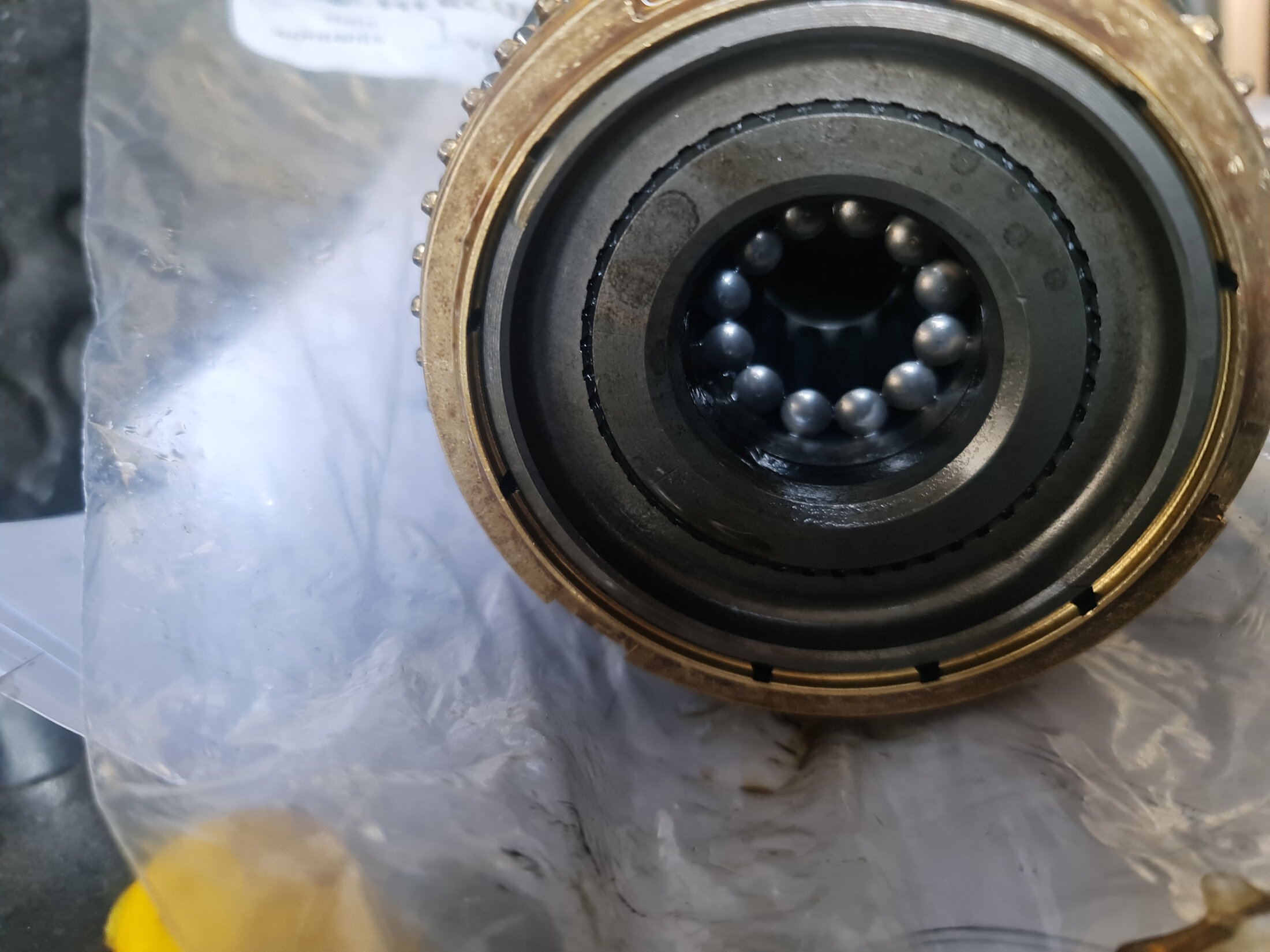

We're going to remove those 12 individual roller bearings and the synchro ring, which come off easily by hand. Next step is to remove the snap ring holding in the input bearing. This one you'll get your snap ring plyers for again.

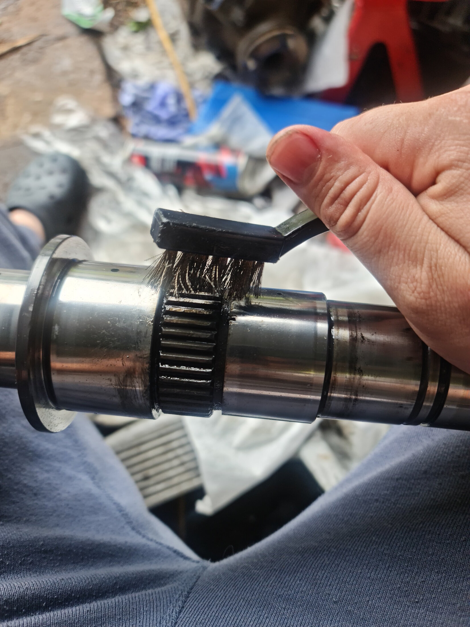

Now we clean up the input shaft and synchro cone good and proper, grease the splines, and press the good cone onto our input shaft.

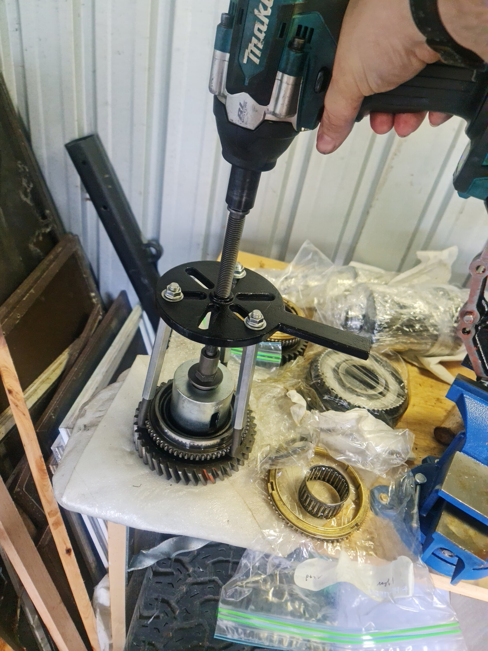

Now it's time to "rebuild" the counter gear.. which really just means change the front bearing that's still attached to it. This is in the FSM at MT-31, but it's really just a few steps. First of all, remove the snap ring holding the bearing in place.
Now it's time to pull the bearing. The FSM calls for using a press and a bearing puller, but you'd have to have a massive gap between the two sides to fit the gear assembly through. Mine doesn't, so I used the three jaw puller instead.
My finger isn't pointing to anything important there, it's stopping the entire counter gear rolling off the bench while I take a picture.
Now this bearing is a funny one, the inner race isn't fully closed on both sides, just the front. When you pull it, grab it by the outer ring so you don't pull out the inner race entirely and drop the roller bearings everywhere. You'll find the side race still on the counter gear shaft. Slide it off.
Clean up and inspect the counter gear, and it's time to press a new bearing. I took the journal diameter measurement as per FSM, perfectly in the middle of tolerance. Worth inspecting, only takes a second. New bearing.
I didn't follow the FSM procedure for pressing this bearing either. I put grease on the bearing races like I've done before, but to minimize the risk of anything going askew, I felt I was best off pressing the shaft down into the bearing first, which I did up until the point shown below where the counter gear shaft end is flush with the bearing race.
I then flipped the shaft over and drove it the rest of the way with a bearing press, then fitted the snap ring.

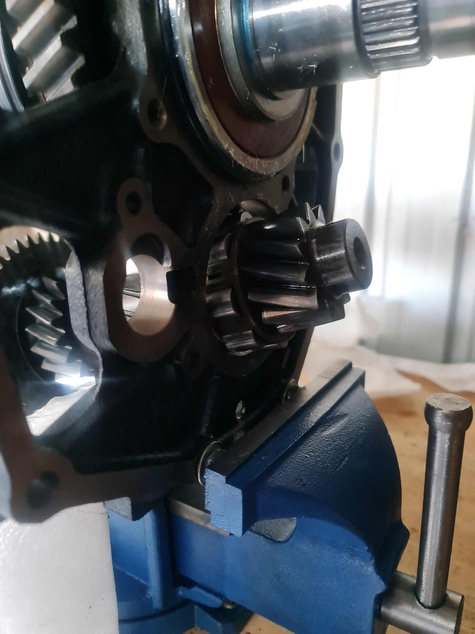

Step 3 - Install counter gear
This part is a little fiddly. Get some padding installed on your vice so you don't damage the counter gear, as per the removal step. Get your new rear bearing for the counter gear ready to go. It's an unusual split bearing. Note that with a new bearing, the snap ring comes installed with the bearing new in the box. There's no need to remove it, and we don't need the one we originally removed to get the bearing outer race off. When we install this thing, we're just going to slide the entire outer race in with the snap ring installed. The snap ring will set the "depth" of the outer race for us.
3a/b/c - The FSM makes this sound so easy, but really it's quite a fiddly job. No good pictures here I'm afraid, I needed both my hands to do the reinstall, but basically you need to slip the counter gear too far through the intermediate plate, being careful not to damage any of the gear teeth, fit the two halves of the plastic bearing cage together with the race poking out the other side, then move the counter gear back into position and slide the outer bearing race over the edge. I applied grease to the outer edge of the bearing race here, but not to the intermediate plate since it would have gone everywhere when messing with the counter gear.
The bearing race is shown resting here, not installed, but it just slides in with no real force. Certainly doesn't need to be driven in with a brass bar like the FSM suggests, just a smear of grease and it'll just about fall in place. No need to do step 3b as I described since a new bearing comes with the snap ring installed, so unless you're reusing the bearing (which I REALLY don't recommend with this one, given the plastic cage), it's just the outer bearing race to do. Doesn't look like I snapped a pic with the race pushed in but you get the idea. I supported the counter gear lightly with a ratchet to free up my other hand here. A helper would make this step easy, and even if it's just you it shouldn't be too hard, since you won't be trying to snap pictures on the way.

This is fantastic for a number of reasons. While reverse is probably the most likely gear to have mashed teeth, 5th gear is the least likely, since of all the gears it probably sees the least number of shift events over the gearbox life, and with the smallest rotational speed differential of all the gears. In my case, with spares on hand, I had a 5th gear with an immaculate cone I could readily use. Even if this isn't the case for you when doing a rebuild though, the original 5th gear part 33036-60010 is still in production since unlike reverse, it hasn't shifted to a single-piece cast. This means you can buy a new 5th gear, remove its synchro cone, and fit that onto your reverse gear to make it like new again.
I'm going to show that process now, swapping the synchro cone from 5th to reverse, but basically it's the same kind of thing I showed above when I did the three piece synchro upgrades. To pull the synchro cone from 5th, I used a bearing splitter and the press:
To pull the cone from reverse, I used a three jaw puller with one of my bearing press sleeves:
Old vs new:
Now we press the replacement sleeve onto the gear:
We now have a nice remanufactured reverse gear assembly, with neat engagement teeth on the synchro cone.
With the reverse gear itself sorted, it's now time to proceed with step 5 from the FSM, and install the reverse gear and hub.
5a/b - Get some gear oil on the needle roller bearing, and slide the bearing and gear onto the output shaft, then install the synchro ring. Pretty straightforward.
5 c/d - Now before proceeding, it's time to rebuild the reverse hub. Get your parts together.
You WILL need a new hub sleeve here. It's not optional. You saw the state of the engagement teeth on the reverse gear synchro cone, the teeth on the shifting sleeve are going to be similar, as you can see here:
Rebuild your hub as per all the others you've done to get to this point, and have it ready to install.
5e - It's time to install the hub itself onto the output shaft. We grease the splines as per the other hubs. How are we going to install it though? We can't just use a press, since everything is mounted together in the intermediate plate. The FSM calls for a fancy driver to install this hub. If you have some kind of deep bearing presses you might have something that'll work. I didn't, so instead I got a brass drift and drove the hub on, slowly. I worked my way around, kind of the same way you'd torque a flywheel, a few bangs on one side, a few bangs on the opposite side, shift 45 degrees or so and do another few of bangs, working it slowly onto the output shaft. It takes awhile, but it works. The key is to try and keep the hub as straight on as possible. You don't want to drive it at an angle, as much as possible you want to be driving it when it's aligned straight on. Expect this to take 10 minutes and for your arm to get tired, but eventually it'll go on all the way. You need to be careful of the synchro ring though! As you wail on the hub, it'll be pretty much impossible to keep the synchro ring lined up with the shift keys. This would be the same with the SST tool Toyota use in the FSM. What I recommend is you take some shop cloth, a rag, whatever, something soft, compressible, with some volume to it, and push the ring up into the hub, so that the ring isn't on the gear, it's seated in those keys on the hub as you drive the hub onto the output shaft. Keep on checking its placement frequently. Be paranoid about this, you don't want to ruin the ring, although it is the cheapest of the lot it'll still mess you up and delay things if you have to source a new one. The bit of cloth keeps the ring where it should be as you slowly drive the hub in place, so that's what I recommend, just make sure you move it more and more out of the way as it gets closer. Cloth isn't shown in the pictures below and the ring is against the gear before driving, but don't do it that way. Move that ring up into the hub and put something behind to keep it there.
Step 6 - Install snap ring
As per the FSM, drive that snap ring on with a brass drift.
Step 7 - Measure reverse gear thrust clearance
Same as the others, let's check our thrust clearance on our reverse gear.
