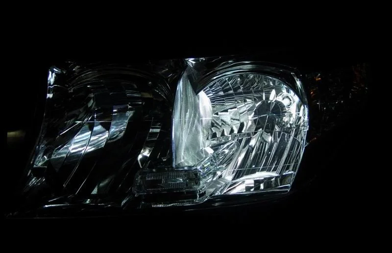

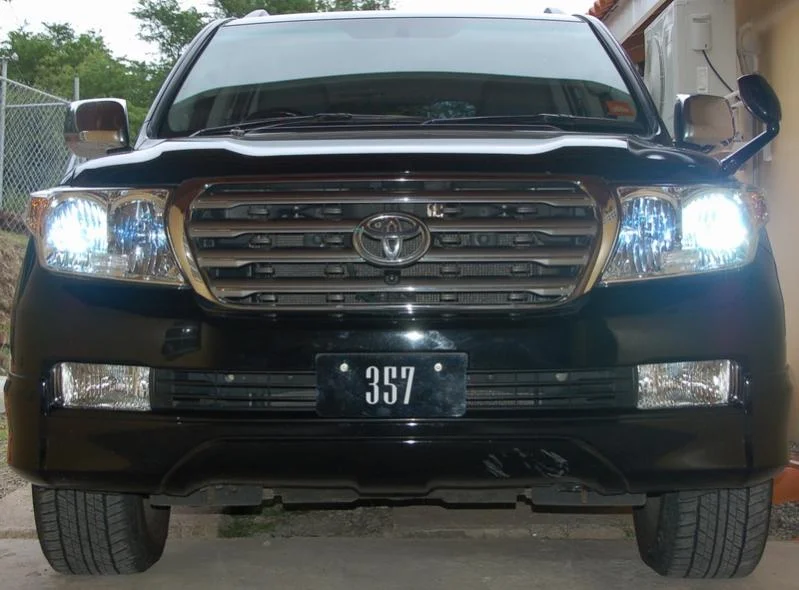

Hello all.
I though you might be interested in seeing this..
Just installed these after market, plug & play Low Beam HIDs on my Land Cruiser, doesn't seem that blinding during the day -beam height level adjusted to the lowest-, the effect isn’t bad, projection on nearby wall seem well concentrated and no out of control reflections……
I’ll update the forum on driving experience during the night…

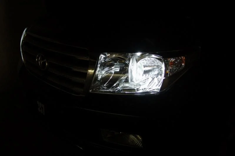

With the low beam height level to the lowest, this HID is still lethal, too bright, I keep my windows up so I don’t hear all the insults and see all bird flipping!
Seriously now, no insults yet, but it is truly, extremely powerful, take a look at the pics.

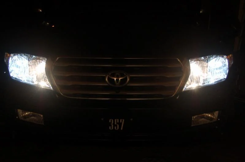

More pics..
And more..

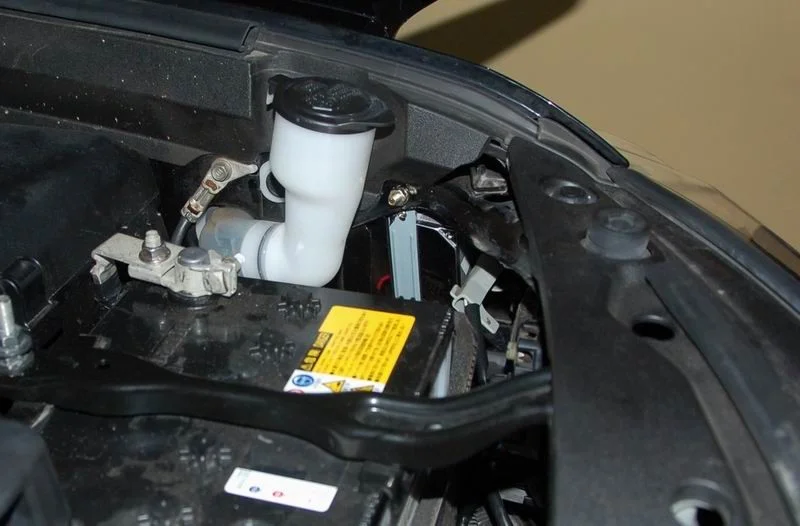

So where exactly is the ballast? I am trying to picture the area you placed them in.
Do you really get people yelling at you even at the lowest setting?
Nice pics!
The Ballasts are in the corner cavities behind the headlight as shown in the pics, I didn't go out far yet -it is rainy tonight- but I'm sure whoever dare will!! it is that bright..

I guess I over stated the output of my HIDs on low beams –adjusted to the lowest height-, it is actually quit good and not that blinding after all.
I did a comparison test (one side HID, the other fitted with the original bulb), obviously the HID was brighter but not more blinding than the original.
I had a friend drive my LC and I used his Camry, drove in opposite directions a few times on different curves and angles, the LC’s low beam HIDs were very noticeable but not blinding.
The good news is that if needed, the low beam’s aim can be easily raised higher for off and back roads.
Also, I thought why not try HID on the high beam instead, in theory because it is used less often and as needed (off road or to respond to incoming idiots with their hi beams on!), results; DON’T INSTALL HIDs ON HIGH BEAMS in SUVs, their brightness and aim can be physically painful!
I’ll put some matching –bluish 8000K- xenon-like halogens instead.
I went further and installed HIDs in the LC’s fog lights, the effect is exceptionally remarkable and the vision is truly daylight like.
I hope this is useful to all of you who are contemplating whether to install HIDs or not.
