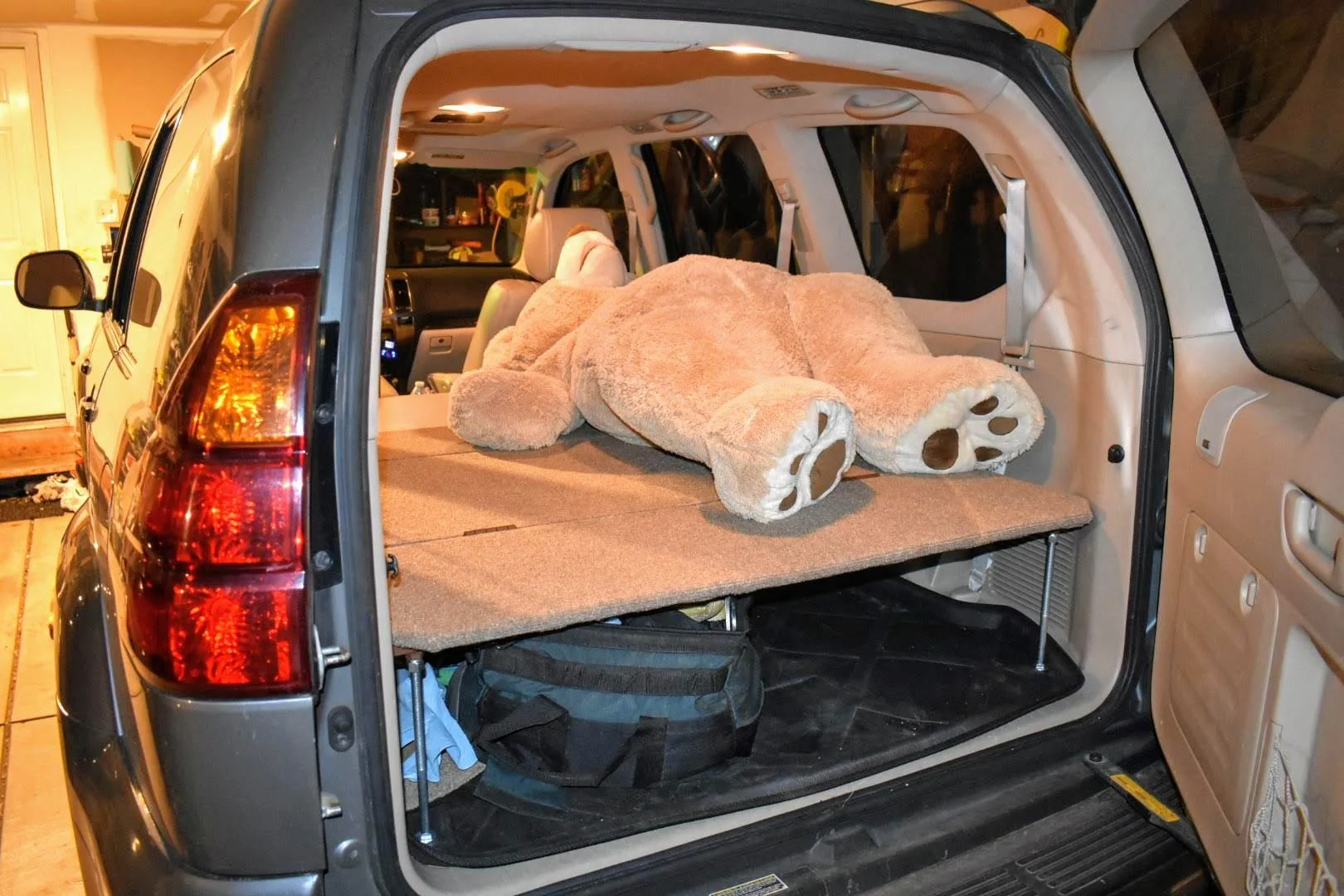

I'm 6' and I just fit in (legs stretched) with the second row seat removed. I built a little platform to span the foot well and used some old carpet to cover. If you're doing a drawer system, this isn't really relevant, just using it for visual.

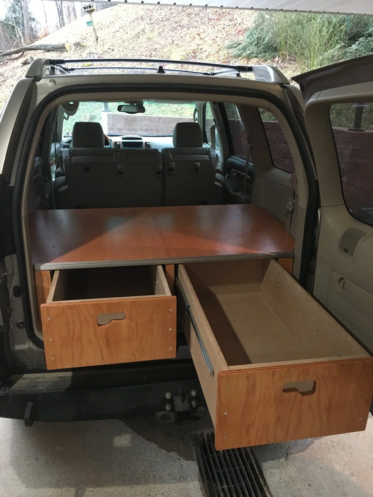

Thanks a lot for the reply. This was kind of wait I was looking for. I’d like to do a raised platform with two drawers so I can still utilize the rear seats when needed. I actually also came across this
It seems similar to yours, but raised. I asked the dude for measurements but he hasn’t replied. Is it safe to assume that the length is about 6’? Is that how long yours extends? Thanks a bunch.
I basically did the same thing and with the front seats moved forward I can stretch out without touching the front seats or the rear door and I'm 6'2". Super cheap to make and very convenient since you still have storage in the back and the rear seats remain in use.

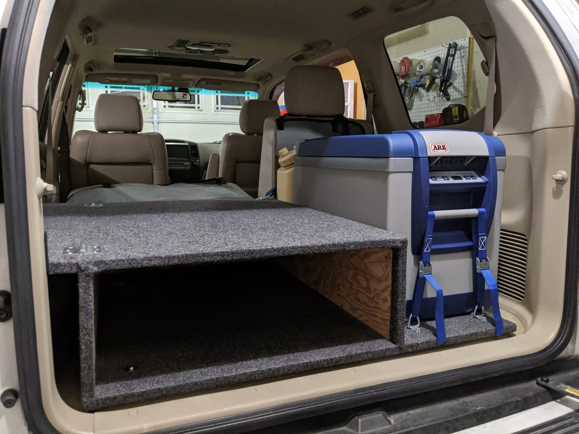

I really like this setup! Are you running solar for the fridge?
No solar right now. I am running it off of a 92ah group 27 AGM battery. It's going to be put to the test in 90 degree heat for the next 5 days. Luckily we will be traveling 70+ miles each day to top it off and not bringing a bunch of perishables.
