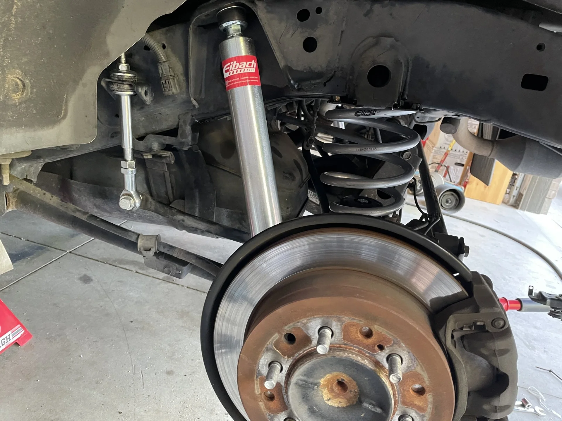

Hello,
I’m in the process of installing an Eibach Pro Truck lift on my 2006 GX. I bought the Ironman adjustable rear sway bar links for a 0”-3” lift. I made the mistake of not taking a picture of the rear sway bar before the new install so I’m not too sure of how it should be positioned. Right now it’s sitting a little above parallel to the floor. Any suggestions?
With the truck on the ground, get it so the bar is more or less level with the garage floor. That way the bar can twist like it is supposed to without causing travel limitations.
Ok. Thanks. I’ll give it a go.
