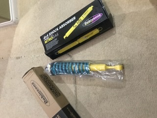

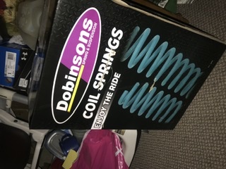

My name is Andy and I finally received the last pieces for a suspension upgrade. I purchased a 2006 GX470 early November of last year. I immediately jumped on the Black Friday sales and purchased a Dobinson’s 2.5 inch lift kit along with their UCAs and differential drop kit. Been sitting on the kit waiting for the UCAs which finally arrived yesterday.

So now I have all this ready to get installed:
any suggestions on a shop in San Diego county who I could trust? I’ve been to a couple places and the going rate seems to be $100 an hour. But one place told me 4 hrs the other said 6. I have a couple options with friends, one being my regular mechanic. But lift kits aren’t necessarily his specialty.

Congrats on the rig!
Any mechanic can do it. It is a straight forward job with no fancy tools required. If you trust your friend, let him do it. I did mine in my driveway. The 2 hardest things are in the front. 1. The Long A$$ bolt for the UCA's. 2. the tiny allen bolt holding the shock adjusters on top of the struts.
Thanks BrickGX and CarolinaGX. Yeah I think I’m going with my friend. He said we can work on it at his shop on a Sunday when no one else is around. I’m sure I can learn something and maybe even get my hands dirty. Thanks for pointing out the 2 things. Definitely keep that in mind
