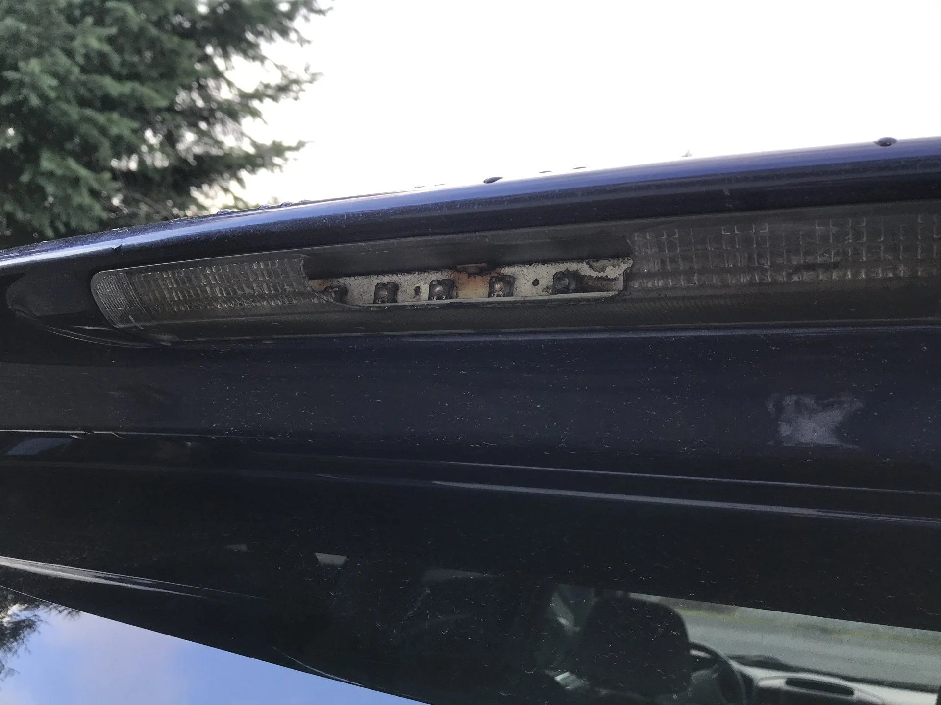

Oddly my 2009 came equipped with a shattered, clear 3rd brake lamp assembly. It appears it is an LED unit and very expensive at that. $229 from Lexus. I have a factory rear spoiler and it is situated on the spoiler rather than on the body.

I don't think 81570-60081 is the right part number for the light on the spoiler. It looks like it's the brake light for GX's without the spoiler.
It's entirely possible that the spoiler brake light is not available as its own part number -- only as part of the entire spoiler.
After looking more closely on OEM parts sites I concur. 81570-60081 appears to be the parts number for the center brake lamp on GX470's without a spoiler. I am specifically looking for a clear, LED based unit which attaches to the OEM spoiler.
Sorry, misread what you were looking for. Now that I see the pic, yep going to be tough to find a replacement for that. I would measure it up and look at the aftermarket LED strips to see if any match up. The wire feeds through a hole on the back door to where the third light mount is on the body, still uses the connector, but hopefully you can salvage that off the old one.
Might be less effort to get a replacement spoiler with the light included

Well the new replacement light arrived and looks decent. Lit up bright when tested on the bench. However, the screws holding the OEM lamp to the spoiler appeared welded in place as they were so tight. I’ve tried lots of persuasion to get them out. Steady pressure with a #2 screw driver, has still started to open the Phillips heads to the point a #3 worked better. Heated the end of a driver with a Torch and held it against the screw, just in case there was Loctite in play. I was able to get three or 4 turns on them and got the light to loosen. I suspect the screws must be running into a steel body clip which I bet is super rusty. I was able to gently pry the housing down enough to fill the area around the screw with WD40.
12 hours later, tried again and no dice. Going to give it another day or two and then drill the heads off the screws. Crazy, it is just a plastic light screwed into a plastic spoiler!
