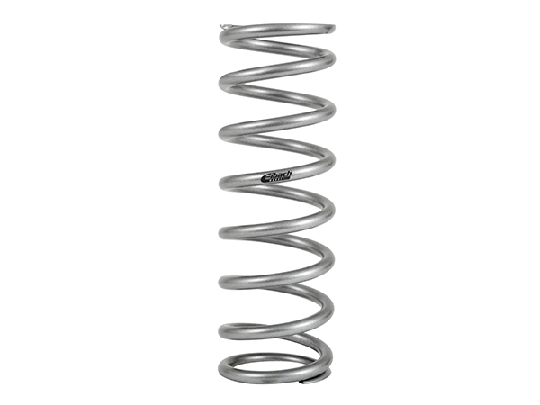

I have a 2016 GX460 with a Radflo 2.0 Lift Kit and Total Chaos UCAs. I'm on 285/70/17s Wildpeaks running about 38 PSI. These are the springs I am running in the rear:
Does anyone have any experience with this setup? The rear of the vehicle is extremely stiff and bouncy. I know these rigs are not supposed to be super plush with the body on frame but it seems excessively stiff to the point where my newborn in the car seat's head is bouncing around on every uneven surface.

I’m running the Eibach stage 1 lift kit on my GX470 and is definitely not stiff. Not sure what the spring rate is or if it’s different for the 460. Pretty sure they are the same.
If anything they are little soft.
220 lbs/in is pretty typical for "light load" springs, and is about the same as the Ironman rear coils I used to have (that were not overly stiff).
