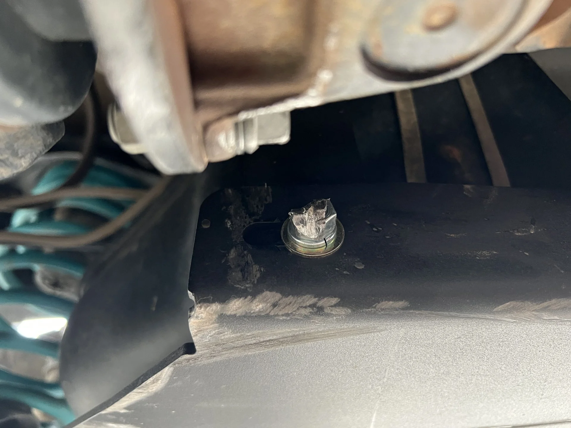

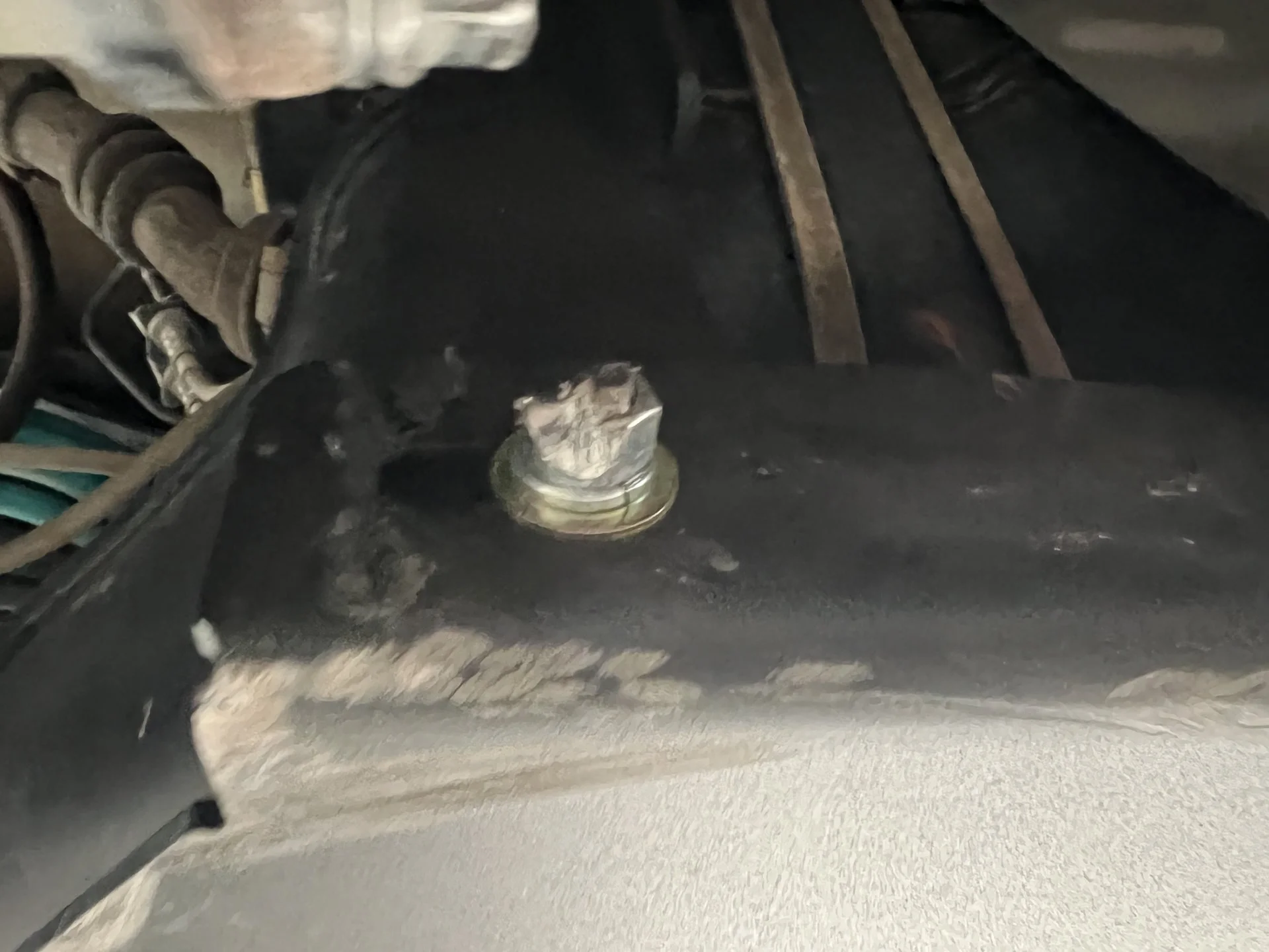

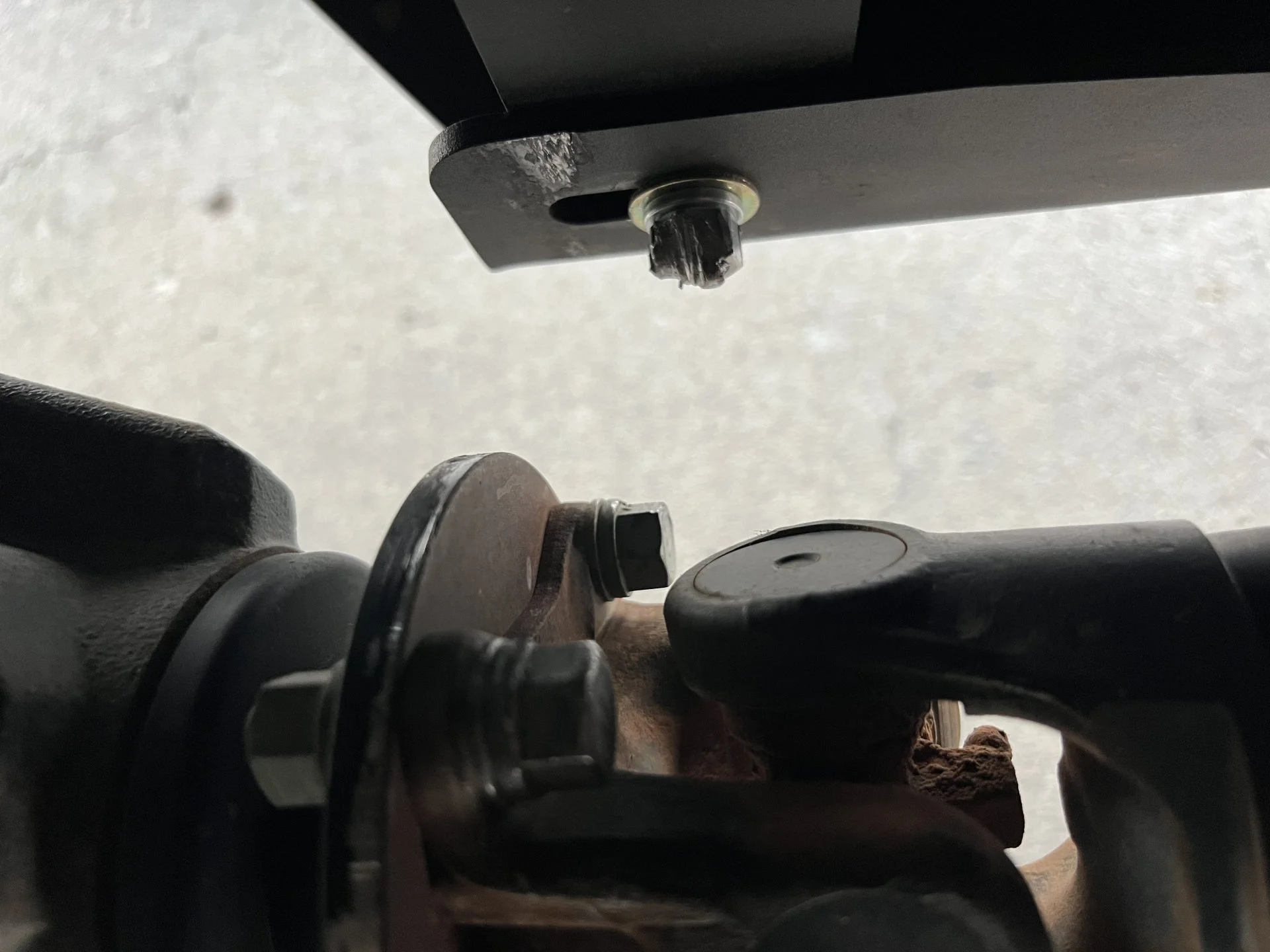

Yes they may have been on but can’t say for sure in what settings this happen. Upon further inspection this morning I found it hat my drive shaft was contacting a bolt for my fuel tank skid plate at full stuff and had ground it off a bit. The drive shaft was slightly hit but it did a number on the bolt for the skid. Thanks for checking in and asking. Hope this helps someone in the future running skids on gx460’s and 4runners. Apparently there is enough movement of the drive shaft under articulation that this can happen. Looks fine on install it though.

That explains it. Do you have the stock rear control arms and panhard setup? I'm curious if your lift has changed the position of the rear axle enough to induce this or if the skid-bolt is just too long. Either way this is probably a quick fix with an angle grinder/cutoff wheel to the excess bolt length.

Stock control arms upper and lower. Have the eimkieth kit for pan hard bar angle correction, more than enough bump stop additions to help but also have the long travel setup all the way around if that makes a difference. The skid comes with a carriage bolt and is apparently supposed to be installed with the rounded side towards the drive shaft thus eliminating the major unnerving sound and and clunking of bolts hitting bolts. Thats on me as I was more concerned about the bolt hitting the fuel tank. There is plenty of room between the tank and bolt when reversed upon further inspection and per the maker of the skid plate. There still my be some rubbing at full stuff but should be smoother if any contact. As for how it looks when installing it there is plenty of space and the drive shaft movement is known for gx’s and 4runners and some have even trimmed the skid plate due to contact. Hopefully this helps someone else not have an oh s#%t moment on the trail.
