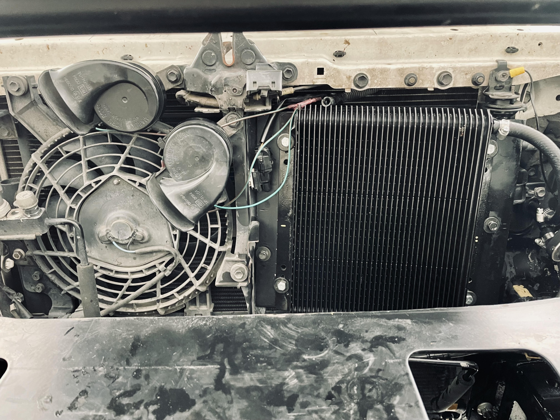

I did upgrade my cooler to a Tru Cool cooler after flushing the fluid and keeping track of the temps with the ScanGauge. I'm also on 33s and keep it in 4th while towing and around 65mmph.

Super easy to do the flush yourself, just messy. I also just made a couple of brackets to fit the cooler.
Clean install and looks like a good mounting option as I have an aftermarket bumper.
Any chance you have a link for the cooler?
This is the exact one I ordered. Fit perfectly in that spot. I just had some scrap metal laying around and marked holes to match up to the existing core support.
