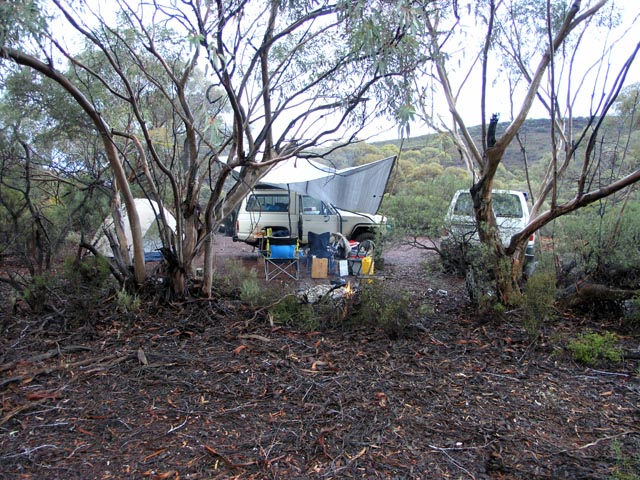

Works great for those damp days when camping. You can adjust the side over hang to block some wind if needed. A deluxe setup versus my typical oz setup (where I do have a h/d rack on my 4wd)
and the following. In this case we purposely created a V in the tarp to collect rain water - not much standing water in the oz bush.
