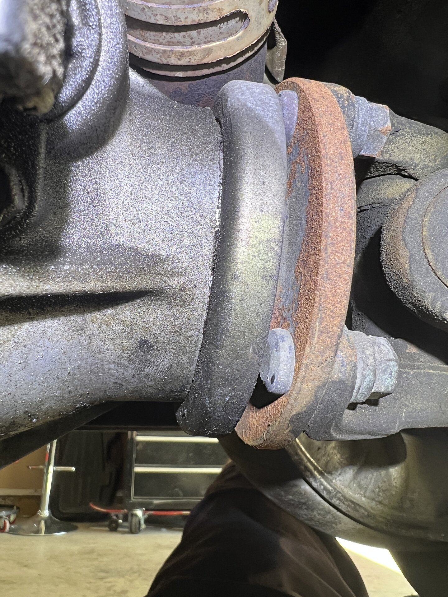

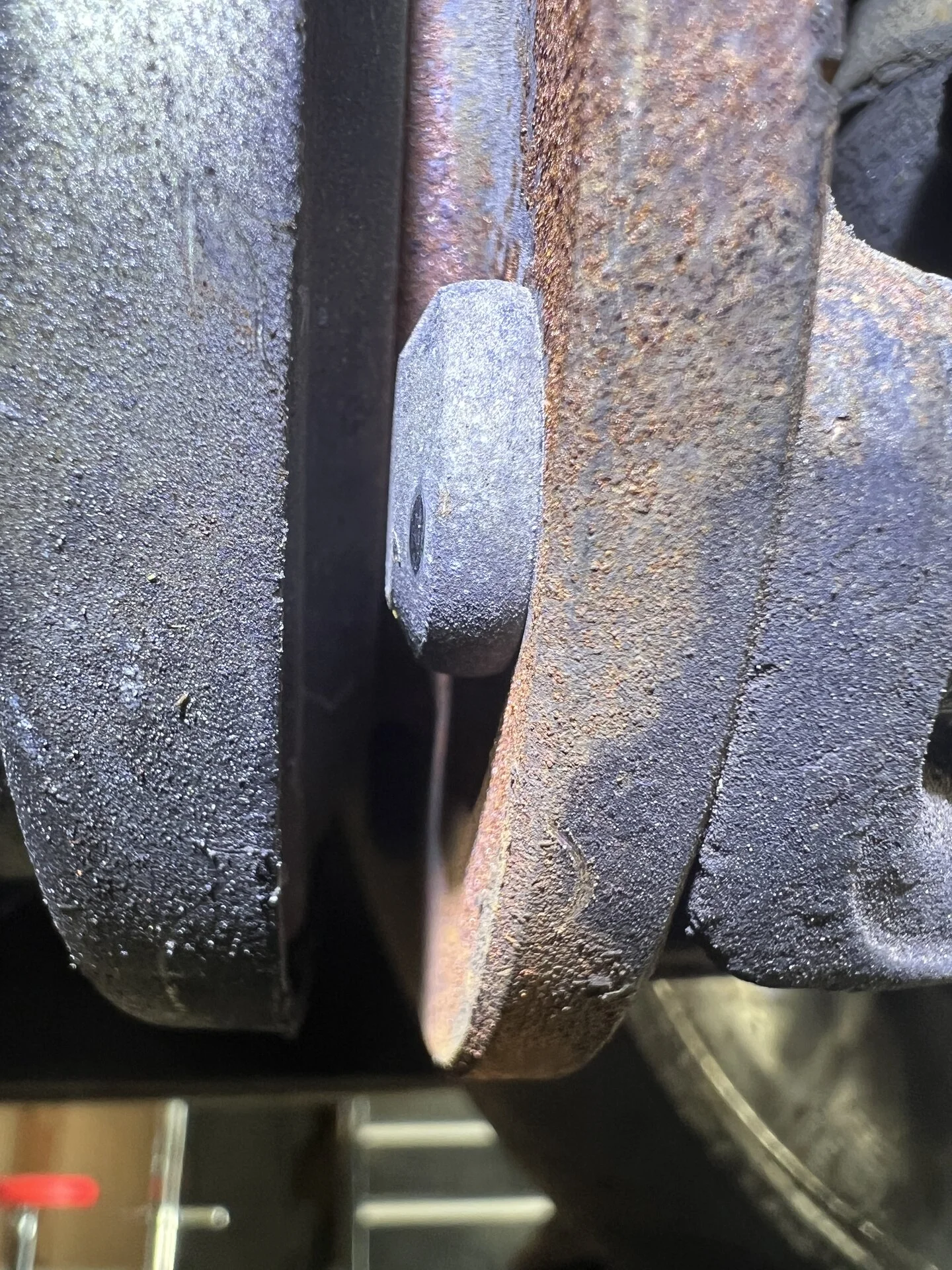

SOLVED! Spent hours looking around for any signs of scraping, checked the u-joints, engine and transmission mount, and pulled apart the brakes. Went back under one last time with a clear head and found the culprit. There is a little plate on the back of the tcase where the rear drive shaft connects, and it looked a little off. I noticed the bolts attaching the rear drive shaft had fresh TINY scratch marks where it looked like it had grinding against the plate (pics attached). It had a few tiny rocks in between the plate and t-case, so I got those out with a flathead and carefully pried the plate back flush against the t-case. I'm guessing it was knocked loose when I was off roading or maybe just over time it started popping out. This would make sense why this was torque related I think and it would barely rub that plate and DS together. Also makes sense on why it sounded like something scraping against a circular plate. Hopefully this helps someone in the future. Cheers, and thanks for the help!
