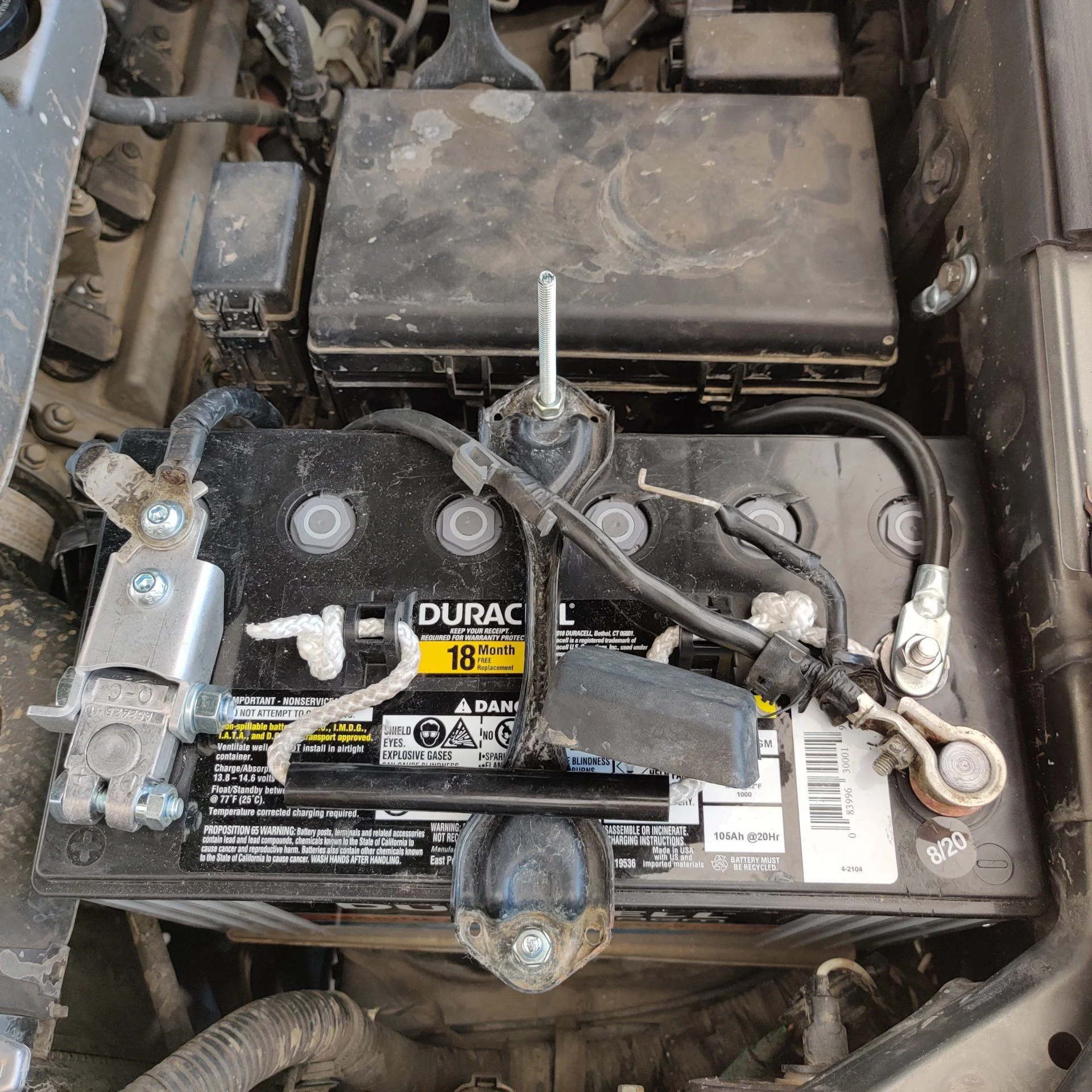

I got a Duracell 31agm battery to fit with minor work. I'm using the slee military terminals. I found that different brands have varying dimensions even though all are group 31.
For positive, I removed the the ring and used the eyelets for positive and fuse box cable. For negative, there was enough extra slack in the harness to work without military terminal. Then I got a new 4gauge wire for ground as well as longer j-hooks. Eventually, I will redo the negative side with military terminal as well. Hope this helps!

@Khnguyen714 thanks for the picture. That is really helpful. I got a custom terminal that extend the positive a bit. You are exactly right that the terminal location are not the same for all group 31. The one I am looking for are around 3.77" from the edge. My current positive terminal are about 3.5" from the edge. I think I can copy your negative arrangement.

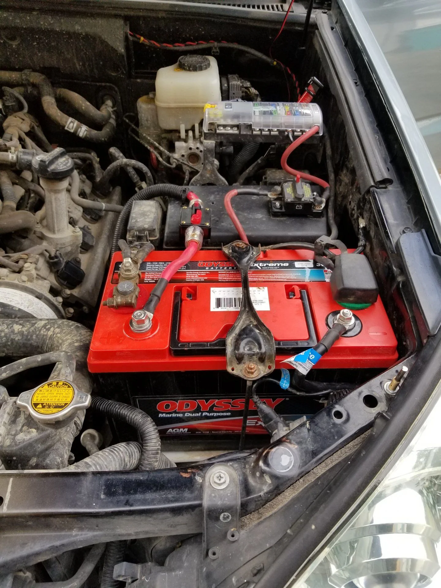

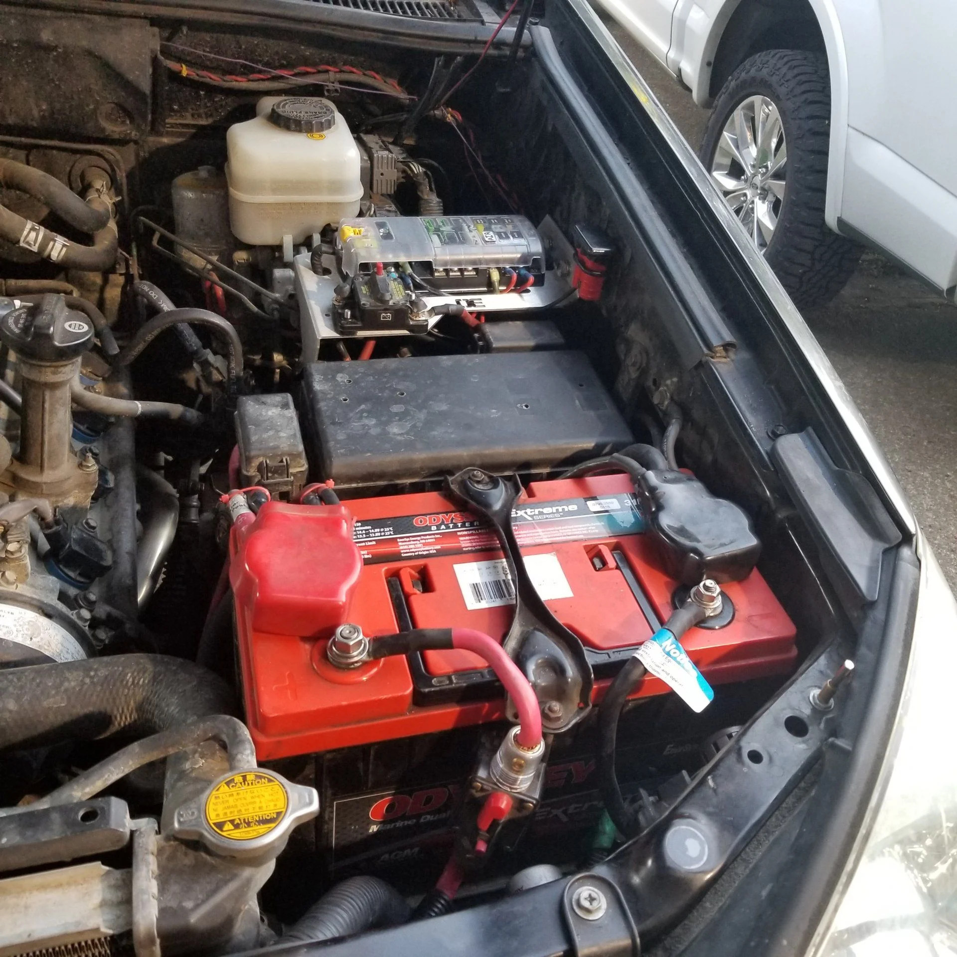

Group 34 Odyssey
Pictures show my initial and current set up.
My final solution was making new cables from welding wire. It's incredibly easy to do. The cable has finer copper strands, it's more pliable and conducts better.
Prior to running these cables, I just got all the slack from my negative cable from the engine block and frame, then drilled a new hole for the inner fender ground cable. I ran a 10mm bolt through the hole and had no issues. I was able to position the cable close enough to hit the terminal with no issues.

It looks like the post is in similar location between Odyssey 34 and Northstar 31M. So it looks like I would be able to do similar to your initial setup to get me going.
