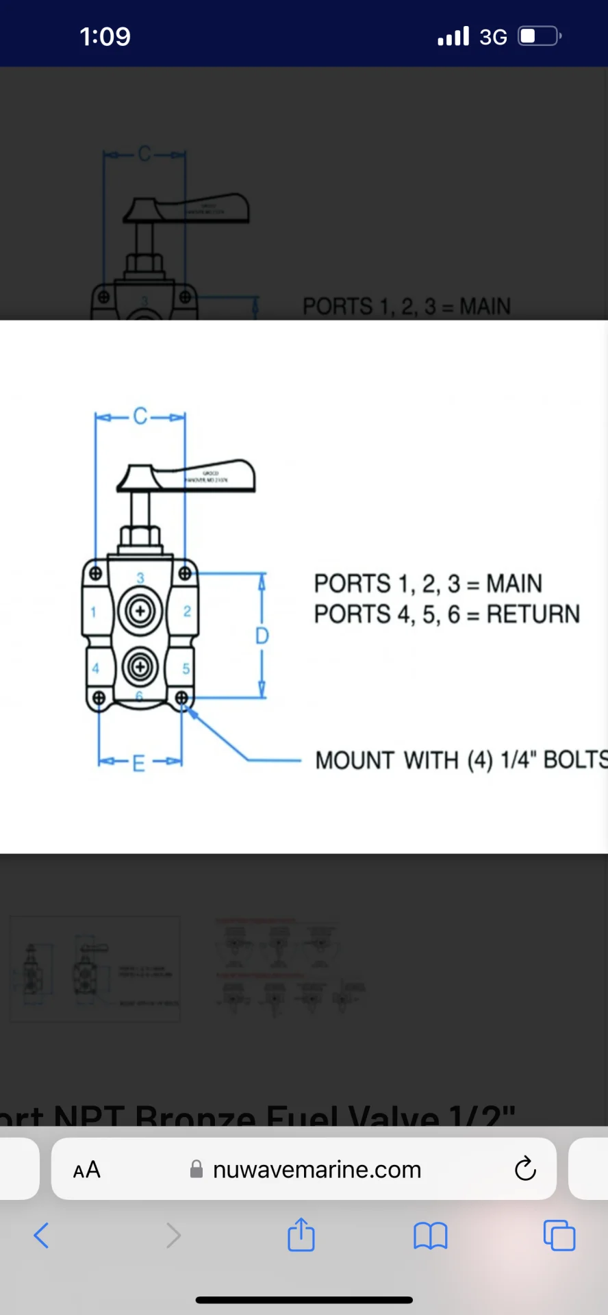

Has anyone installed installed the Groco 6 port manual fuel tank valve for dual tank. I am looking for a detailed installation drawing. More details than the picture below.

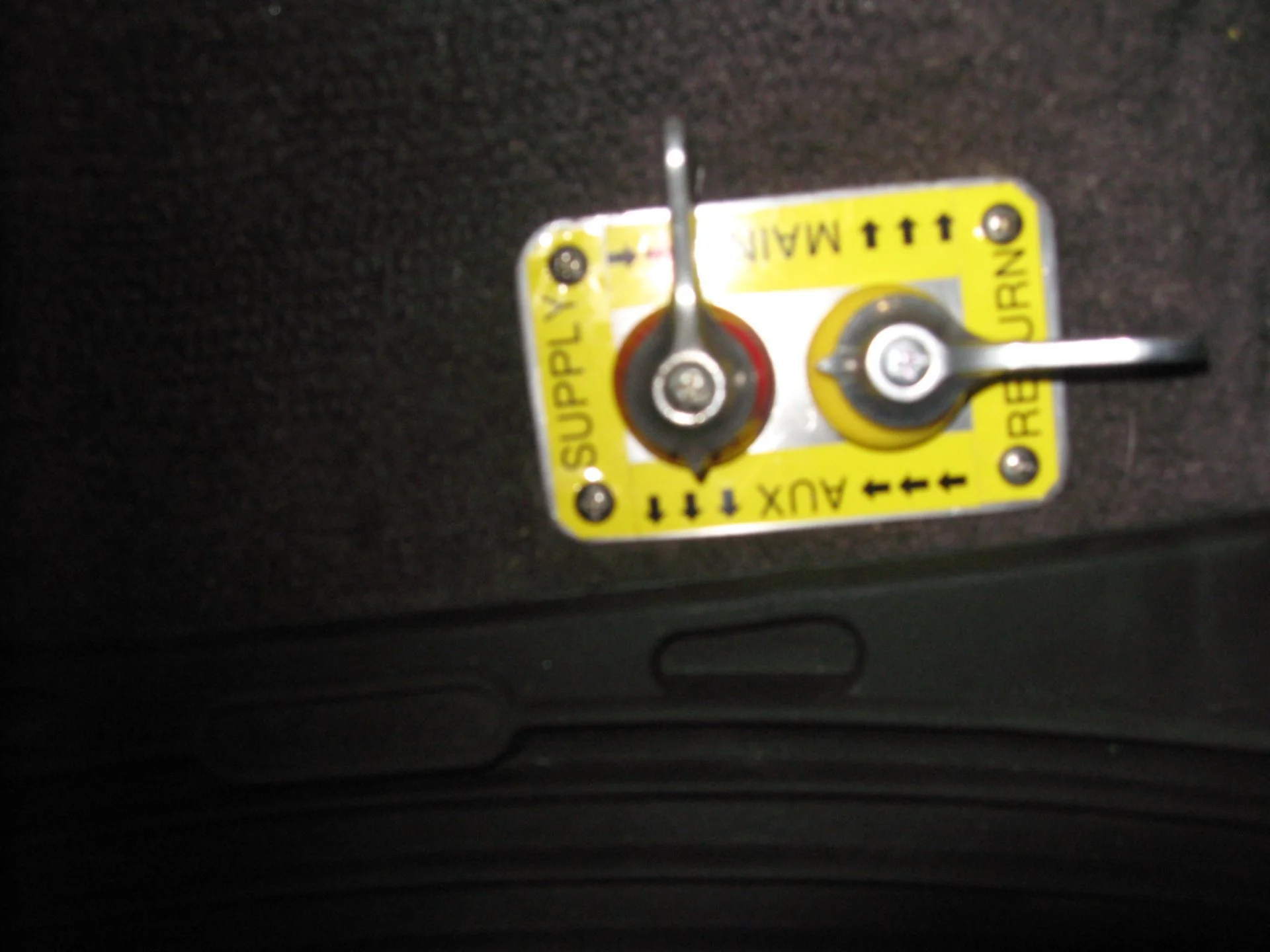

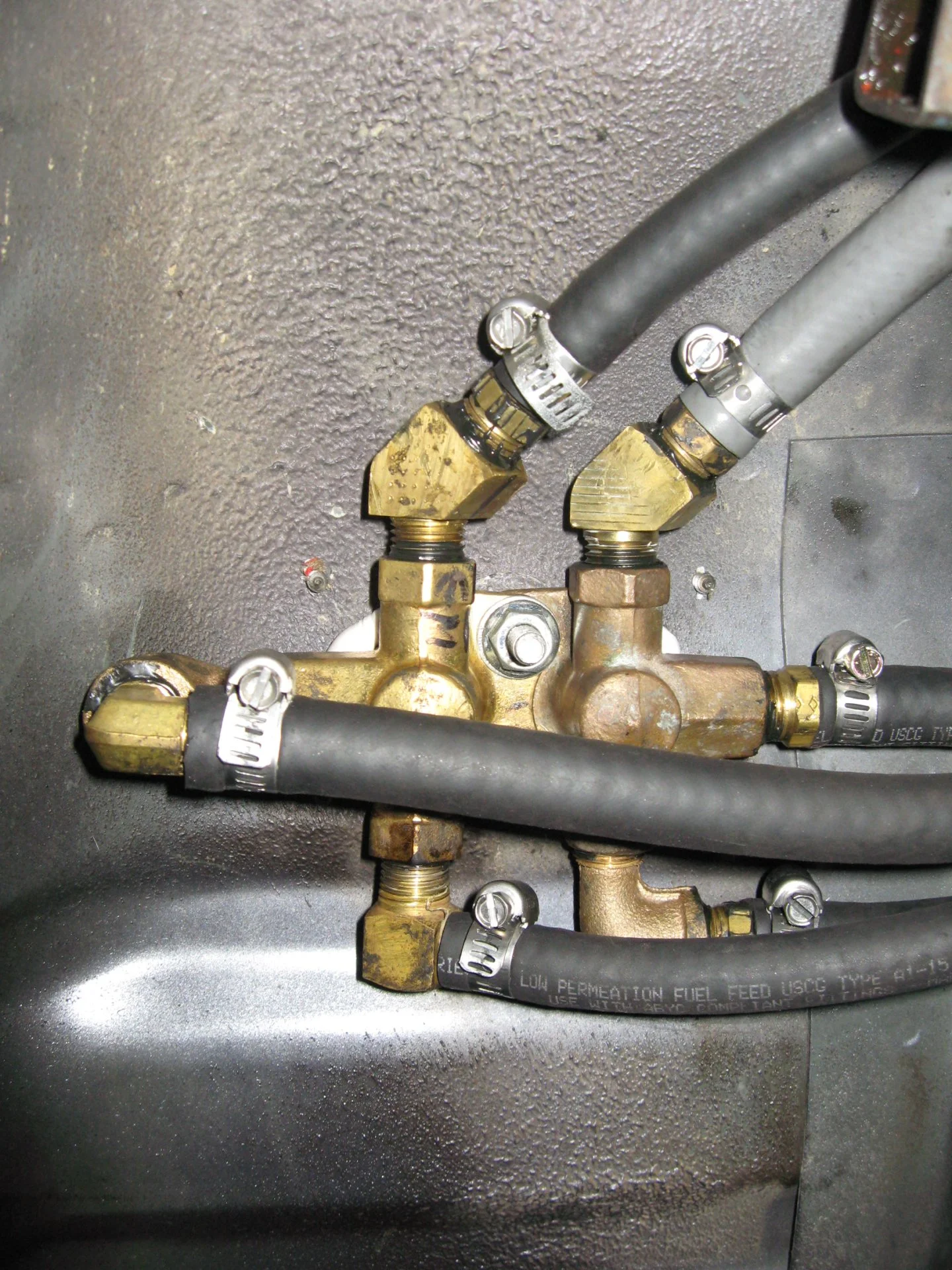

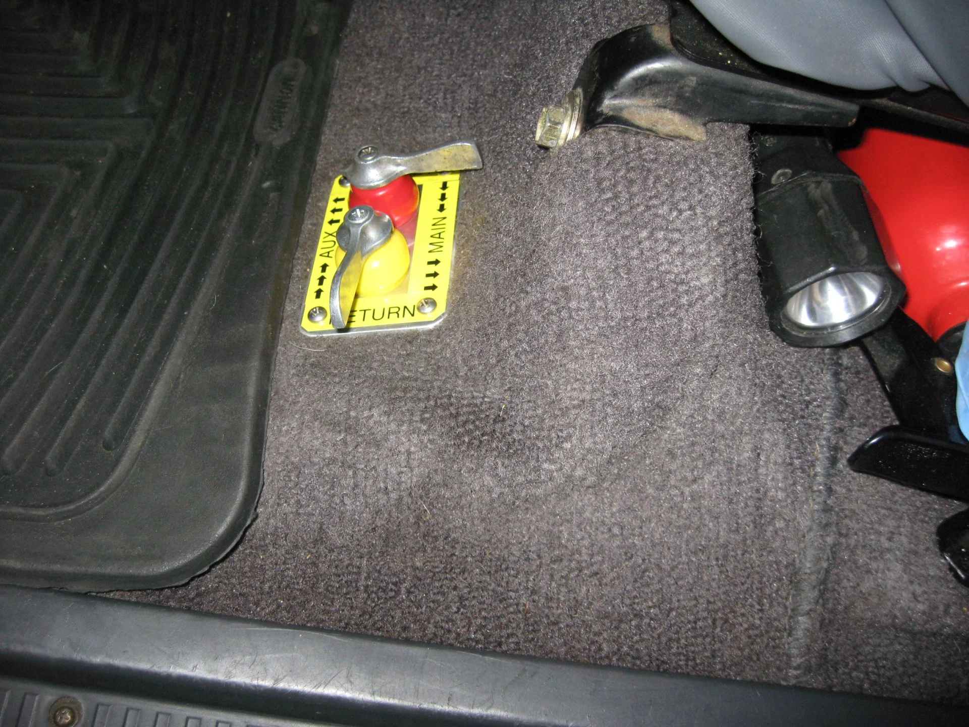

I looked at those for my dual tank setup, but the vertical mounting was a problem. Here is what I did:
