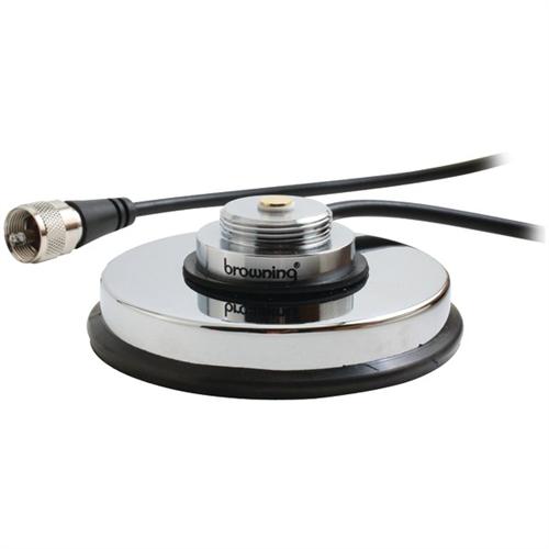

I assume Rhino Rack originally designed this folding mount for CB antenna applications so I'll have to enlarge the antenna mounting hole to ~19mm for the NMO antenna base. I found a lot of info on the NMO base here...
NMO was designed with keeping the best possible impedance match between counterpoise and the antenna. To add in only a small bit of vendor flair in here, we could not use NMO (I did try) with our radome antennas, as the moment generated by the vehicle to the aerial was too much for NMO, and therefor requiring a sturdy spring, and therefor no NMO. If you want a different approach to an antenna, check us out: Login • Instagram - http://www.instagram.com/alamosaantenna/
