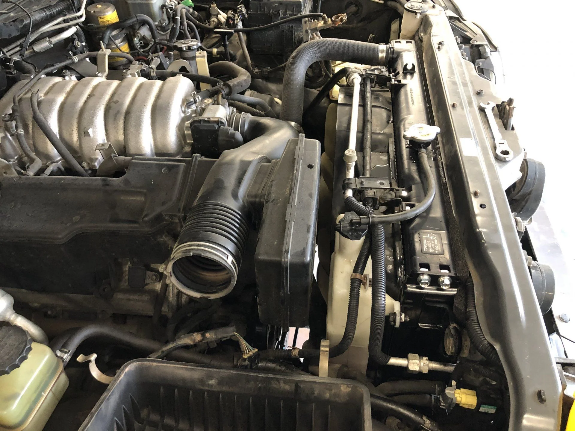

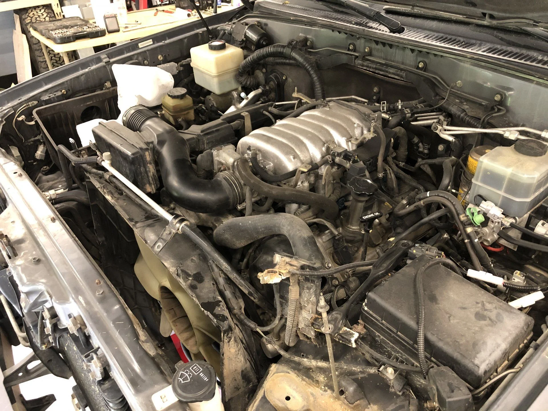

Some pre-vacation maintenance pics from a few weeks ago. Just under 250k mile at the time. The original radiator finally let go at the bottom tank/core crimp. Glad this happened before the trip and not during. Also had a DS cv making noise. A big thanks to Lewis Toyota of Topeka who not only had the best price in the country on OEM radiators (order online) but had it the next day.

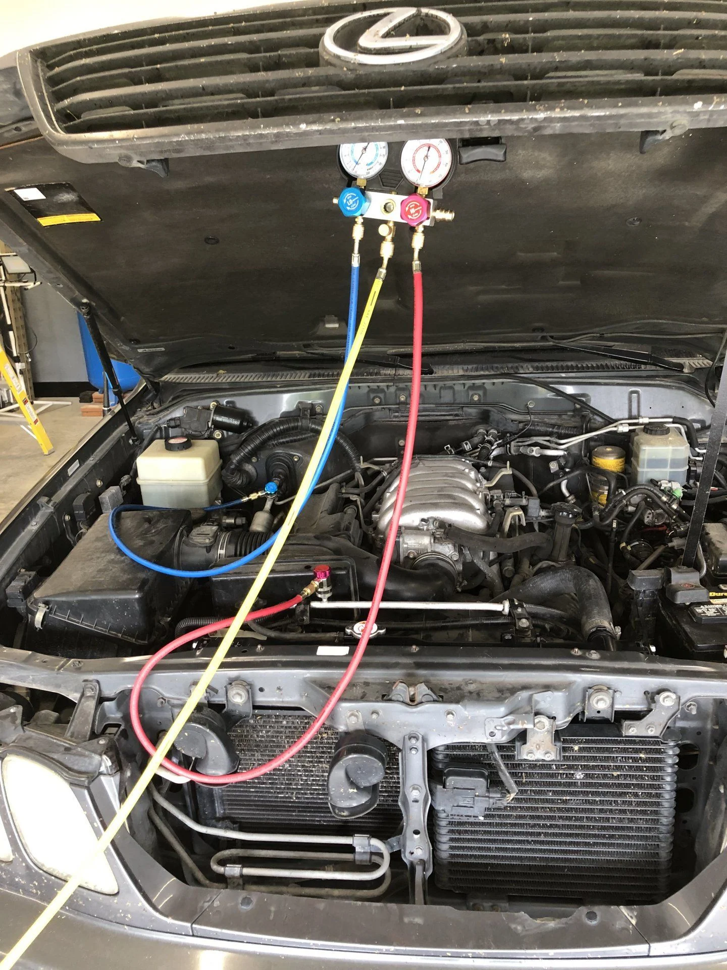

I have also struggled with the AC in this rig since buying it. It will not hold a charge for more than a few weeks at a time. Have ran dye through it, sniffer on all the lines, to no avail. I finally figured it must be the schrader valves as the rig will hold vacuum overnight. That was also the only place I would find dye and they would consistently give off a hiss of gas when I pulled the caps off. Replaced with JRA valves and used Nylog blue for a little extra seal. I also replaced the factory desiccant bag. Charged with 38oz of gas.
