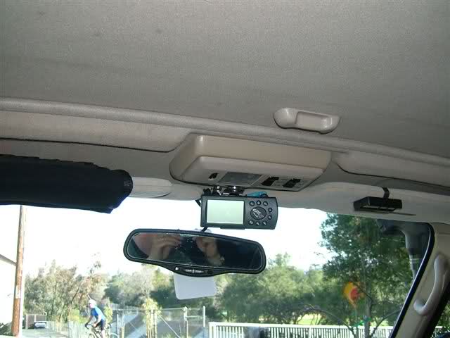

GPS mounting
Phil, there is no mount. I looked into making a bracket but the GPS hangs down too low blocking rear view mirror. When the GPS was dissasembled, a put 2 #4 bolts through the GPS housing to act as mounting studs. The roof console was then drilled to match the studs and the GPS was bolted directly to the console.
Bob, I made an BNC cable that I ran down to the lower Rt side dash and use the stock Garmin atenna. The cable is like an extension cord, as the stock antenna will plug right back into the unit. Both the power cord and the antenna can barely be seen while pugged in and there is still room behind the GPS for my Radar detector. The only issue is that I had to move the visor pin holders towards the windshield about 3/8". No big deal. Looks fine. Allows the visors to work normally with the GPS mounted.
Sorry this is such a simplistic question but i am going to do something similiar with my GPS V very soon. Ive tried taking off the console around the sunroof controls and lights by removing the screw and trying to pry it off but it didnt budge and i didnt want to break anything. Howd you remove the console?
Maybe I missed something, but why is it upside down? here's a pic of my dad's:

That's nice. Personally I like the CB antenna mount and this idea. These options are what make each cruiser unique.
