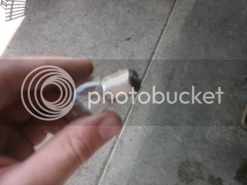

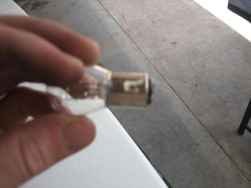

take a 1157, grind the higher locating tab off
before:
after:
make sure you leave the lowest tab in place
solder the 2 contacts together, this will make both filaments flash at the same time fixing the fast blink issue
