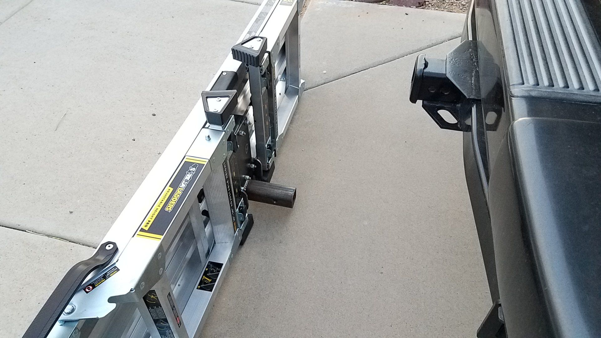

I recently obtained a RTT which is amazing but I'm too short (6'1") to reach it effectively to deploy and repackage it effectively. Standing on the sliders and tires is a PITA and I'm still too low or too far from where I need to reach most of the time. I ended up buying the fantastic Gorilla Aluminum Pro Slim Folding Work Platform which raises to 4x adjustable working heights - 20", 23", 27" and 30". It also triples as a stool for the tent, a very stable and heat resistant table for camp food prep and an awesome bench. It has stabilizing legs that extend about 6" on either side and has a 300lb capacity to boot! I can't say enough good things about this ladder except that it's big. It's about 55"x14"x7" when folded which is too long to fit anywhere on my truck. So, after drawing up some ideas, my fabricator made up a simple steel bracket that goes into my receiver and it's all bolted to the aluminum Gorilla platform's tread. It's very stable and not too much added weight.
It works great and the clearance isn't an issue. The only problem is that there's a plastic bumper that goes around the Gorilla that is directly behind my exhaust pipe and it melted and distorted. The aluminum platform is fine but the plastic, not so much. I'm not too worried about the plastic but it's an issue. You can see on that last pic where it's melted.
Link: Gorilla Ladders 55 in. x 14 in. x 30 in. Aluminum Heavy-Duty Adjustable-Height PRO Slim-Fold Work Platform with 300 lbs. Load Capacity-GLWP-55A - The Home Depot
Here's some pics of the bracket it self. Pretty straight forward. The main plate has a couple of gussets to prevent tweaking and has 1x2 channel acting as solid spacers to fasten the platform to the steel bracket. I originally requested aluminum plate welded to the platform but was unaware of how brittle aluminum can be and decided to go with a steel bolt on design.
The receiver tube isn't in the way when deployed.

I'm planning on replacing the bolts with rounded bolts, similar to a simple carriage bolt.

Received the mount back from powder coat. I think it turned out pretty nice and blends with the aluminum well.
