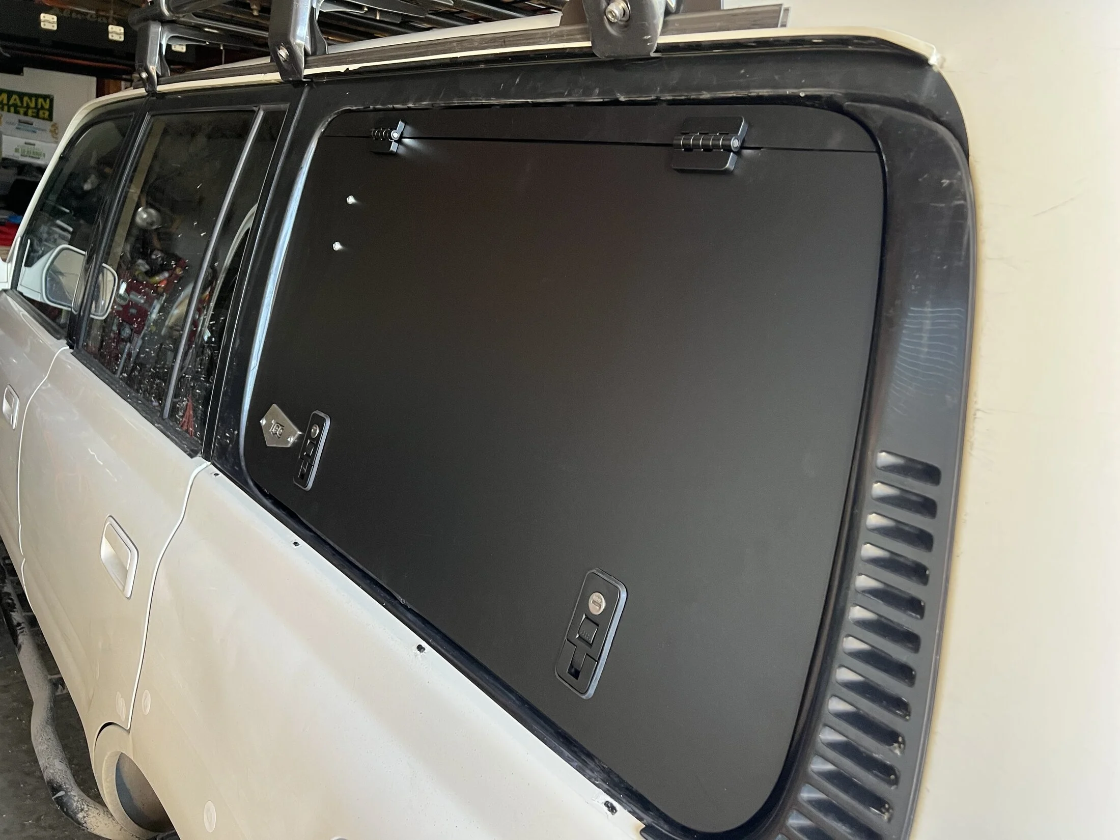

I picked up a gullwing window and need to install it. The instructions say to use mastic between the frame and body. I imagine that is a trade terminology for sealing goop, but I don't really want to have to redo the project because I used the wrong stuff. What is a good product to use?
I used DAP Dynaflex Ultra window door siding & trim sealant to seal the bolt holes on a roof rack at one point. Would this be considered mastic and good to use for the gullwing?
My goal with this mod is to be able to access the molle panel on my Bellfab v2 tire carrier. I'm thinking this might be a good location for quick access to some recovery gear.

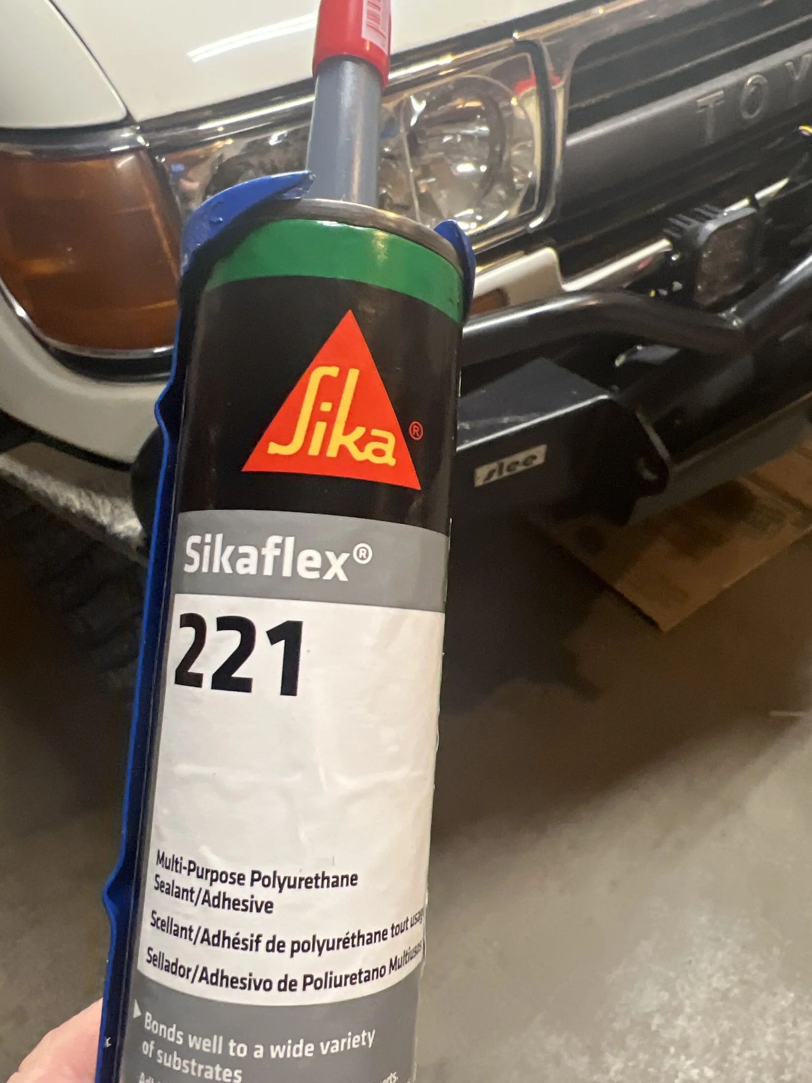

Fyi, they recommended Sikaflex, which I used with success. Messy stuff...
