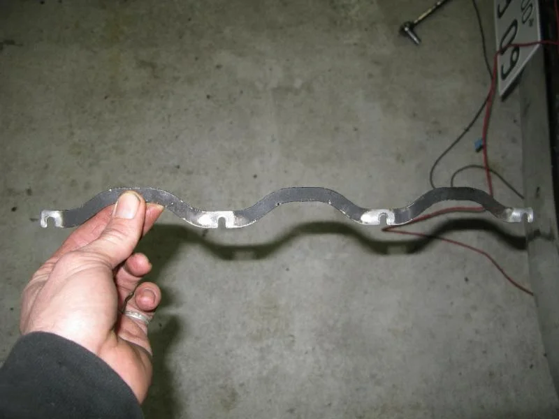

.. I wondered if maybe there were contact issues at the glow bar as the nuts under the buss are smaller on the new plugs. I followed Tom's example and put nuts on that would give more contact. I thought surely I'm good to go. But still nothing at the glow controller. ....pete
It only takes one plug not making proper contact to cause the controller to stop glowing.
And the big danger here is that while you may feel comfortable that you're not likely to fry anything since your controller isn't glowing ... in fact the opposite is true. Those plugs that are making proper contact with the busbar will now be being fed with EXCESSIVE voltage. And this coupled with the extra glowtime (as you try to get your controller to glow) - is likely to make you destroy some plugs. (I believe this is what happens to the "glow plug serial killers" on this board.) The reason this happens is because the controller glows using the COMBINED current of all 4 plugs (or 6 in the case of an H engine). However when 1 is taken out (by poor electrical contact with the busbar or whatever) there can never be sufficient current to get the controller to glow readily. Yet, because the plugs are connected in parallel, taking one out of the circuitry actually forces the remaining plugs to draw current in excess of what they are designed to take (by exposing them to greater voltage than they were designed to take).
Anyway .... after that warning/sidetrack .......... How about some photos so we can see the condition of your busbar and your busbar-plug connections Pete.
The contact surfaces need to be clean and the nuts need to clamp the busbar firmly.

Well- actually the truck starts fine with these plugs. And I have the same concern as Tom stated i.e. meltage.
I double checked the connections and did just as Tom using the wider flange nuts to insure a good solid connection. The Buss bar- while not as spanking clean as Tom's- has been cleaned well at the points of connection and works fine with the original plugs. I am sure of there is no issue with connections.

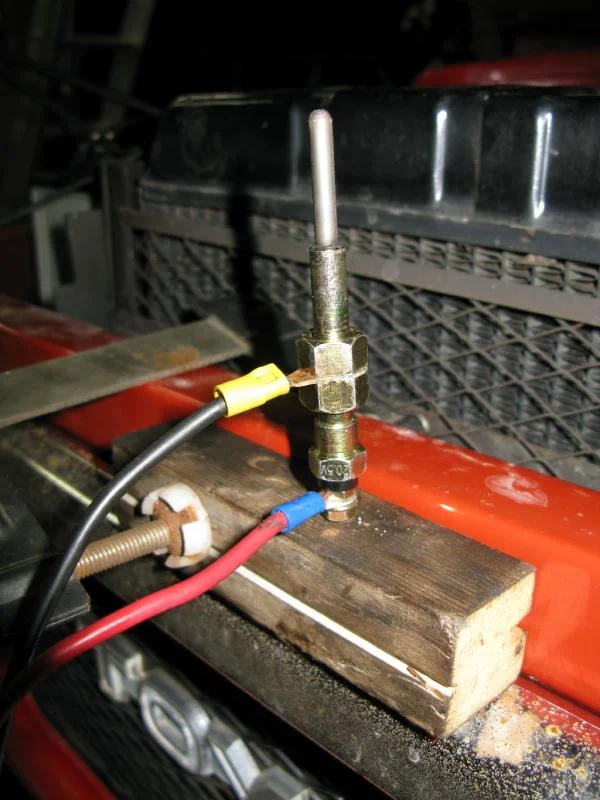

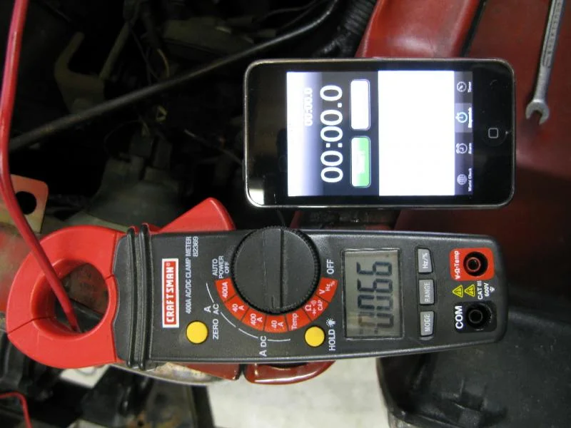

Ok- so I have done some bench tests etc to really find out if this is a problem with these plugs or something else. I tested the plugs to see how many amps the pull respectively at 24 volts by connecting them directly to the batteries. This eliminates all other possible variables and we can see side by side how these plugs differ.
First I thought I'd put up those pics I took of the buss bar to show that it is clean and in good contact. Basically all the plugs like just like number 4 in terms of contact:
I don't know how to post pics within text so I'll just write everything and pit the pics at the bottom. The first pic shows the set up. I had to take the nuts off of my PTO winch mount because I don't have a collection of fine thread stuff yet- still new to cruisers!
Then a pic of the plug in an "insulator" clamped to the front of the bib. Each lead was bolted to the battery lead clamps and the test was initiated by putting the positive clamp on the battery nice and tight. The amp meter was testing on the positive lead. As they heat up the amperage varies greatly so I has to time the tests and get readings close to the same timing.
