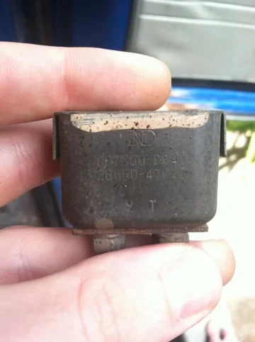

Hey all,
I'm sorry I don't know the exact name of this piece I'm having trouble with, but I'm hoping the pictures I attached will help.
This is on my 1980 Hj47 with H2 engine.
I was driving the other day, when the glow plug relay in the dash automatically activated and started glowing. I assume it was some sort of short in the wiring, but I didn't noticed it until it had started smoking. I panicked and hit the button again to activate the glow plugs and it shut off.
Now, the engine won't start, so I'm assuming that this part burned out and now the relay is incomplete and the glow plugs cannot start.
I'm wondering if anyone knows where I can get another one of these parts? I'm struggling also because I don't know the exact name of it. I'm also wondering if anyone has some insight as to why this could have shorted randomly. It was kind of scary.
If this helps, the part has the following letters/numbers on it:
ND
067200-054028550-4740
Pictures:
Thanks for the help guys.
hi,
it is a 28550-47021
Dash Glow Plug Controller Toyota Landcruiser 40 Series - HJ45 & HJ47
http://shop.allfourx4.com.au/Glow-Plug-Controller-Toyota-Landcruiser-40-Series-HJ45-HJ47
I dont know why the engineers decided that incab glowing was the same as inengine, really stupid unless you light cigars with it.
If you look at the bolt that thing is a lot of amps, I think an amp meter will also work if you know the range it operates.
That thing sucks the battery for sure, attach wires from glowplug to cab with a 24V (or is yours 12?) lightbulb and you have the same effect.
I dont have a wiring diagram for this but is the + directed to the engine and does this thing act as a fuse?

Sounds like you have some non-OEM wiring and a non-OEM preheat button there. And if so, I think that's likely to be where the fault lies that caused the preheat to activate by itself while you were driving.
And that site often shows items that are no longer available and that will NEVER be restocked.
Getting a good used glow controller is probably your best bet if that one's blown.
But if it has blown ... it suggests to me that you're probably running the wrong plugs (as well as having the fault that caused preheating to initiate by itself).

Hmmmmmmmmm,
I read 28550-47040
And should be available for around $70.=
As Tom said; is your glow system modified?
Rudi
Hmmmmmmmmm,
I read 28550-47040
......Rudi
Definitely the correct part number for a glow controller for a 1980 HJ47 there Rudi.
So hopefully Gromit can buy one new.
No harm in trying Toyota quoting that part number anyway.
(I don't know why I had the idea they were no longer available.)
:beer:
PS. With a glow controller you should be running 8.5V plugs Gromit. (However I have a suspicion you may be running 6V plugs instead. And if so, that would explain why your glow controller failed.
Only HJ47 models fitted with the "superglow" form of preheating should be running 6V plugs.)
