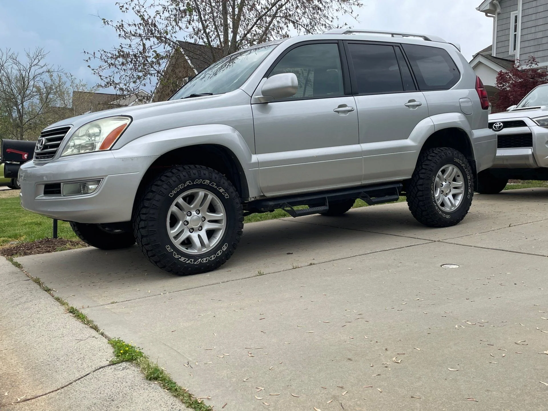

Here's the most recent pic of my GX for attention... and my 5th gen photobombing...
