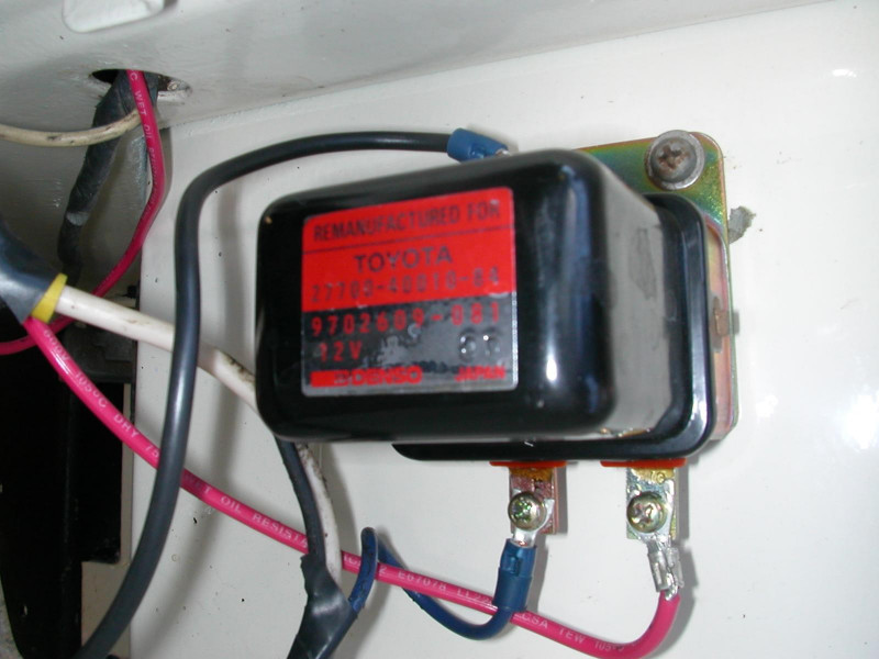

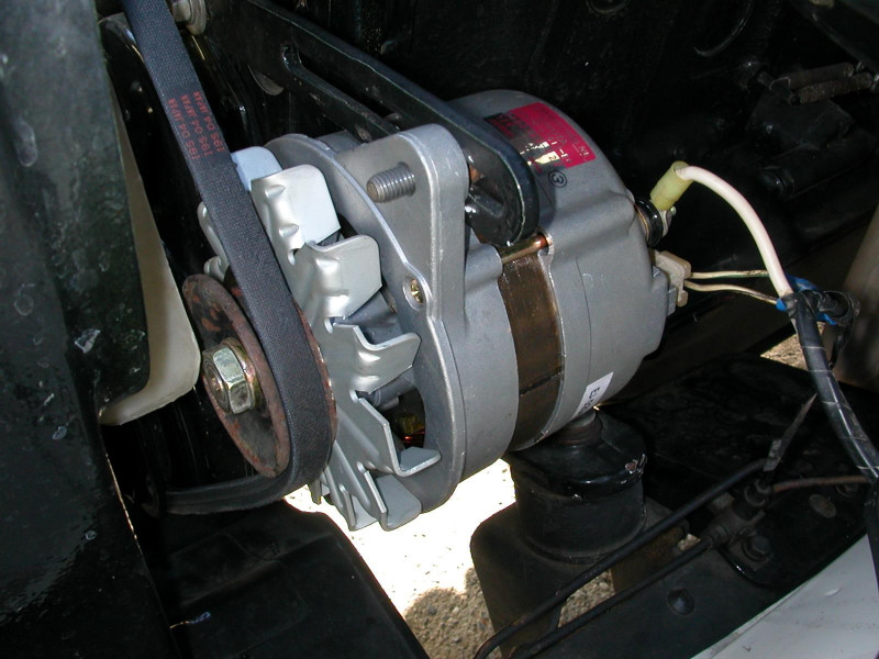

it was very easy on my 64 45lv, just got new Toy alt(took me 2 trys to get the correct on) and reg and replaced them, the holes were even on the firewall to mount the reg, took maybe 1 hour
