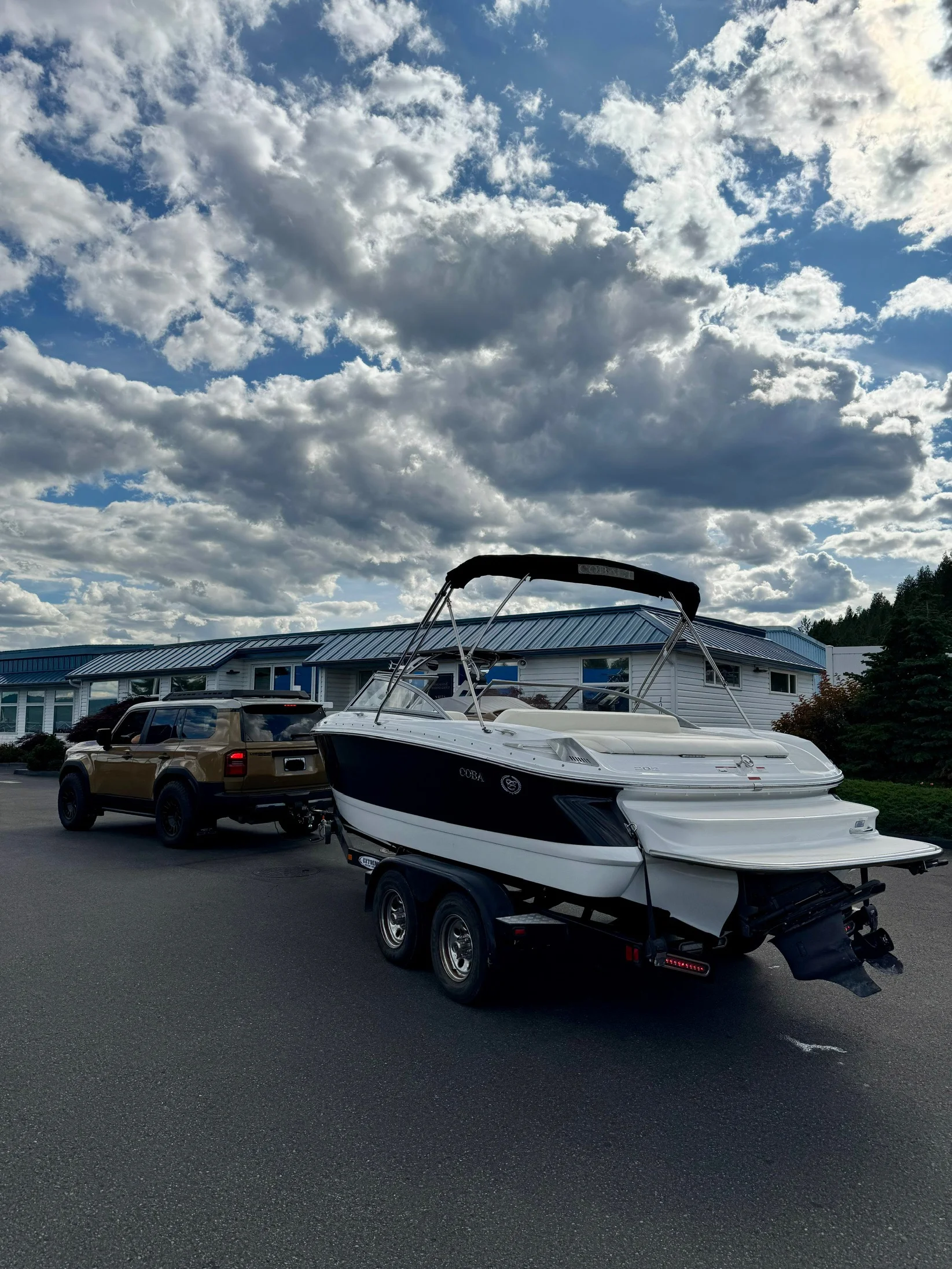

I have towed twice with the 250 my boat and trailer weigh around 5k and it’s a dual axle trailer with no brakes so I Just plug in the lights hit that button and the only thing is when I back the boat in it beeps but nothing crazy.

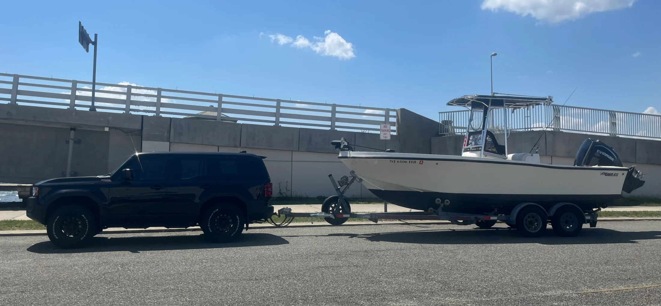

I wonder if the boat is far enough back that it doesn’t feel the need to slam on the brakes? On my 24’ deep vee boat, it sits quite a ways back, so the only thing that would be in close proximity to the sensors would be the tongue. The other trailers are straight across walls of aluminum only a couple of feet back.
