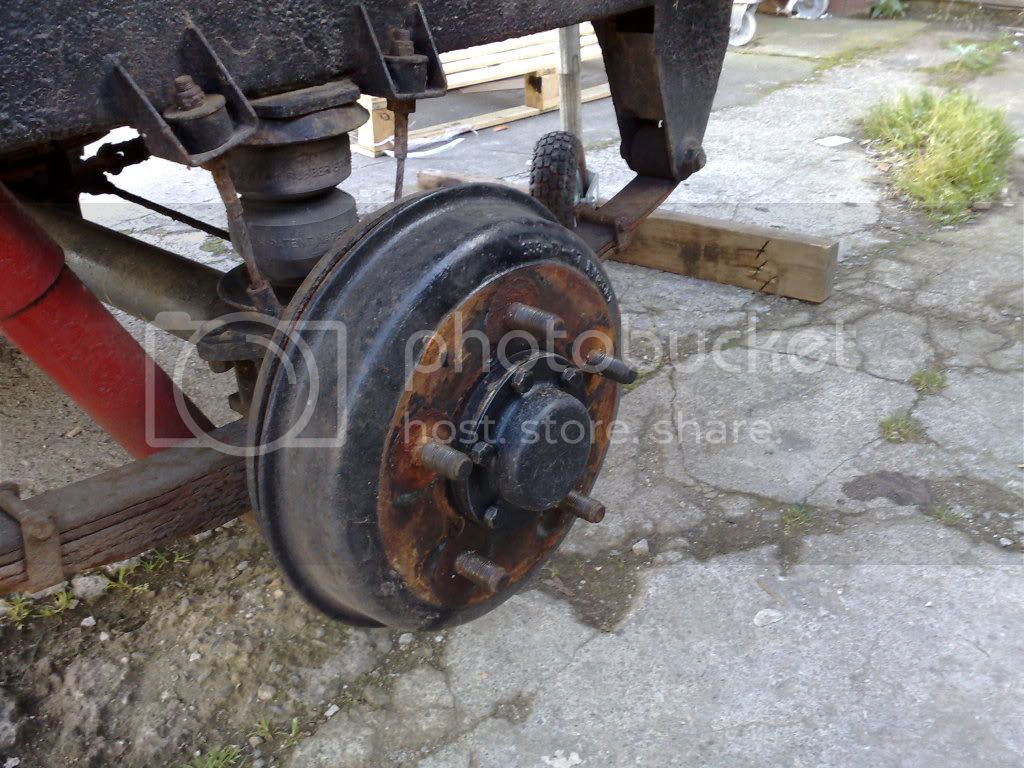

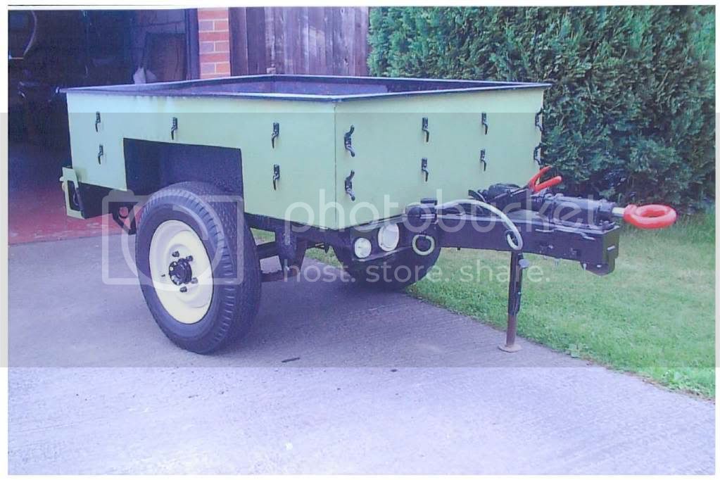

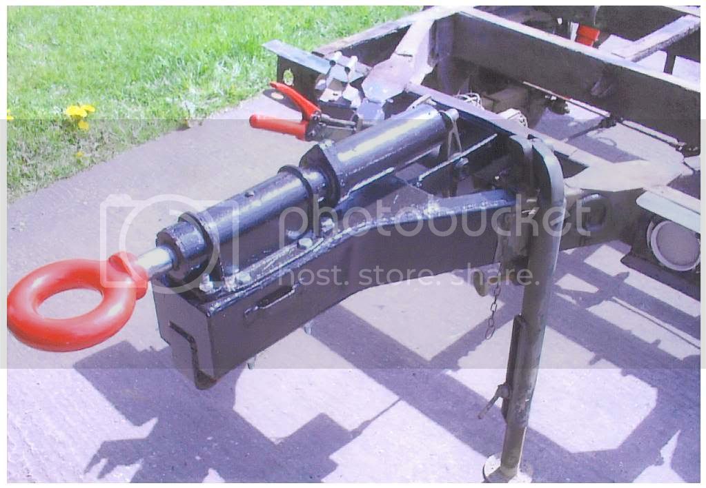

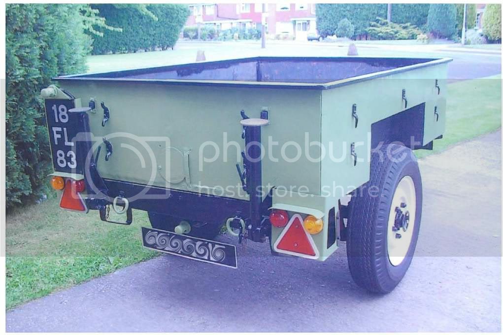

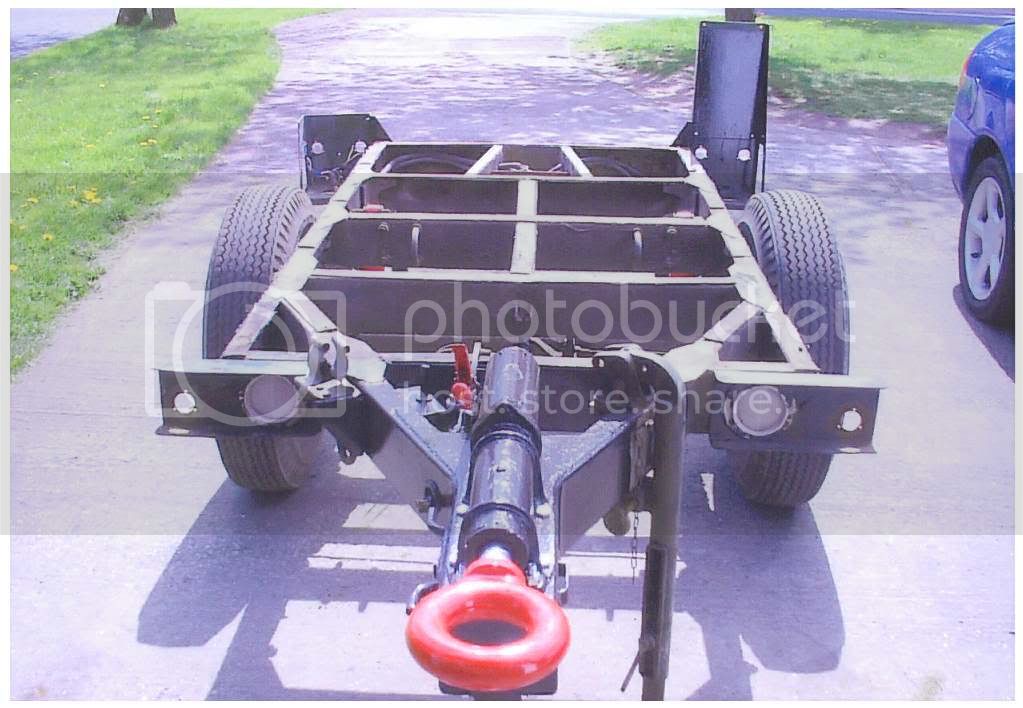

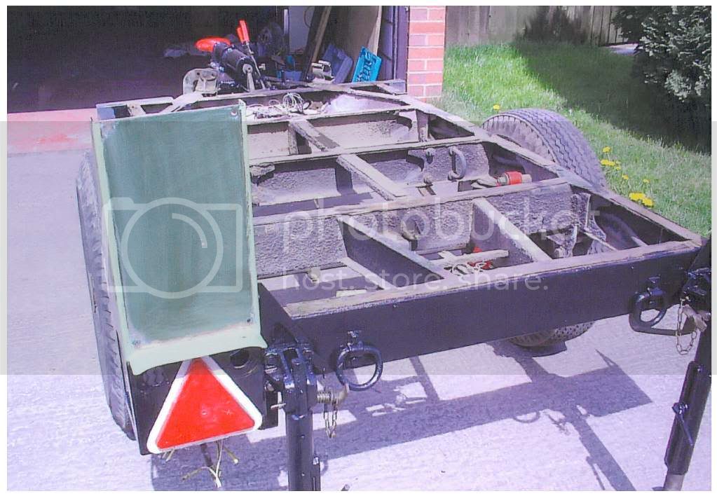

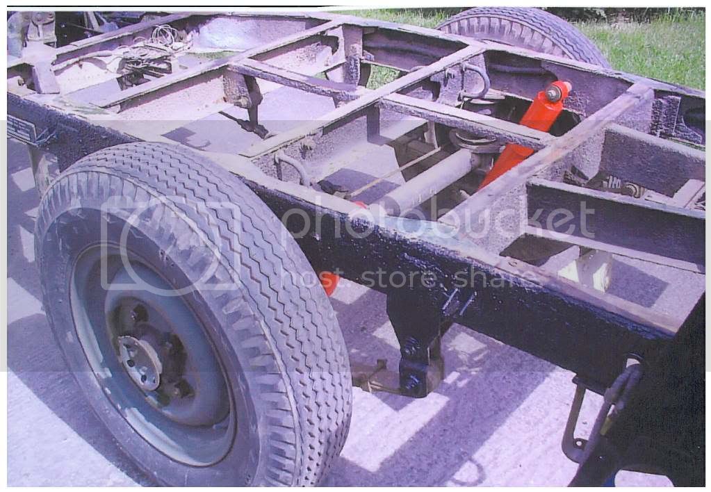

So it turned out to be a 1971 narrow track trailer that I got. The PO had undertaken a resto job on it & painted it to match his Land Rover. The pics below are of his resto work. It had suffered a wee bit since that but he'd done the electric conversion work to civillian plugs etc etc & seemed in relatively good order. It was priced at around the going rate so I bought it...
Pics
The frame:

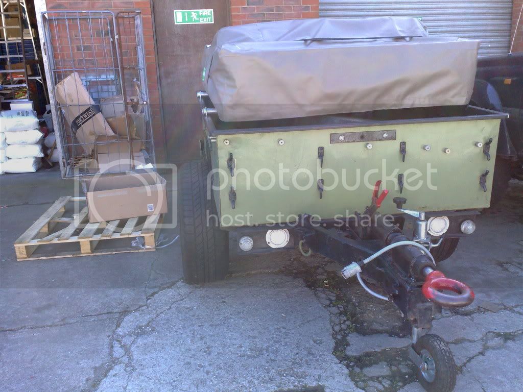

I used him to tow some junk to an offroad meet we have around here... I made a buddy a roof rack & test fitted his RTT on it for his road trip from UK to Cape Town. Rather than fit the tent on Muxley (too tall!!!) I mounted it on the trailer with a couple of bits of pipe from the stores in work - here we are in full expedition trim!!!
Looks great - wish I'd kept on driving!!! Matt & Lorien enjoyed camping in it on top of the trailer all weekend so at least I know its a good stable base if I am ever able to do something similar in the future - more on this later...

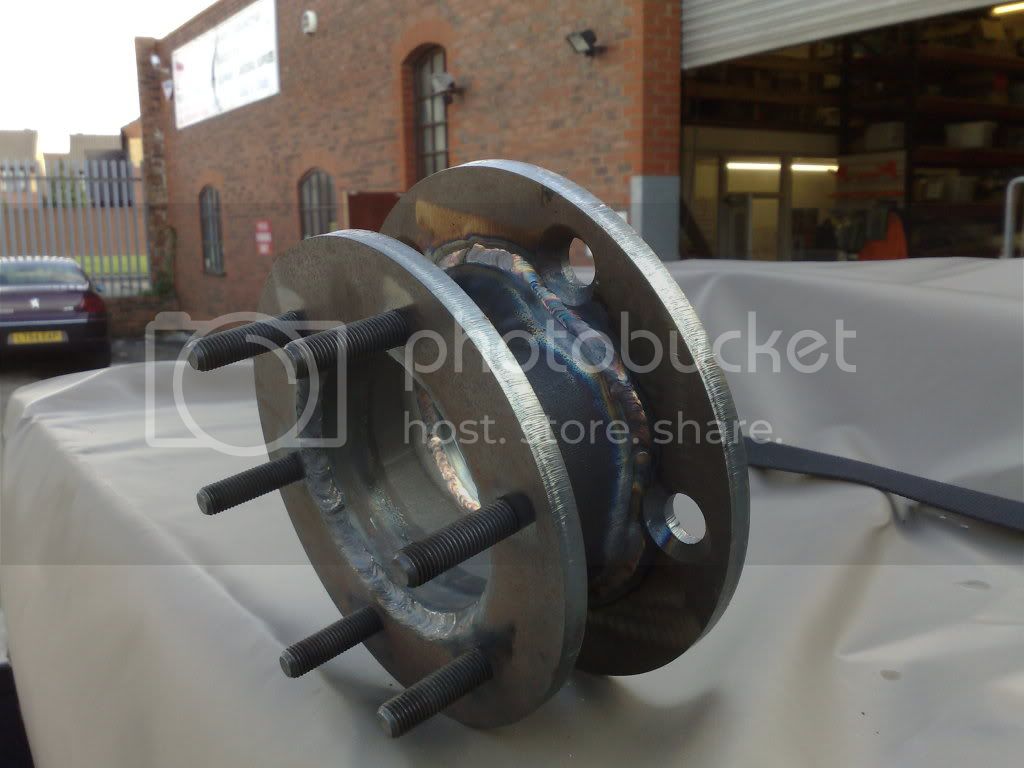

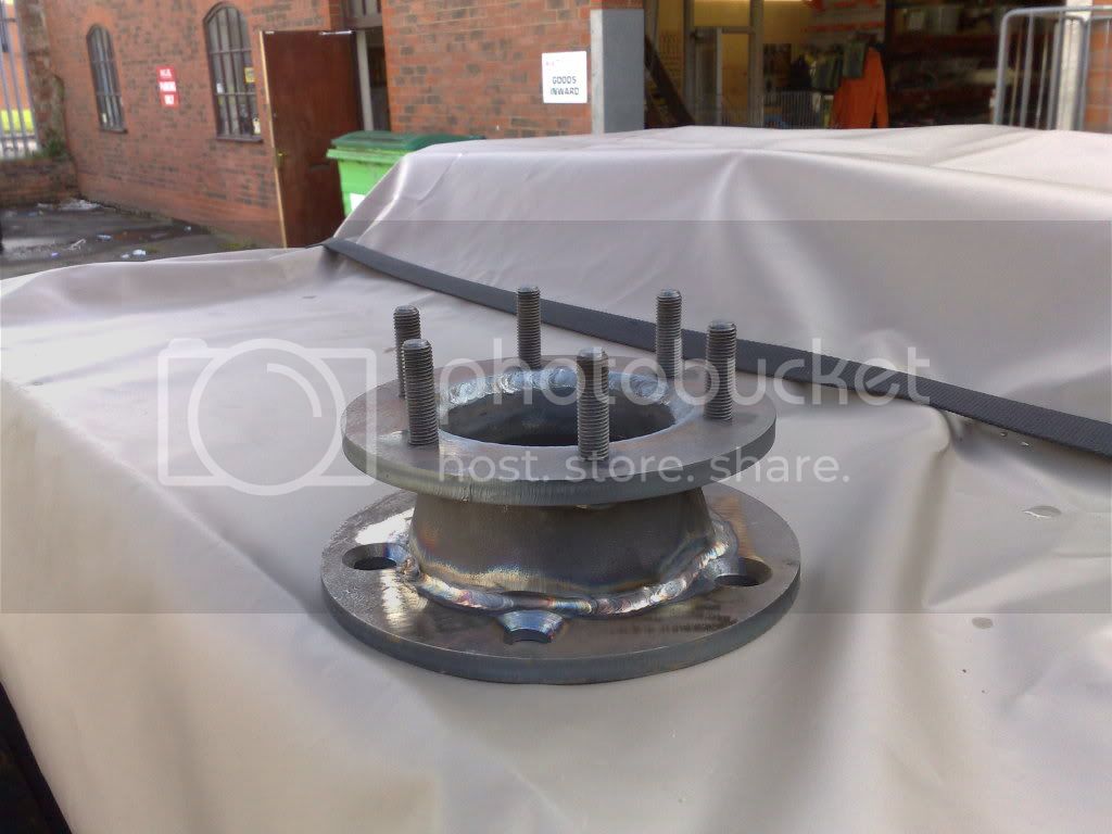

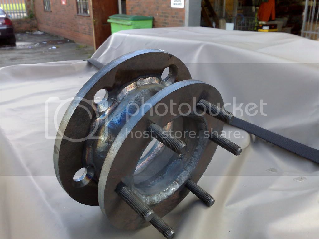

The only mod I've made to date is to make some wheel adapters up to get the 80 series alloys on there. I have access to laser profiling facilities through my work so had a set of matching flanges made up to both sets of wheels
The troublesome part was the dust cap/stub on the Sankey axle being wider than the centre hole in the 'Yota wheel so I bought a couple of pipe reducers/tapers/cones & cut them down to match the two together without interfering with things...
Now whilst I can get metal to stick together with the hot stick, my buddy Col is a time served welder so I let him do it to make sure things wouldn't come to bits on the road
Et voila - wheel adapters!!!
Its good to have a pet welder
Mind you, it all goes on the bill at the end of the day...

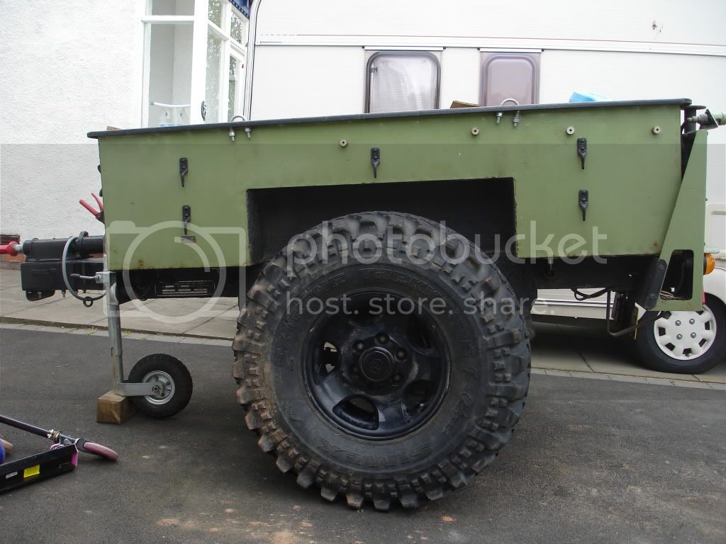

Wheels on, fatboy stylee!!!

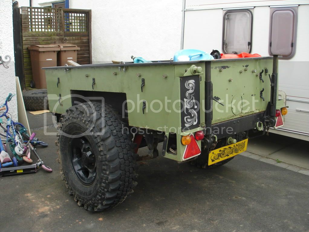

They do stick out a good way now but a nice set of fenders will see to that in the fullness of time. With the wheel sticking out further, I plan to reduce the size of the wheel tubs to improve load carrying space.
I'm having the usual indecision about cutting a door into the back; I think it might be out of necessity as the tin back there is looking a bit corroded.
Pics
The frame:
