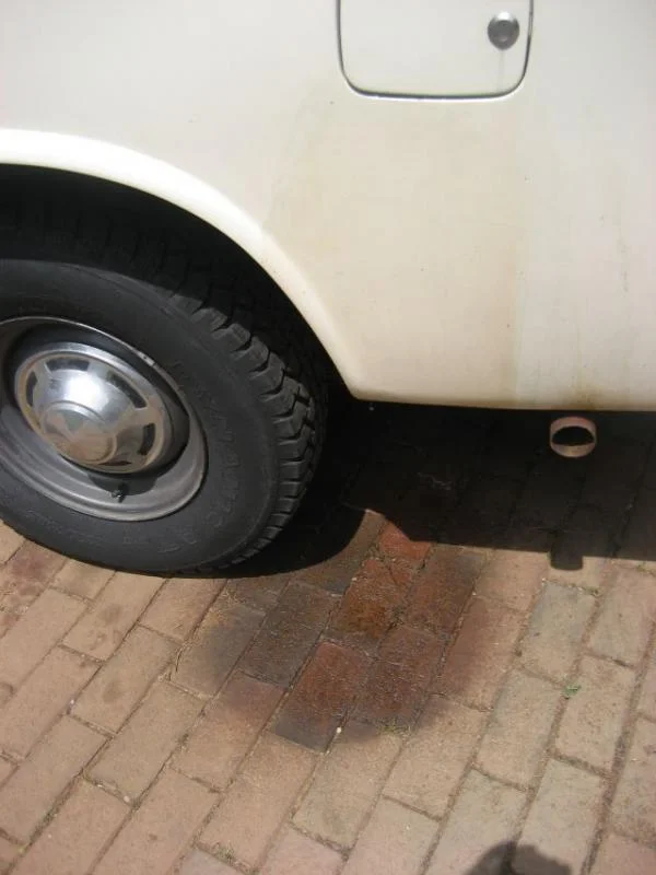

fuel spillage
had the same problem......the PO had plugged all the outlets to the fuel tank except the line to the carb and the filler hose........ during the day fuel and the air above it will expand as things warm up pushing the fuel out the filler neck onto the exhaust :eek:or other openings:hhmm:.........the fj55 fuel tank and its venting is very well thought out........I ended up going back to the original set up except for the charcoal canister which was gone......problem solved :)
Lou

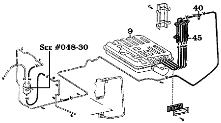

Does anyone have a picture or diagram of how all of those hoses are supposed to go together for the factory venting? I'm pretty sure it is in the driver's side rear quarter panel.
I'm getting leaking too when I first fill up, but it appears to not be coming from the tank but maybe the filler or one of those other hoses in there...

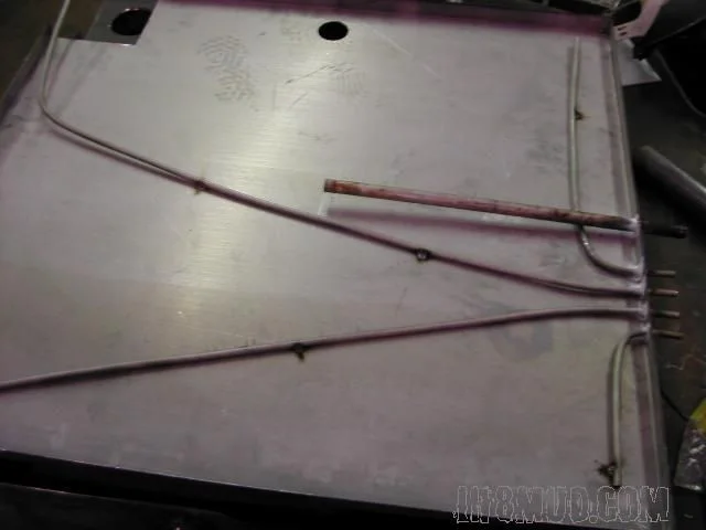

here is a picture of the upper portion of an fj55 fuel tank courtesy of Luke111..the 4 small tubes feed into the air fuel separator and from there to the charcoal canister; the larger one goes to the fuel filler neck so you can see if the air fuel separator is capped off then as the air expands it will push the gas outwards through the filler neck either through the main opening or the overflow; hth
Lou
