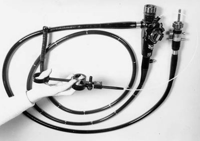

Do you have access to one of these?
It's a colonoscopy camera with a tweezers on the end :D
:hhmm:No, but when I go on my next "getting older" check up, I may ask the doc if I can borrow it for a minute. My buddy and I jokingly spoke of just such a thing on the way home!
