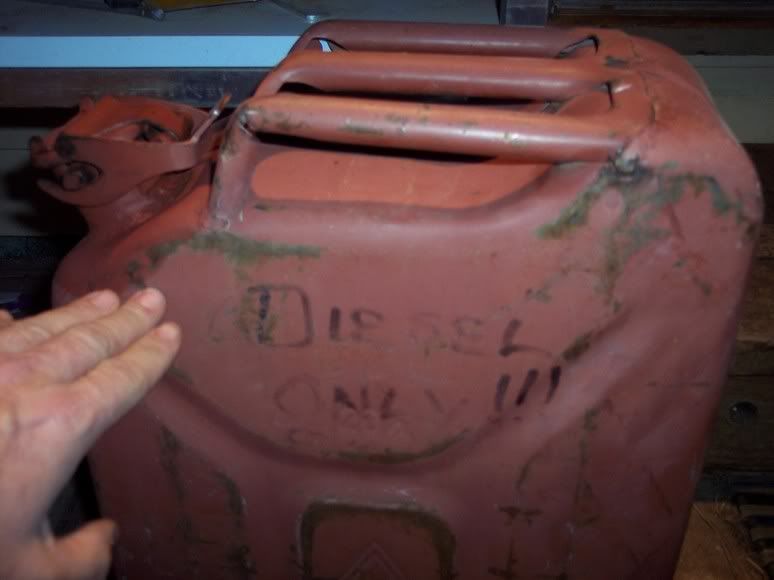

There are currently 2 types of fuel cans that are referred to as NATO cans. The plastic type shown here, made by Scepter, and the metal ones like the one I have pictured. They are both designed to allow for drastic temperature changes if filled properly, to the bottom of the spout, (where my hand is) the rest is for expansion. So if you leave properly filled cans outside you will be fine. Just don't open them rapidly, allow the lid to vent any pressure buildup so you don't get splashed.
