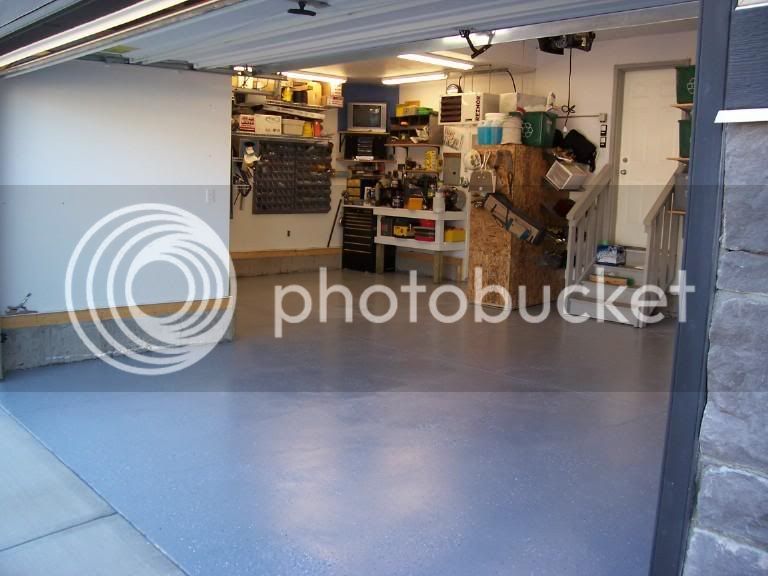

I used the rustoleum from Home Depot and it's been good. No issues with it yet and it makes clean up a breeze. It's a little slippery with snow on it but not brutal. If I did it again I'd add a little sand to the mix. Make sure you spend a bunch of time on the prep and check to see if your concrete is dry enough. You can't seal concrete that isn't completely cured or the coating will come off. ....Steve
How long has it been applied for......weeks,months,years?
I think I put it down in August last year and it's had jackstands thrown across it, every oil a 40 could leak on it and salt etc off the vehicles sitting on it and no problems. It's not exactly a "long term" review but so far, so good. ....Steve
