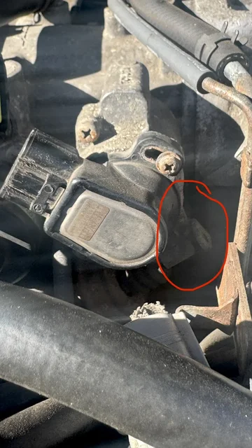

I also noticed this gap at the TPS. The FSM states that this should be under 1mm?

unless some one has played with the TPS dont touch it, its set at factory​
