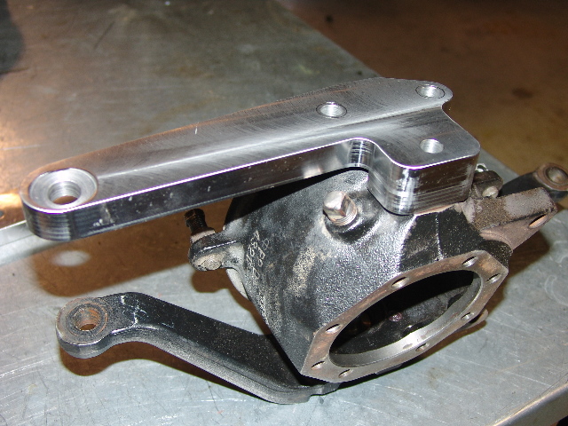

I need Hi-steer on my truck, and from what I can see, no one is really offering it. Therefore, my cad drawings are going to the machine shop in a few days and I'm having some made.

Hmm. I'd definately be interested. What, if any, mods will be needed for the knuckle? I'm using ABS knuckles, it seems that you could make an arm that would utilize the hole for the speed sensors. Good luck with it!
Kinda like these?
work like this.
First batch sold out, waiting for new ones from machine shop.
Can also work like this.
It used a bung that is welded into the ABS sensor hole. The new arms have tapered holes to accept the same studs and cone washers that is used on the bottom. You need a RHD steering arm for the DS to make this work.

Can you use just the PS "hi-steer" arm and retain the tie rod behind the axle?
What did you do with the rear facing tie rod steering arm sections when you put the whole steering up front?
How much rise does this create for the drag link?
Are you selling something to raise the panhard at the axle specifically or relying on folks to fabricate it on their own?
Christo -
Yes, that can be done.
On this truck, we just left them. But you can cut them off if you want.
Never measured it, but probably around 4-5"
We did not really make these for the stock 80 application. Most people that use them swapped 80 axles into buggies or off-road trucks only. So we never addressed the panhard, except on this 100 SAS, where obviously everything was custom. Since you loose ABS with these arms, I did not figure there will be a huge market in the lifted 80 market. That said, if the panhard is raised, the arm could be used to make for better angles on the front.
The picture posted is the 100 with 7.5" of lift and the angles are pretty good.
