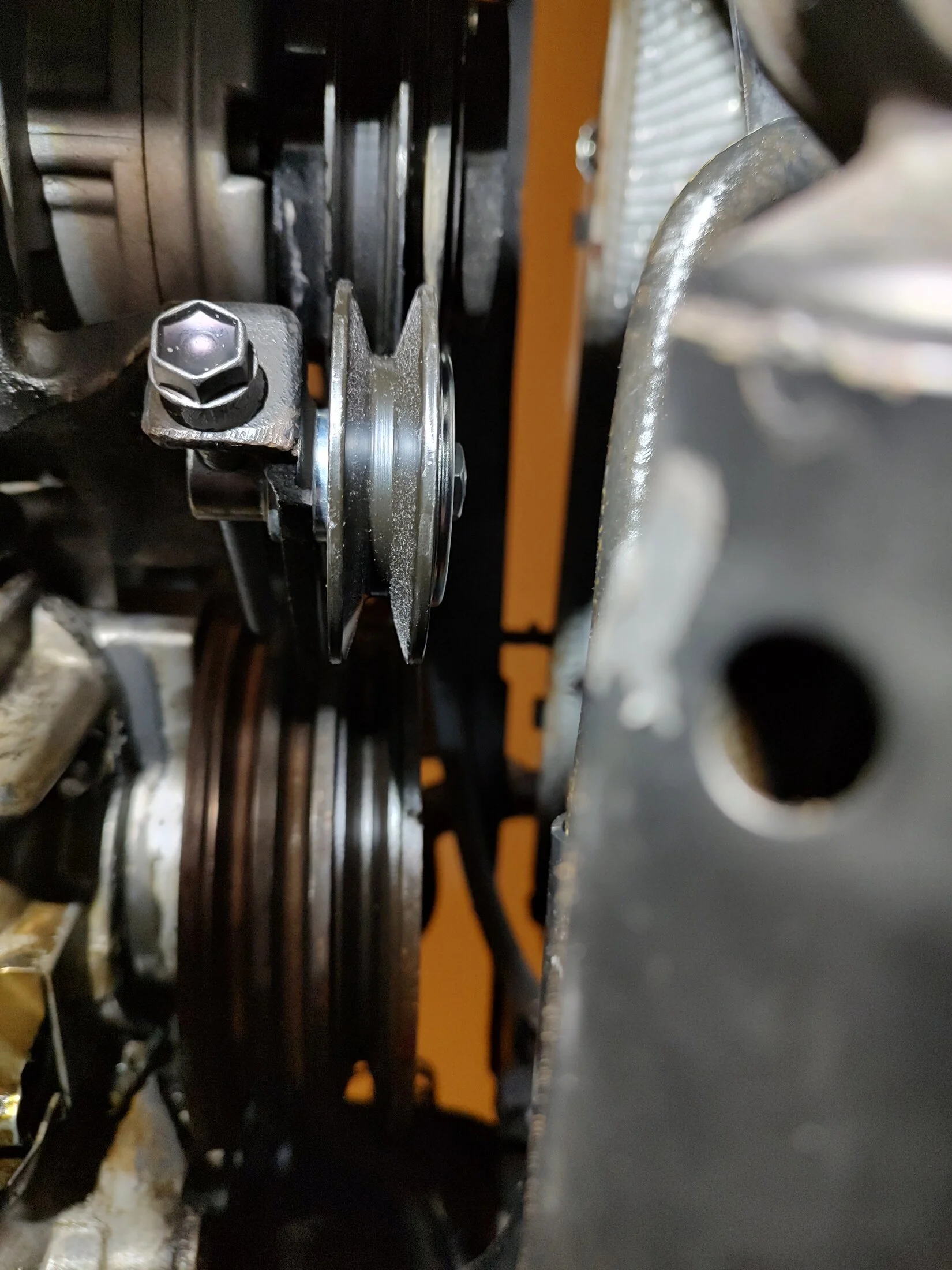

Hey guys,

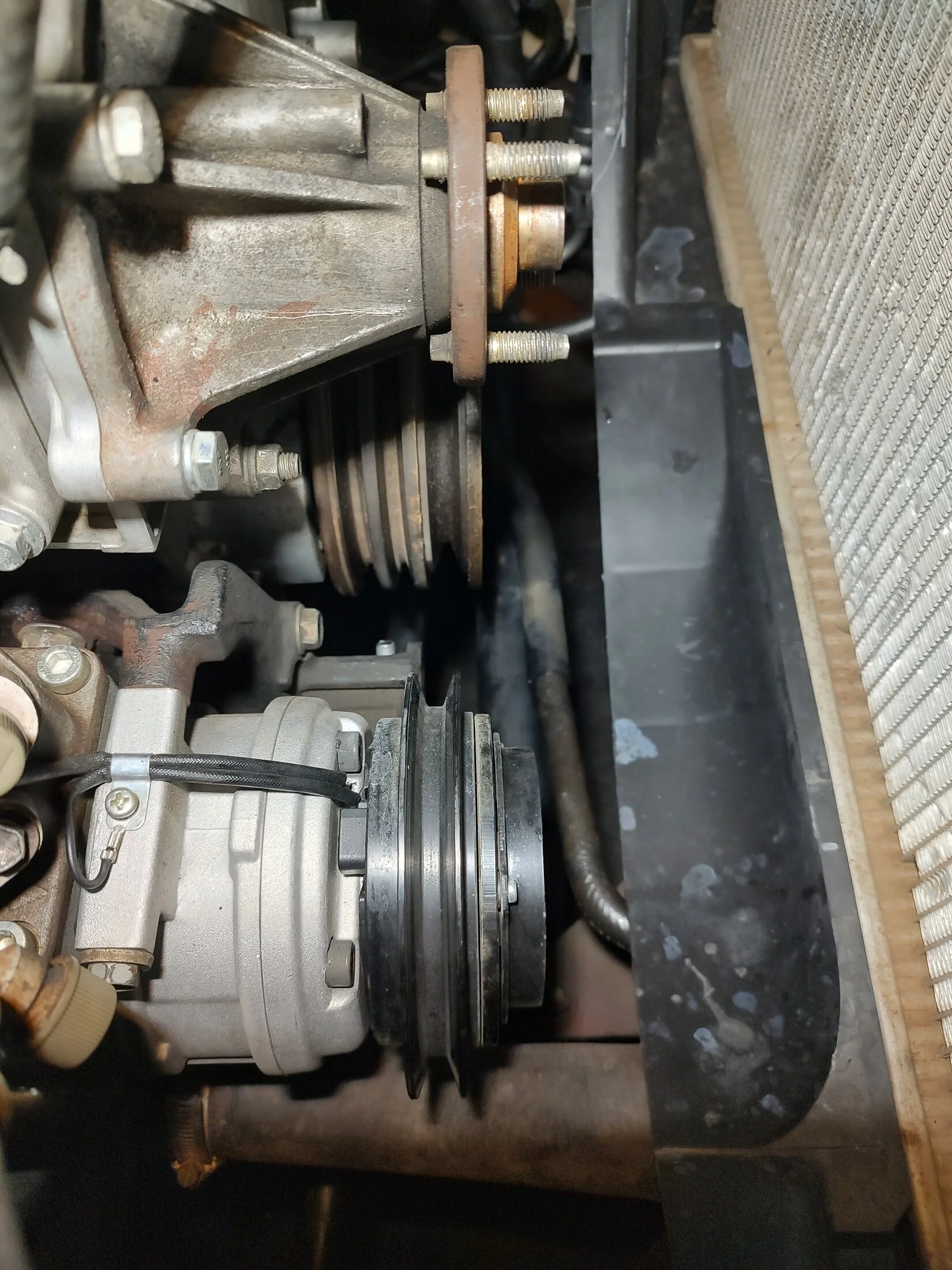

Has anyone had issues with aftermarket A/C compressor pulley alignment? I'm baselining a 96 FZJ80 that I bought a few months ago and when I went to replace the belts, I noticed that the belt for the compressor had been eaten up pretty good. On further inspection, the compressor pulley is recessed about 1/2" as compared to the proper groove in the crank and my new A/C belt tensioner pulley.
I have no real history on the truck but a functioning A/C system with a new compressor was a selling point for me so I'm a bit disappointed at the moment. I can only assume the P.O. purchased a cheap one though, based on his other repair work I've seen so far. Unfortunately, I can't find a part number on the compressor to verify if it's the correct part or not.
Thanks in advance.

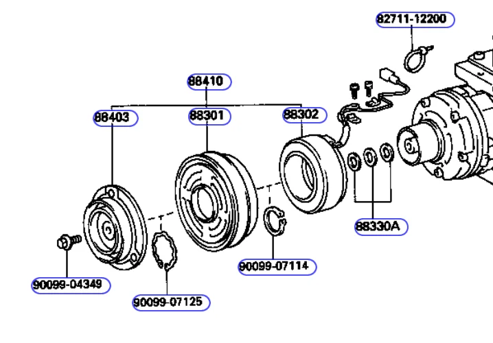

Since you're stuck, if you have the time and interest, you might try fixing it yourself. It already doesn't work, so you really have nothing to lose except your time. And maybe some knuckle skin. The clutch assembly can be removed from the compressor, without purgring the system, which you'll have to do if you replace the compressor, along with the dryer. The process is a small PITA with the radiator in place, but it's much cheaper than the cost of a compressor and dryer, plus purging and recharging the system (you're looking a a minimum of $500 there, and that's a good price).
The disassembly procedure is in the service manual.
The snap ring keeps the clutch in place, and the wavy ring retains the pulley. If you can find some spacers that will move the pulley far enough forward, and have someone cut the pulley bushing down for you, you might be able to get it to work. From the picture it looks like you're within 1/16"; I'd take careful measurements before I broke it down. This sounds like a lot, but I promise you it's cheaper than the alternative.

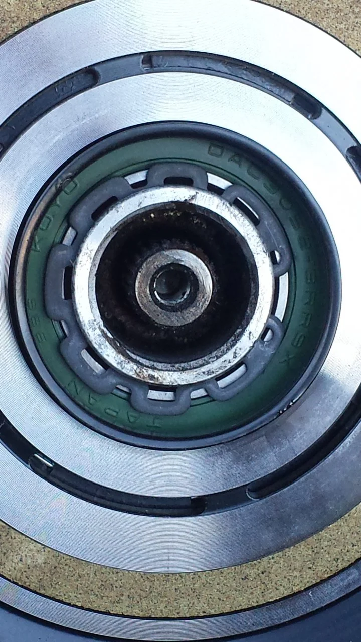

Thank you for all of the technical advice! As you said, I don't have much to lose by trying to fix the current compressor so I may very well go that route if there is a way. To clarify, would the spacer need to be between the electromagnet and the pulley? If this is the case, would there be any decrease in the magnet's ability to pull the front clutch drive plate into the pulley given the added distance? I'm assuming the needed machining of the pulley bushing (bearing?) would be on the front side so that the wavy snap ring can still seat in the groove on the compressor snout with the new spacers behind the pulley? I guess I'm having a hard time understanding that part because the pulley rides on a bearing and I'm not sure how one could do any machining to the bearing itself, especially because the wavy snap ring appears to be larger in diameter than the race portion of that bearing. (Photo attached) I'm a complete novice when it comes to A/C components and will happily accept any education you have to offer!

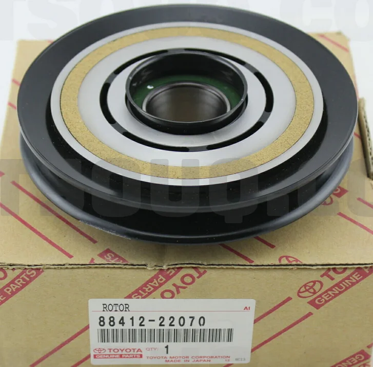

I do wonder if the discrepancy could also be the result of the pulley design itself. It seems theoretically possible that the machining on the compressor snout is fine and that the pulley casting is a little off. What do you think? I'd be tempted to try measuring the distance between the face of the pulley and the belt groove and compare to someone's Denso or OEM version. If it's as simple as that, I could just replace it with the 88412-22070 shown above.
The pulley on the compressors can be removed and swapped around.
My first 80 needed a new compressor, I bought a lot of three NOS Denso compressors off ebay gambling that at least one would work.
I had one with the correct body, but wrong pulley offset, and another had the correct pulley offset, wrong body.
Mixed and matched to make one work.

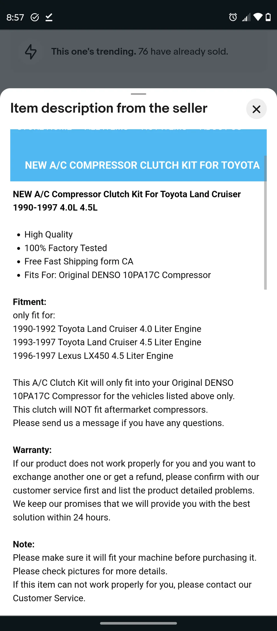

Thanks, that's a good point. A used OEM is probably a good idea even if it's just for reference. Interestingly, an eBay ad I found for an aftermarket clutch kit (not one that I would buy though) states explicitly that it only fits OEM Denso compressors and not aftermarket. Makes me wonder what the potential difference in the pump body/machining itself is.
